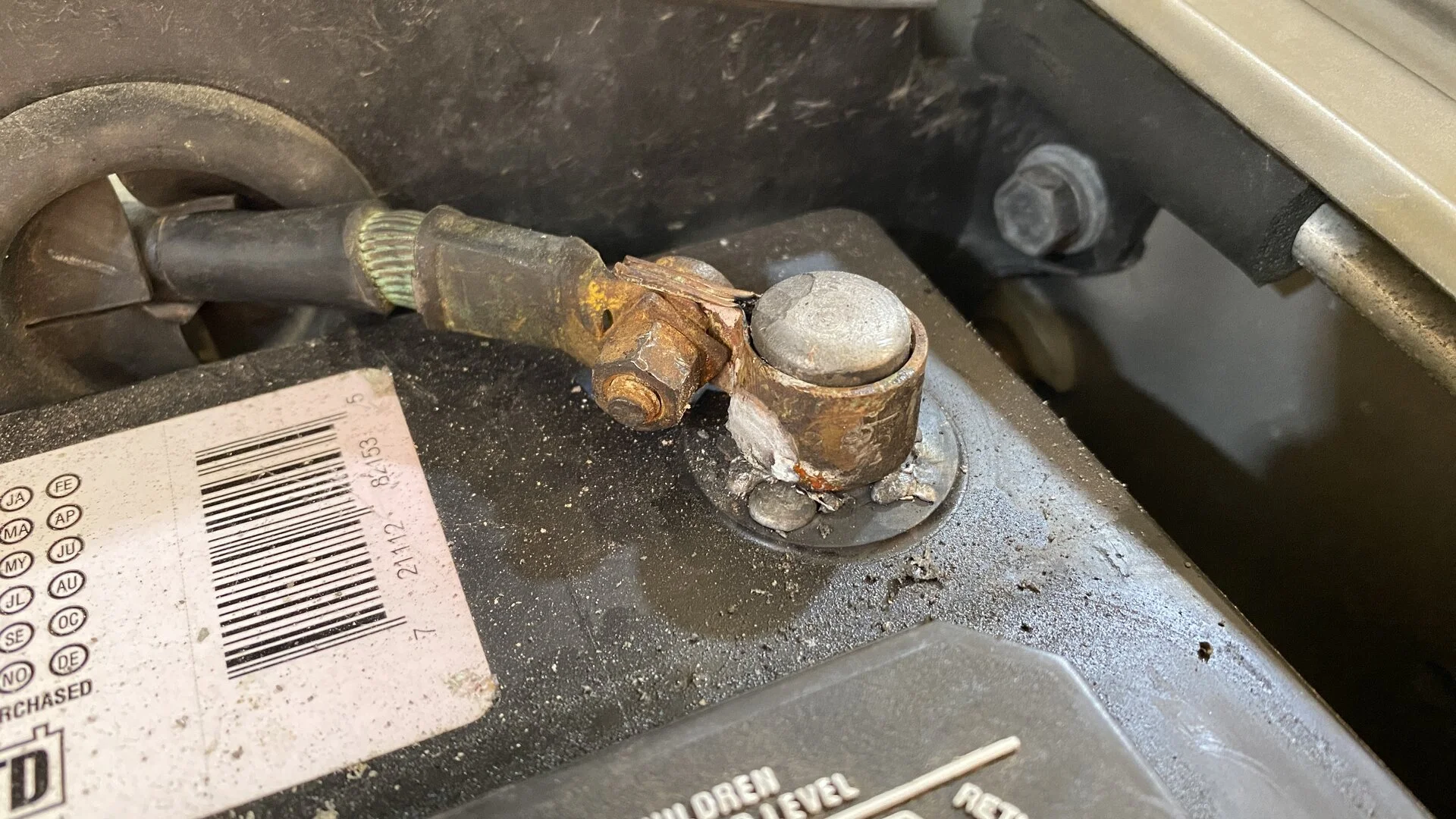

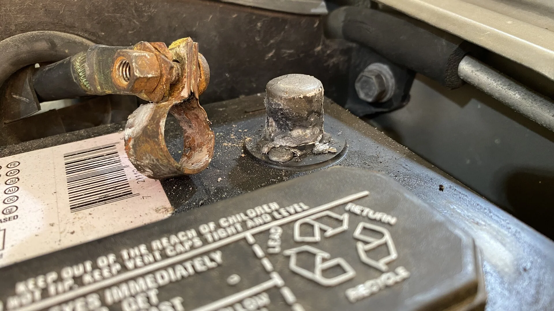

Bumping an old thread -
'97 HDJ81 - OEM dual battery setup, 1HDFT. Went to disconnect the batteries to do some work today and noticed that my secondary battery (left hand side) negative battery terminal is melting. I had made a note a while ago to replace the terminal clamps, as you can see it's super thin and janky. I knew it was bad but wow. Thoughts? The truck is running fine otherwise - I wonder if it's because of the terminal clamp.

Crusty, corroded terminal clamps will cause poor connections, which will arc, get hot, and melt the terminals under high load conditions. Replace the terminal clamps, possibly the battery if it is too far gone, then put some corrosion protection on the new ones.
