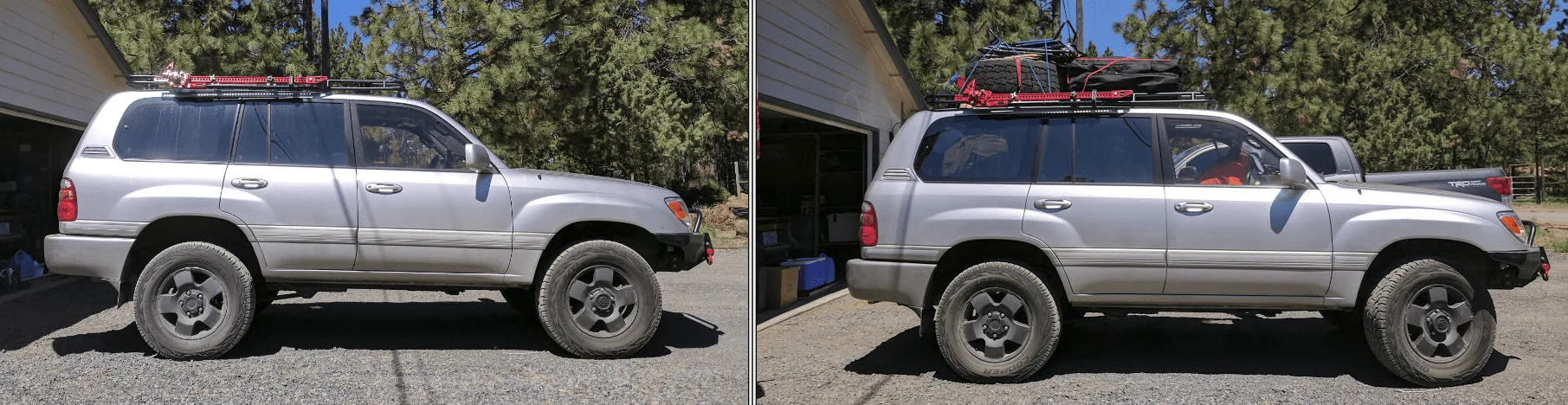

Personally running a ToughDog setup from @reevesci, medium constant rate springs were claimed to be 30mm lift but either I don't have enough weight in there (around 250lbs in the drawers and contents, + something for the gamiviti & hilift) or my old ones were more worn that I thought because I had a solid 2-2.5" lift after install. Currently about a 2" rake when empty, but level when a family of four is loaded for a 3 day camping trip in the desert:
Not a huge visual difference in the pics I know, but easier to see in person, and it was a 2" drop, I measured it and gave my family some grief;)

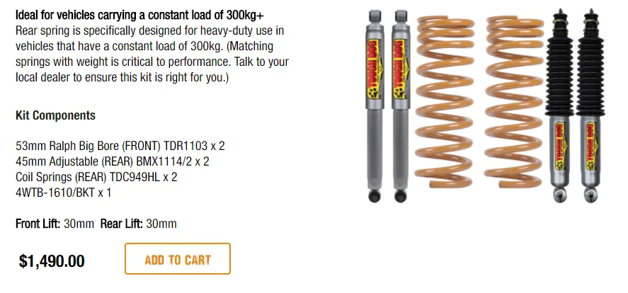

Here is what I have:
Constant rear springs = a 30mm lift (above factory height) at 660-1100#of load. Will be TALLER if not loaded to the lower minimum range at ALL TIMES, hence what constant means.
