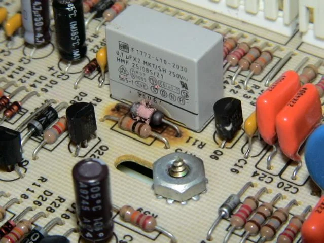

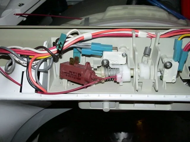

The other problem area is caused by a faulty "wax motor" (actually a switch) that when it shorts out fries two components of the main control board, a R11 resistor and something called a Q6 Triac(transistor). When that happens the tub will not spin after a rinse cycle leaving the clothes full of water and the door will not lock. In some early models there were three of these wax motors, two controlled the water flow during various cycles.

Top photo shows the burned R11 resistor and to it's right the Q6 Triac. Middle photo shows the wax motor with a brown stem, the new ones have a black stem; if you have an old motor and it hasn't burned out yet you should replace it immediately before it fries your control board. Bottom photo shows the gear puller used to get the inner tub drive wheel off it's spindle.

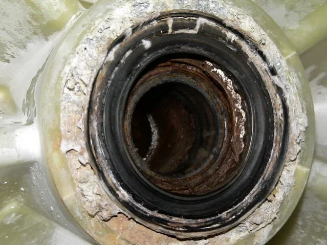

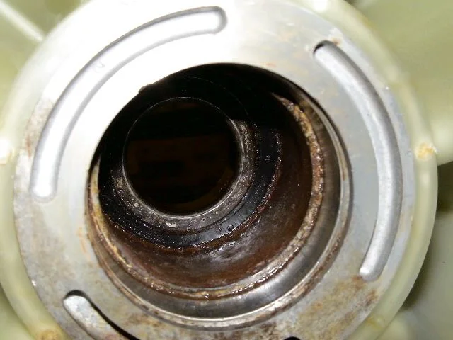

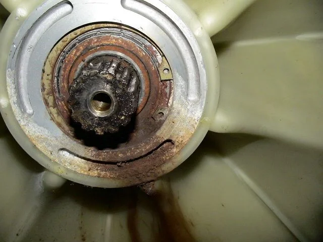

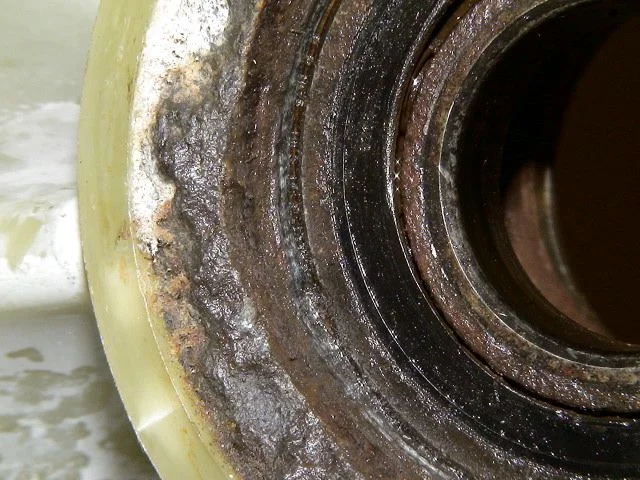

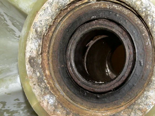

Here's what the bearings looked like at first glance. Once I got the inner tub/spinner spindle and rear bearing out I found a handful of rusty grit and muck inside the hub assembly. Top photo is rear bearing and inner tub spindle. Middle photo shows the front bearing and seal. Bottom is the front bearing after removing the seal and cleaning it up. Rust is holding that bearing in, it wouldn't budge after trying a couple different penetrating oils and a large pilot bearing puller, and no go with hammer and drift from behind. Next I'll try to remove more of the rust that appears to be holding the bearing in, may have to cut it out.

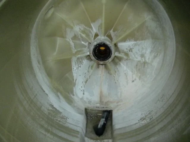

A wide shot of the inner tub and front bearing, not a lot of room to work, a close up of the front bearing showing the rust, and last the rear bearing removed looking at the backside of the front bearing. There was a spacer located inbetween the two bearings (not shown in these photos), I'm not sure what it's purpose is, as the two bearings butt up against a lip and can't be driven in beyond that. It appears that the spacer would just rattle around the spindle. I'll add more photos later.

They don't replace the bearings, they want to sell you a new tub with the bearings already installed for about $500, not counting labor. The whole job if done by a repairman would be around $1000 including the control board, which is the cost of new machine. I'm mailing the main control board to a guy who has repaired a few thousand, it will only cost about $40 to have a new improved R11 resistor and Q6 Triac installed along with a few more improved/higher voltage parts on the board. I'm also replacing all three wax motors ($36), one locks the door the other two control water flow. I picked up NSK 6206 and 6207 double sealed bearings from Motion Industries, much better than what was originally used ($50), and a seal kit, ($40) with an improved seal. So when it's all done $170 in parts for the repair. I could have saved $30-40 if I had picked up cheapo Chinese bearings but I don't plan on doing this again for a long time. I'll also be adding a dedicated industrial strength surge protector for the washer and dryer as apparently the electronics of these boards can get fried too easily by power spikes.
