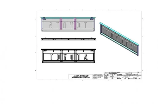

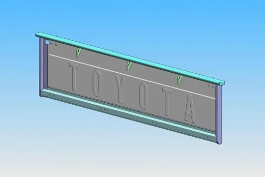

Yeah, I'm working on the tailgate assembly. I've got the Solidworks model nearly done. I've made all of these parts before but I want to add some details that will allow me to assemble them easier. Still need to make the tools for the embossed letters and add the oval sticker emboss.
