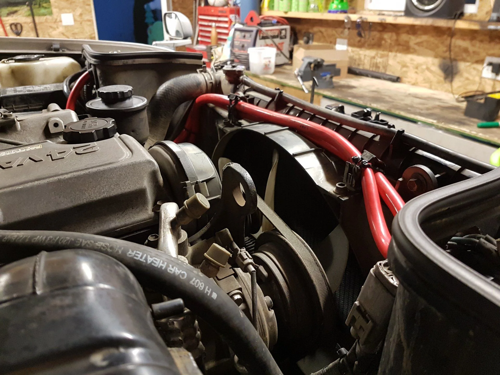

That poor angle shows some new 1/0 copper wiring: alternator to battery1, battery1 to relay, battery2 to relay, relay - to block, battery 2- to block.
Didn't solve a damn thing.
But, they are in there now and nothing wrong with that.
My dumb lazy ass still hasn't borrowed a DC clamp so i don't know if things are pulling current or something else is up. The alt just barely puts out a voltage above the resting volts of the batteries, then it warms up and seems happy. Maybe takes 30 seconds to a minute. Very slight, almost imperceptible waver of the voltmeter in the truck when blinkers are on, etc, otherwise all seems fine.
Le sigh...

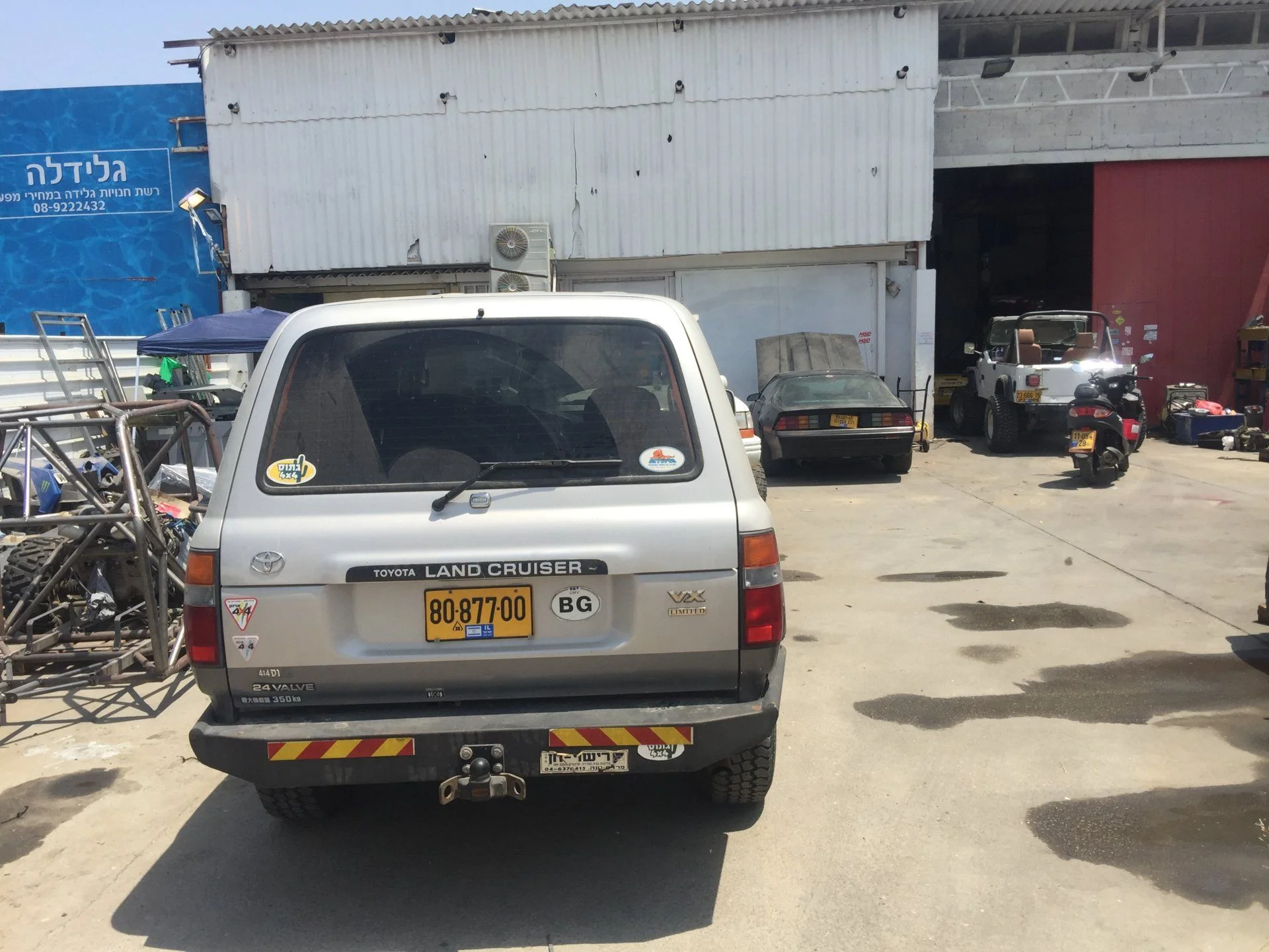

this is JDM so the wheel is RHD? the wipers are for RHD did the Japanese dealer converted it from RHD to LHD?
it looks like main FZJ80 including the weight sticker on the tail
it looks like main FZJ80 including the weight sticker on the tail View attachment 1502158 View attachment 1502159 View attachment 1502160
Yes, this is a full RHD JDM spec vehicle. I saw your post trying to wrap your head around what exactly your one-of-a-kind lhd/rhd hybrid is. If you notice, your Japanese weight rating label on the tailgate is still on your drivers side, so maybe it was LHD in Japan too?
My baby was borne like this. I have contacted TOYOTA EU with Vin# and all details
It was manufactured in Japan(main plant) for the European market
I didnt want to post this in my original conspiracy post not to offend any Guru
can You post a pic of your cockpit ??
PS there is a possibility that I will get from Toyota A Recall on O2 sensors from 1995 LOL

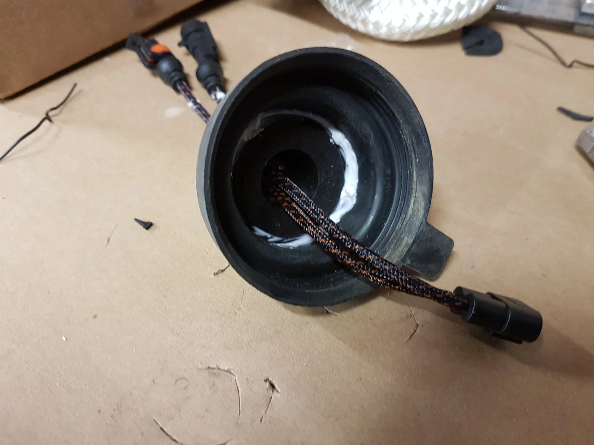

Set of Morimoto H1 HIDs. I went with the 35w ballast and 4500k lamps for low beam duty. Install in the Sonar projector housings went smoothly. I used a gob of silicone in the boots to help seal up between the old larger boots and the new smaller ones. I had one headlight out as well, so this was very exciting to put in. Build quality of all the parts from Morimoto are top notch.
I'm incredibly happy with the performance while driving, and will be ordering another set with the 55w ballast for my high beams eventually. They take about 20 seconds to warm up, and go from bluish, to perfect white. The cut off could be better, what with that glare spot in the middle, but i knew they wouldn't be perfect (see the projector modifications I needed to do for north America usage in page 1).

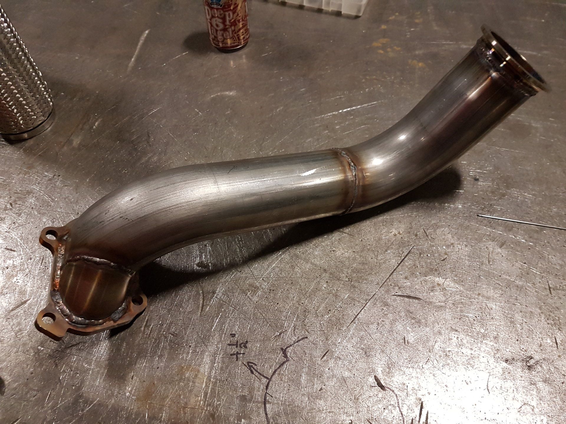

Started quite a while ago by making new stainless flanges for the turbo dump pipe. I took the existing cast dump off, traced out the shape of it into AutoCAD, and got them laser cut. Did the same for my cousin's 1KTZE Surf at the same time. In the future, will NOT go the laser cut route, as cutting 3/8" thick stainless via laser goes through a CRAPLOAD of nitrogen, so buddy had to charge me like $50 each. Waterjet would have probably been cheaper in this case. Anyway, I got my cousin to use the flange to create a new dump pipe because he's the experienced fabricator, and could TIG it together properly. Went the straight down and back route as recommended by @mudgudgeon .
I repurposed the old factory bracket to give extra support from the transmission and put the flex adapter beside the driveshaft. The futzed bracket is making contact with the old heatshield, so I'll have to bend that a wee bit. The photo doesn't look like it, but the pipe sits high enough above the driveshaft that there's a ton of space, the 4" lift on the truck helps with that I think. And yeah, we just put the pipe into the flex at a slight angle to save the effort of making another pie cut, there isn't any strain on the flex in that position. A little kick back past the transfer case to the tiny little Magnaflow muffler and that's where we left off for now. It's sitting within probably 1/8" from the slider mounting plate, but doesn't make contact at all. That's a 3/8" stainless all-thread put into a rod hanger so a nylock nut can easily be put on the other side to hold it in place without removing hangars.
That was already a 8 hour day, but the dump pipe is at least done, which took most of that time on it's own. I can muck around in the evenings and slowly get the rest over the axle in place and tacked with the MIG (with SS wire) for him to finish later. Plan is to basically follow the stock route from here and dump out the right side behind the rear wheel.
It's driveable for the moment if needed. I wouldn't go on any long trips though. Sounds better so far, very low, no rattle of the pipe touching anything. It drones a bit on the highway, but I'm hoping finishing the pipe to the back will help with that. The turbo whistle is much more noticeable now. It also make a bit of extra noise when the engine is pulling at like 3000rpm, somewhat different from the whistle. I THINK it's just air in the new downpipe, but who knows? Only shows up at high revs. Maybe it's just a change in tone of the whistle as air is pushed faster? I'll keep an ear on it and try to figure that out, or post a video with the sound recorded and see what the hivemind comes up with.

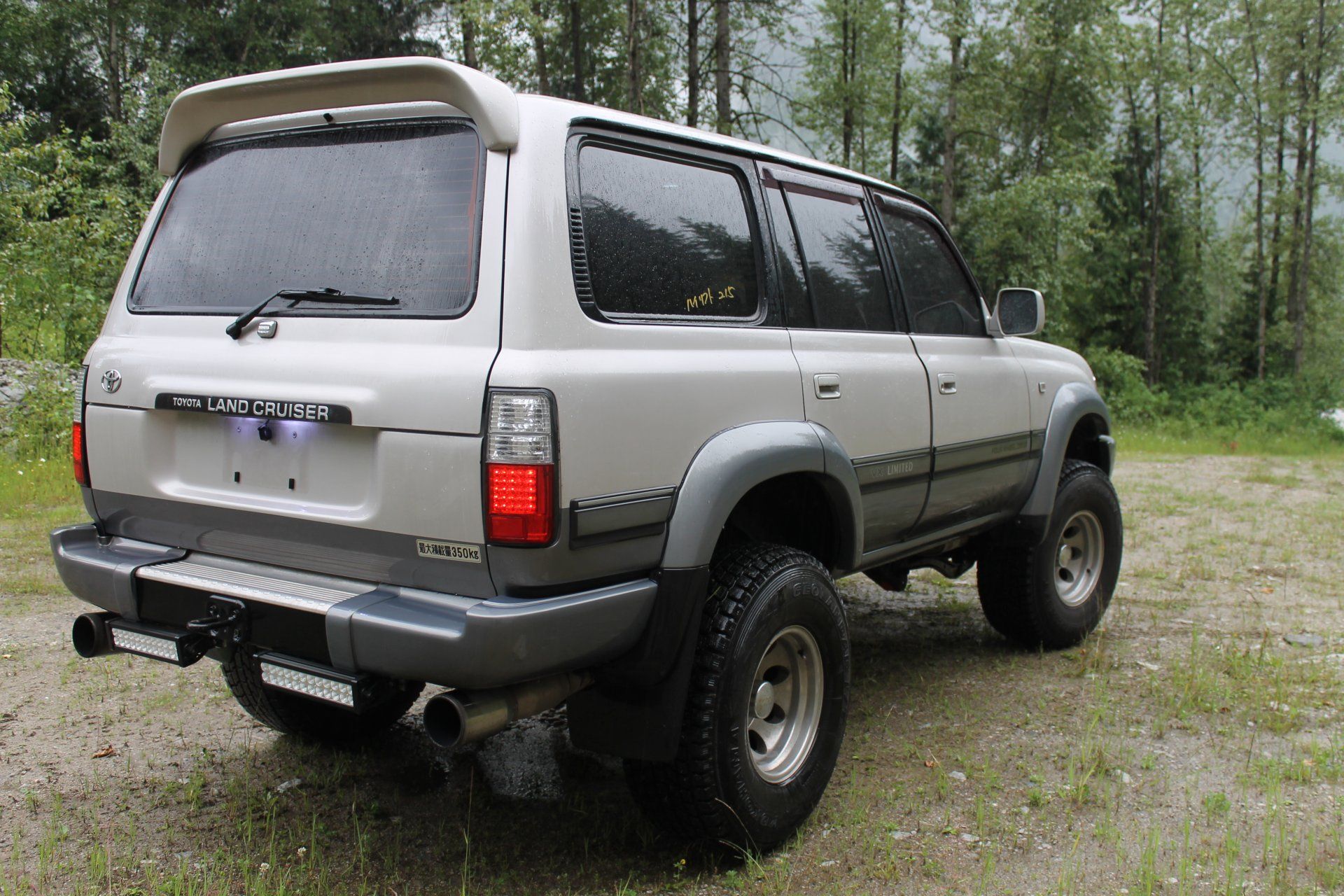

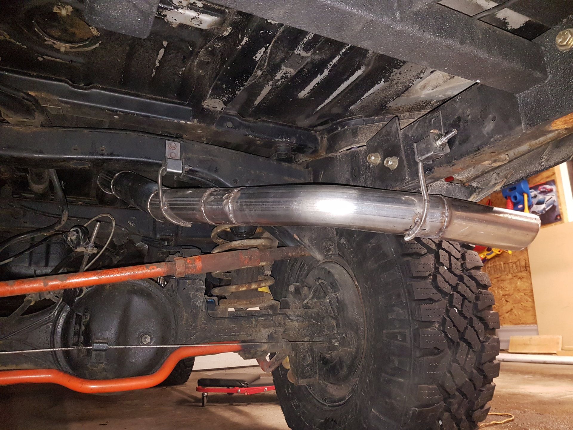

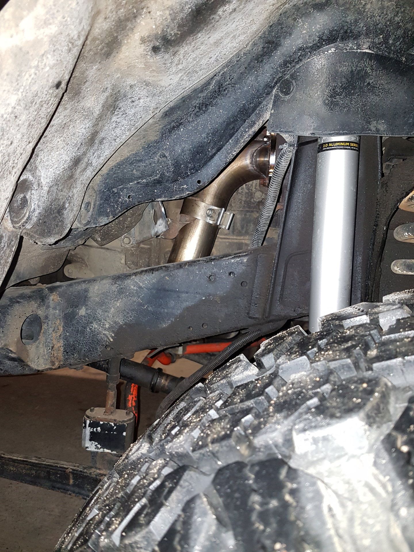

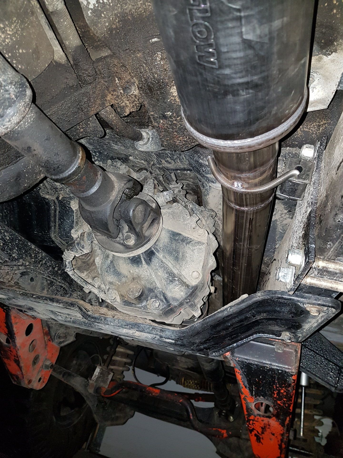

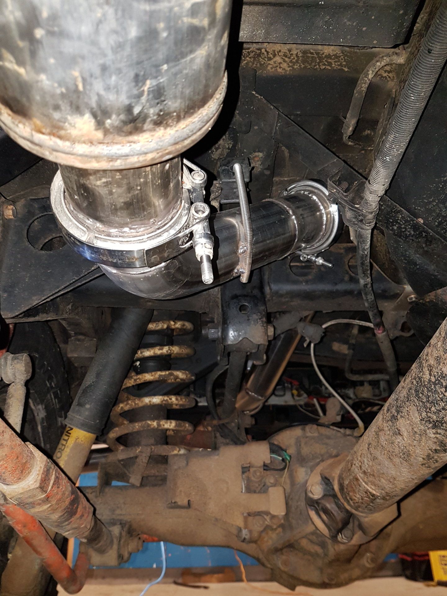

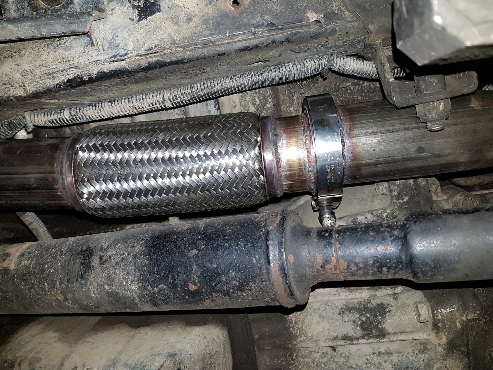

Finally got around to finishing the exhaust. I was going to get my cousin to tig it, but due to work being crazy, I decided to just finish it up with the mig and my sub par skills. Used stainless wire, but the normal 75/25 mix gas. If it only lasts 10 years... :meh:
Also repaired and rerouted my transmission temp wire. Dumb ass.
It's solid, no rattles at all, sounds much better with the rear half while driving. Turbo whistle is great. There's a bit of a ricey pop at high rpm, but I'll live.
Geeze, the flash on my phone sure makes the dirty front side of my axle look like a rusted POS.
full
full
full
How much fun was the section over the diff to the rear?
At least you didn't have to get past a sub tank.
Oh yeah, it was great fun. Probably sunk about 4 hours into just getting over that cross member. Absolutely vital tool for it though, was a long angle finder. Only had to trim cuts once or twice.
I guess this crushes my hopes of installing a factory sub in the future.

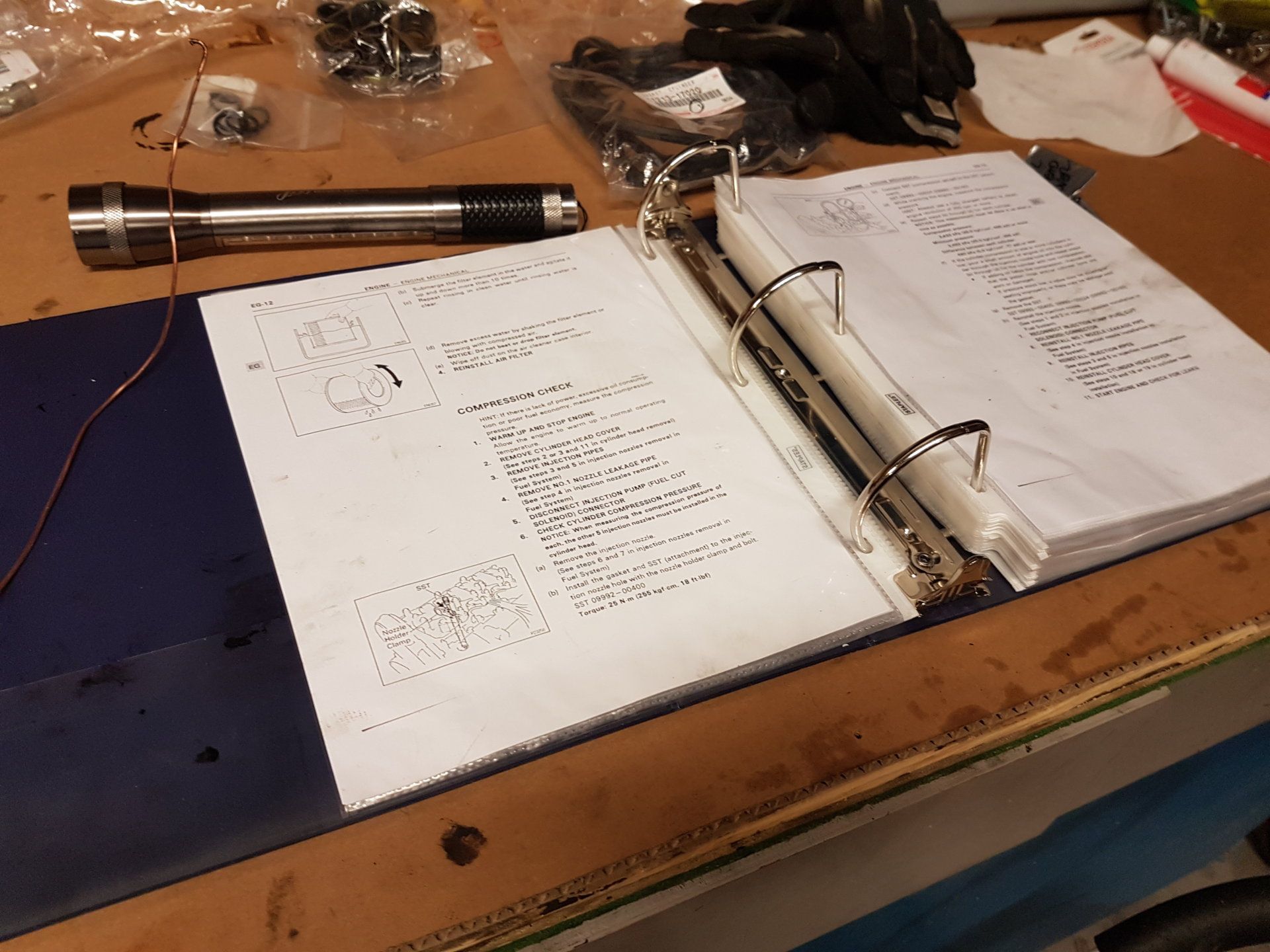

When you buy a used vehicle, it seems like everyone asks "did you check compression?" This being bought off the internet from another country, I did not. So, here is my attempt.
I printed off a large portion of the HDFT engine FSM, put the pages in plastic sleeves for reference and started following instructions. Since there are no glow plugs on the hdft, you have to pull the valve cover and use the injector holes.

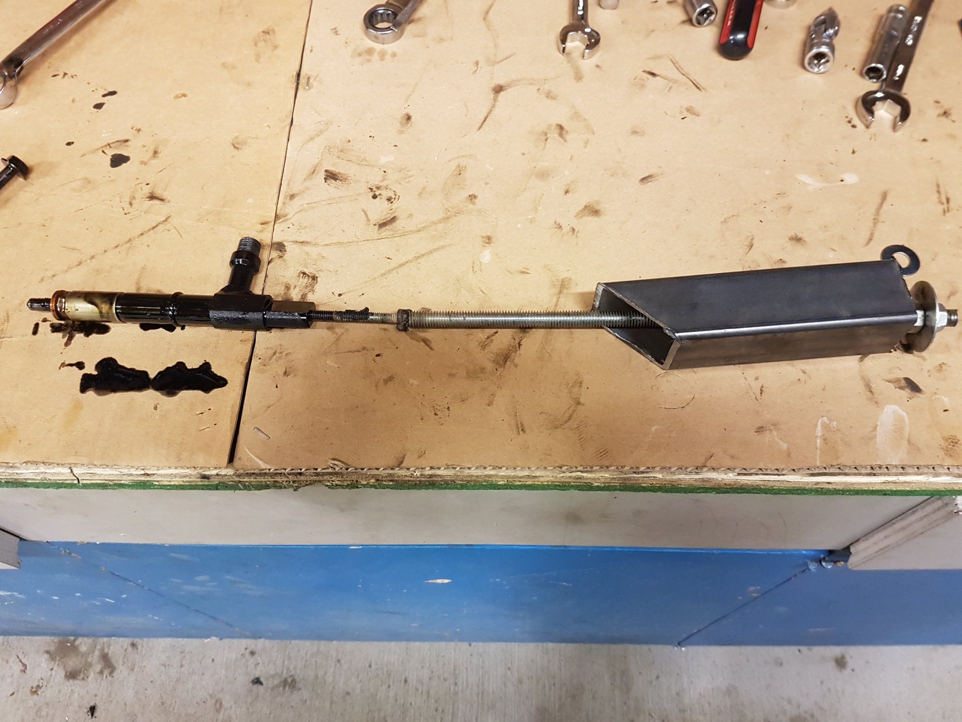

So, I pulled all the injectors to have a look. I built a little slide hammer to yank them out of a small leftover bolt from something on the truck welded to a piece of all thread and scrap steel. When doing this, pay attention to the little cup washers that are on the bolt that holds the injector holder down. I dropped two of them and couldn't find them, worried like crazy that they fell down into the sump, but they were thankfully found hiding in the oil in one of the little recesses.
full
Only one of the copper washers decided to stay behind in the hole. Just guess which one.
full
Thankfully it was turned sideways so a piece of wire with a little hook on the end worked nicely. Would have been easier if it wasn't #6.

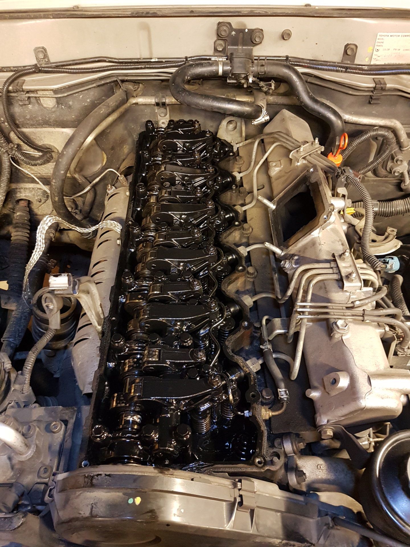

With compression testing out of the question, I'm going to check/adjust the valve clearances tonight, maybe pull the intake manifold for cleaning. Try to get injectors tested and cleaned tomorrow too.
I also have the SST for checking timing on the way in the mail, so between this, that, the exhaust and a fresh oil and fuel filter change, I can start tuning the pump later.
