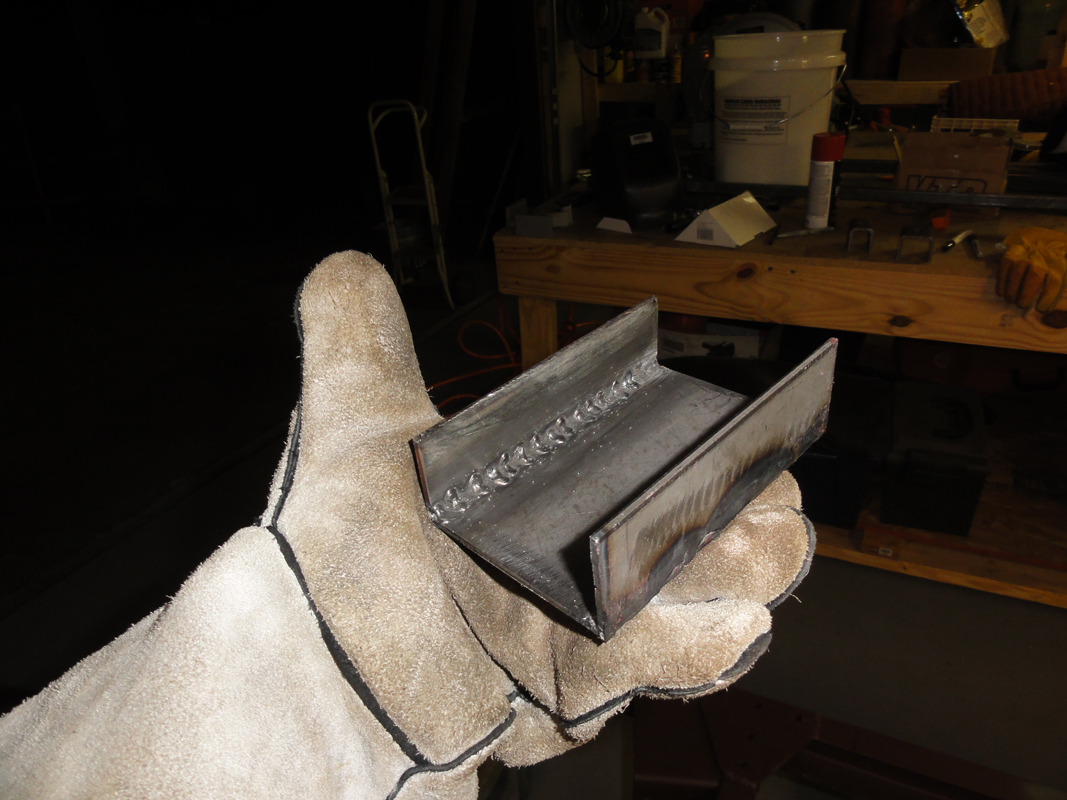

Well finally got the trailer back from blast and prime and started on the fab. The axel springs I ordered are a bit shorter so I'm making some box in members to add to the frame for strength... so far I got one welded up and in, doesn't look to bad for my first week of welding.
