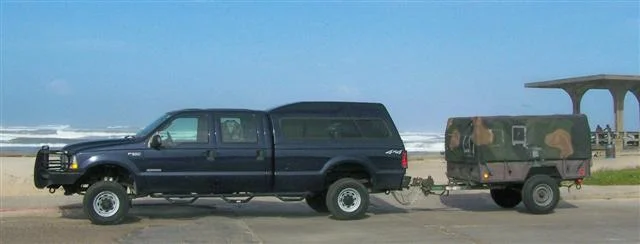

This is a US 101 behind a F350. It works perfect behind this truck. Roughly same width, tracks tight.
You shouldn't have a problem, the size seems fine. At 1340lb / 600kg they are fairly heavy for a trailer though. I can't imagine you having any issues towing it.
