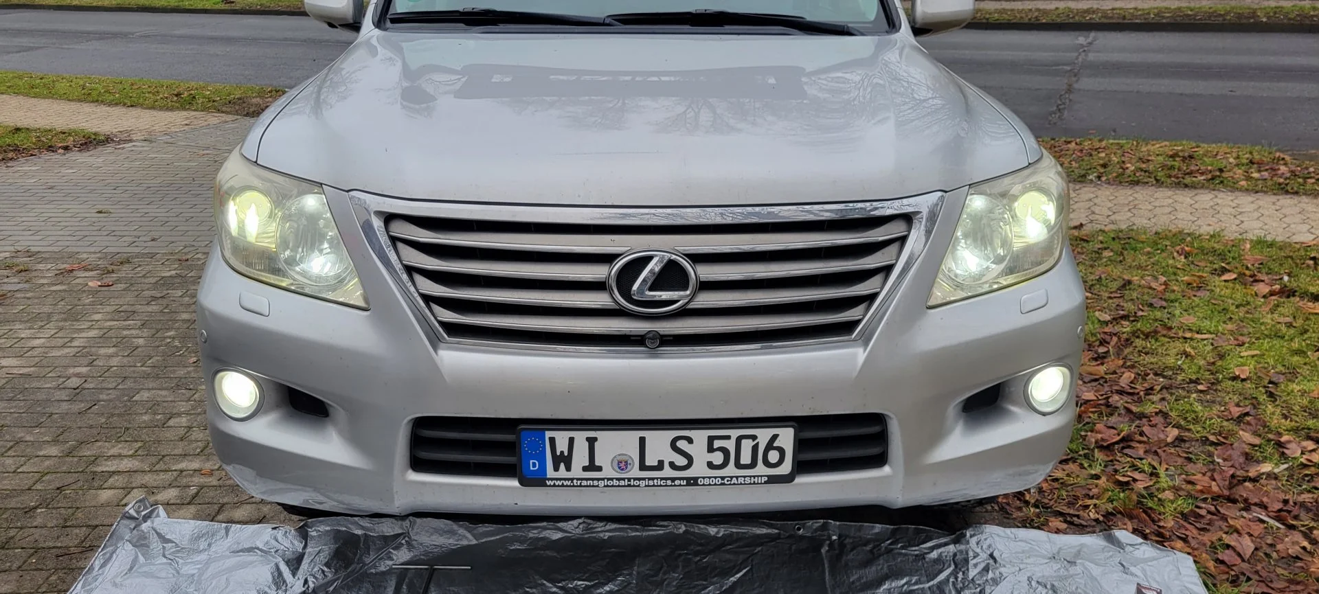

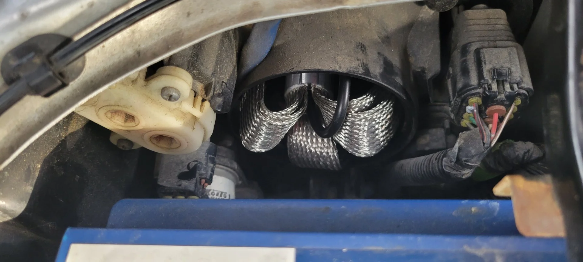

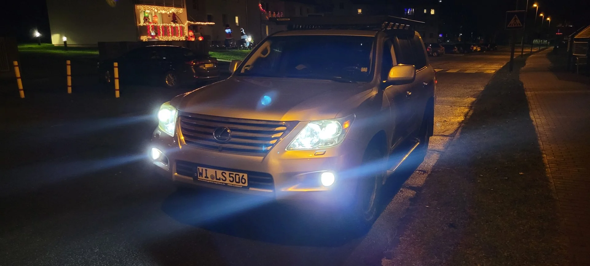

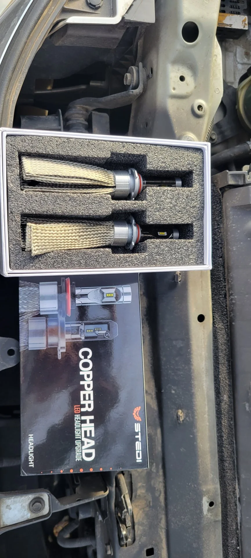

Hey Team,
Just thought I would share my feedback on the Stedi H11, HB3, fogs, and running light LED conversion that I did. I've read a few different LED conversion threads on here and ultimately left confused. I'd ordered a set of Stedi H11's for my wife's Sienna a while back and was very pleased so I figured I'd give them a shot on the LX. If you go to their site, they have all of the bulbs to do a complete swap up front so I just went ahead and ordered it all. The high beams are NOT able to multi-function as the DRL's like the stock bulbs, but otherwise, no issues with AHS or the end caps and they are plug and play. Let me know if you have any questions.

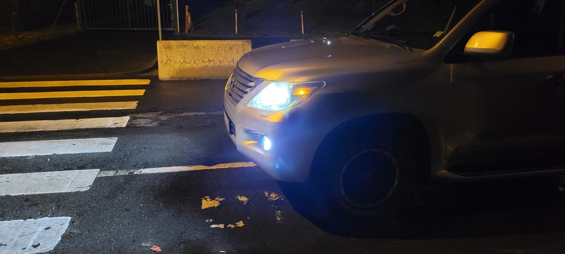

Sure. This is with only one of the bulbs changed but you get the idea.

So I don't want to spread bad data, I will take another picture tomorrow with the lights in Auto as it's well after dark here. The second picture is of the DRL bulb/marking light, not the high beam at low brightness. I believe it is the marking light bulb that acts as the DRL for the LX's and not the high beam, but I could absolutely be incorrect about this and will do my best to clarify tomorrow.

Ok, so I stand corrected, the high beams are not able to function as the DRL's. I put the switch on Auto and nothing from the high beams. I corrected my original post, my apologies for the initial misinformation.

So just an update, my AHS light did come on tonight. I pulled the caps off, let AHS reset, then turned off AHS and put the OE caps back on. The larger caps are $15 so I'll just order a set and turn AHS back on after they arrive.
I think these lights are great, much brighter and effective than the factory bulbs. My favorite part has to be that they are all the same temperature at 5000k. It gives the lights a very factory look. I previously felt the need to eventually upgrade to the 13-15 headlights but I don't think that's necessary anymore.
Hey @outlaw4shrt I jsut bought a pair of H11 from stedi, but they seem to be too long for the low beam housing. The LED light goes and hits the glass and i am not able to lock it in place :(
did you face any issues as such ? it doesnt look like the led bulb has changed / been updated by Stedi
