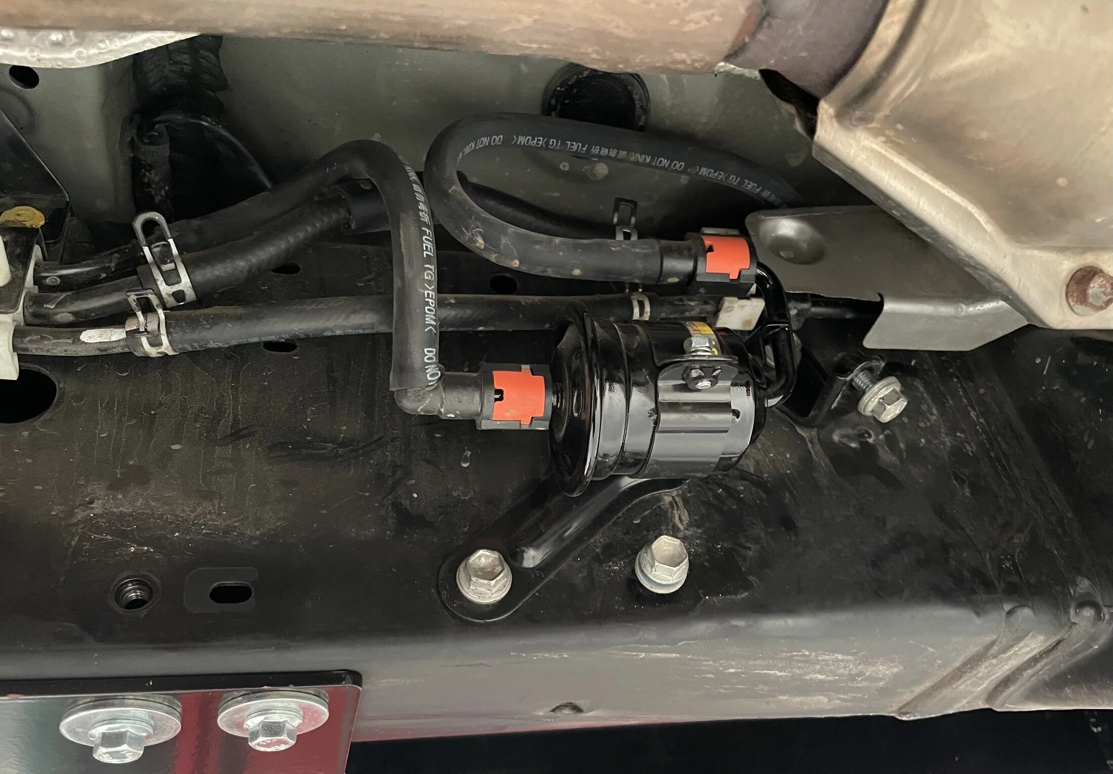

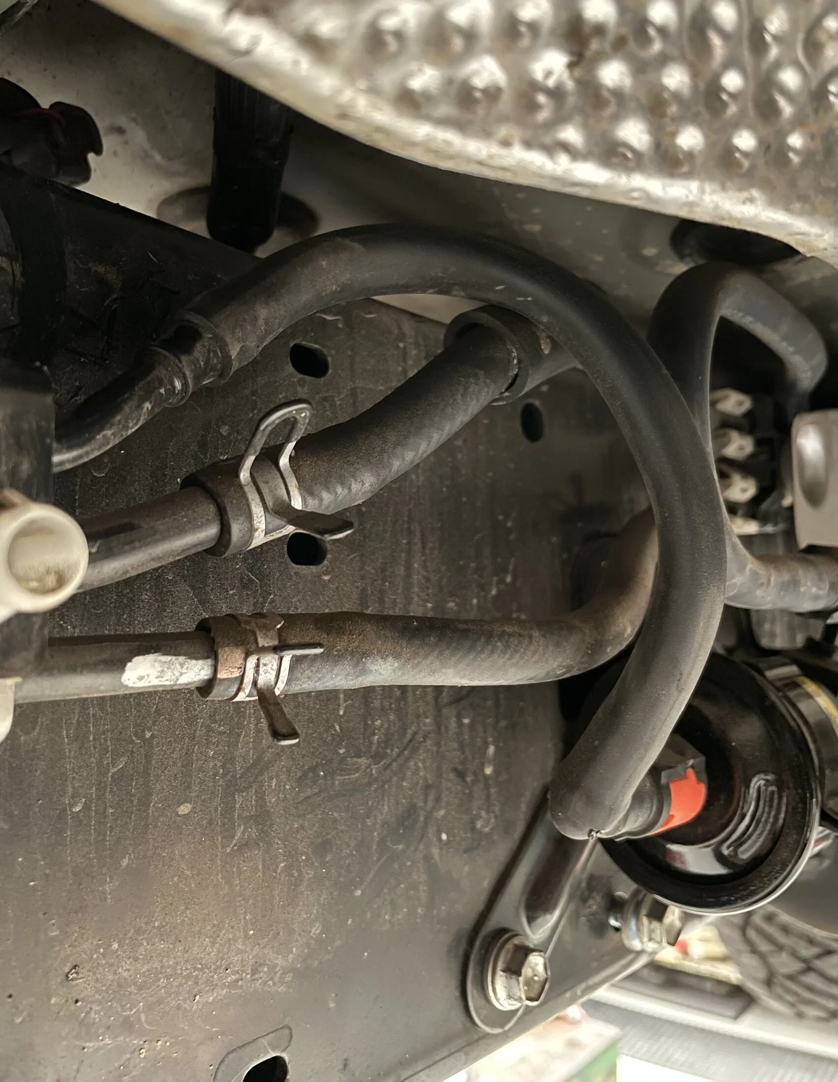

Hi,
Here’s a couple of pics. I fear the retro fit might be more involved as Bloc suggested, unless you could fit appropriate hose connections to the steel line if you cut and/or flare it. I was not familiar with the OE joining method shown where the rubber meets the steel, this was the same both sides (the engine side was hidden by the silver heat shielding). It appears to be Push-Lok style barbed fittings without clamps.
Incidentally, although the filter itself is just the round canister, the OE replacement comes with chassis bracket assembled.
Greg.

Thanks for posting these.. yes they appear to be push-lok or maybe some kind of molded line. Maybe even crimped.
It also strikes me as a really small filter for the size of engine and fuel demands. Just to be clear.. this is for a 5.7L 3UR-FE?

Yep, URJ201R, 5.7L 3UR-FE.
