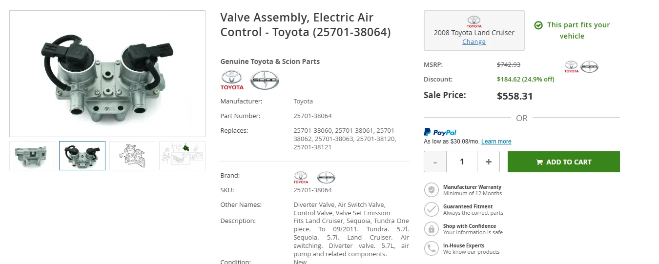

My 2010 Lx570 with 190k miles threw code p2440 today and went into limp mode. Code is for secondary air injection switching valve stuck open bank 1. I cleared it and it drives fine but I read that it needs 2 cold starts to re trigger. I was looking at doing the gen 2 bypass kit from Hewitt trying to decide if I want to change both pressure sensors that they offer. I spoke to Hewitt and he feels that my pressure sensors are probably ok but I'm looking to keep this truck around for several more years. Looking for advice or input on the bypass kit. Thanks.

Anyone have an update on this? I just got the same P2440 code. Seems like this is the part you have to replace? Is that right?

I installed the Hewitt Technologies bypass kit shortly after I made this first post. Been fine ever since and passes motor vehicle inspection

ah nice, that is what im thinking about doing too, now that I read some other threads.
