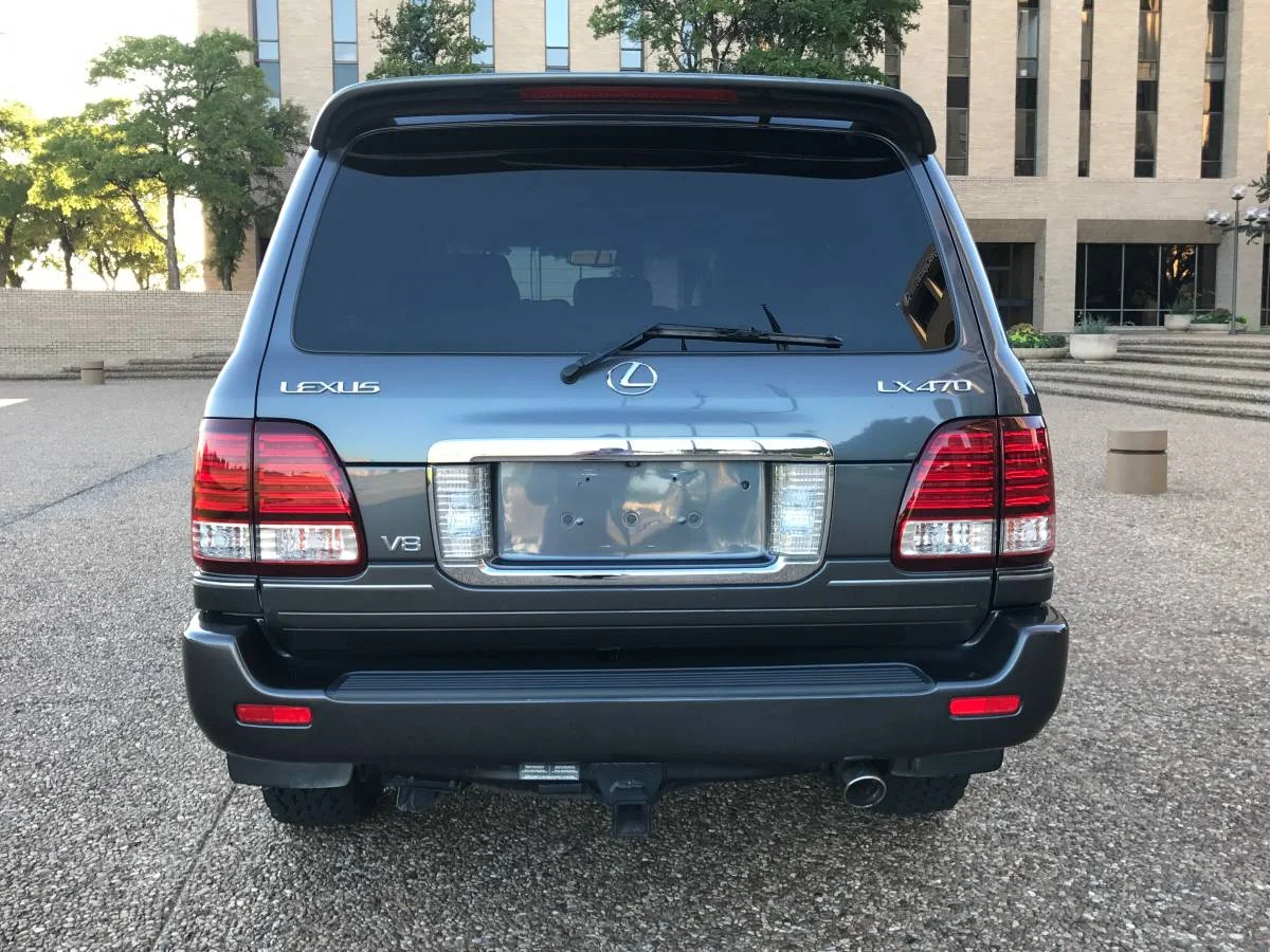

I have serious doubts that an LX tailgate is swapable with the LC tailgate. The lights are ever so slightly shaped different. I mean, the tailgate itself should mechanically work fine. But, you'd have a hard time finding matching lights. Your outboard lights would be different than the inboard and might look funny.
Take a look at the attached images and take note of the tail lights. The hatch/tailgate interface sure looks the same. But, the lower area of the lights is definitely differently shaped.
