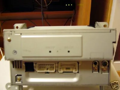

Here are picks of the unit. Looks like it could be the same as LC, any ideas folks?

1) I don't know about Mark Levinson levels. Maybe there is a site for posting the amp's specs, but I would be surprised if the unit did not accept the preamp outputs of a different HU. Also shop for a HU that has programmable preouts to the amp if you are not sure. I can see your radio has standard Toyota wiring harness connectors.
2) The double DIN hole in the 2001 will accept anybody's double DIN unit. Show us another picture of the side of your radio. You will probably have to unscrew the mounting tabs/ears that are on the sides of your existing radio, and screw them onto the new radio. That's 6 or 8 screws. A half- :banana: job. I don't know about 1 or 1.5DIN units in the 2DIN socket.

I recommend you do not cut any connectors! That should not be necessary. Just make sure you buy a wiring harness to help convert from the Toyota dash harness connector to the connectors/harness that will come with the new radio/HU's.

Thanks - THAT IS THE REPLY I WAS LOOKING FOR! The photos are actually courtesy of E-Bay - I did not actually remove the radio to take the shots.
It makes sense the connectors are the same - I think I will go to a very similary setup to yours (if not the same). My only concern is that my wife will find the setup usable. How does your wife find using the Pioneer aftermarket? The buttons seem large(close to OEM), etc.
