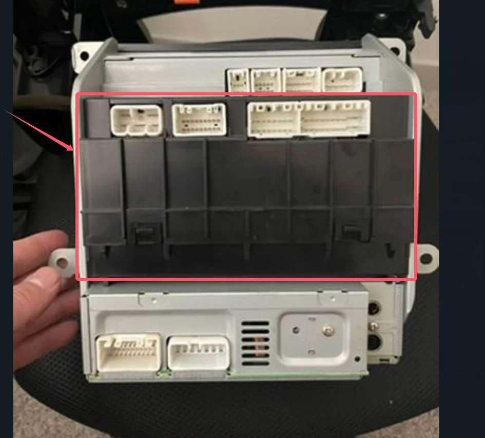

2. Retain the AC control separately by removing it from the prior head unit.
My head unit looked like this attached.
Steps
1. Open things up
2. Remove ML head unit
3. Remove black part highlighted above

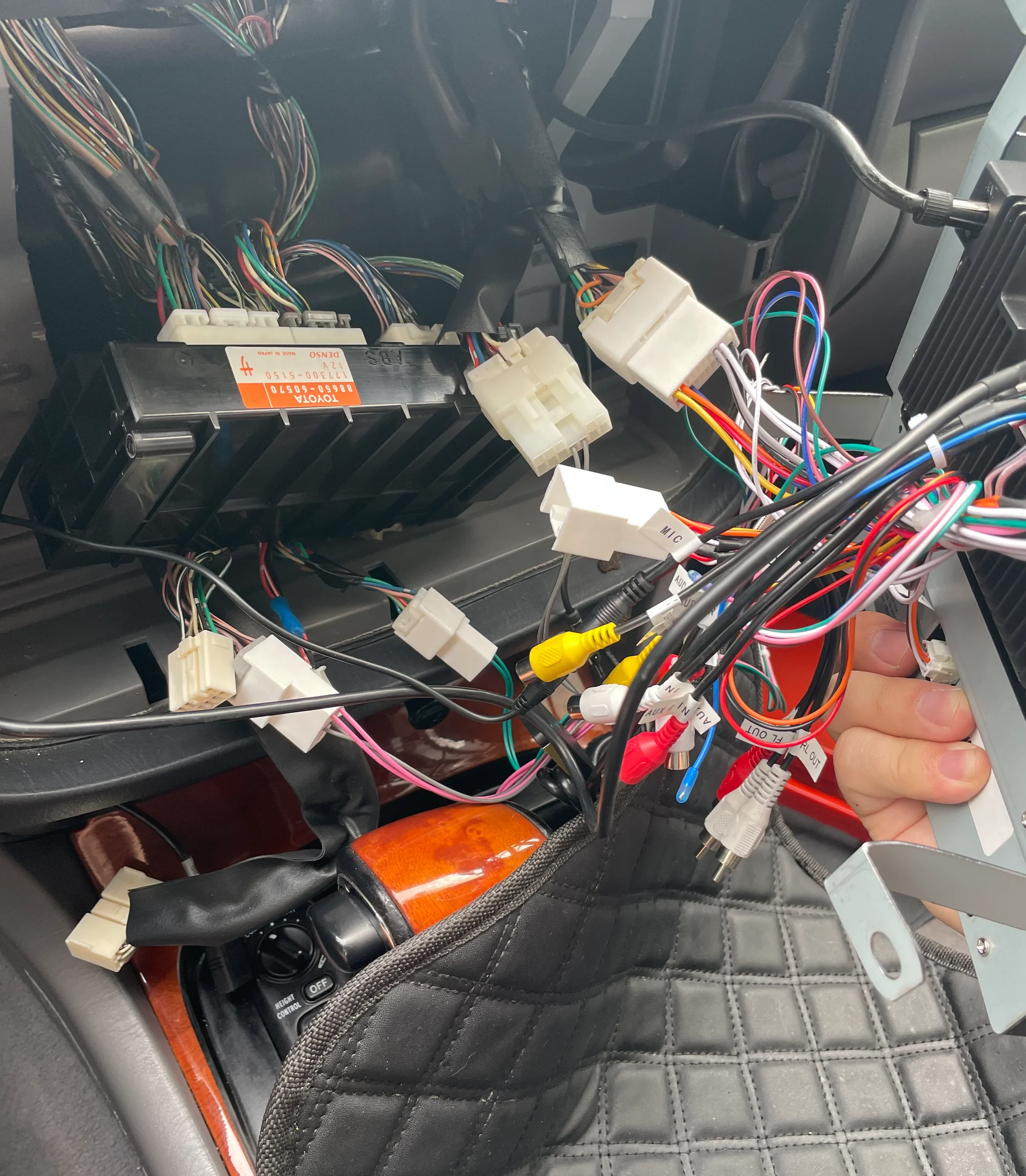

4. Reconnect black climate control
5. Connect using harness provide

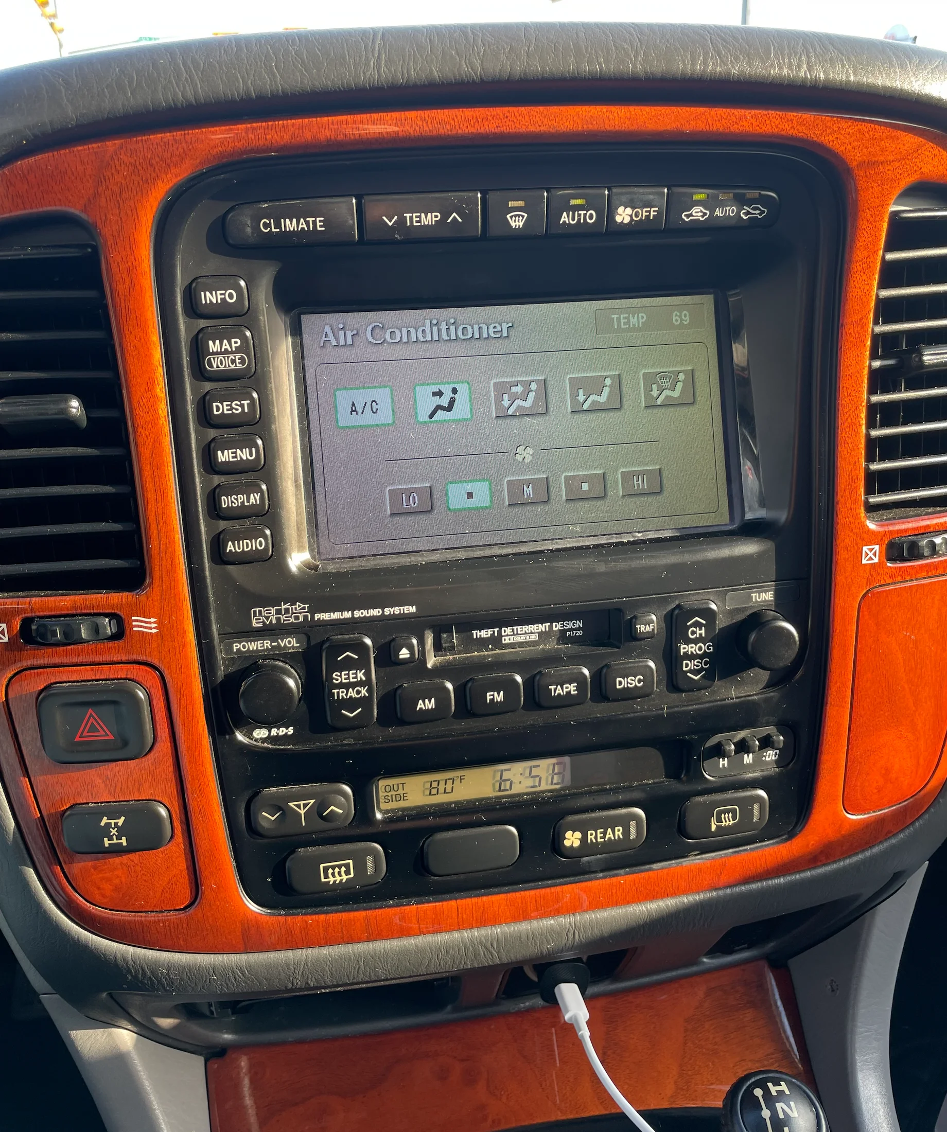

6. Fire up car and ensure things work.
7. Carefully put things back together.

First impressions
1. Audio is solid
2. Carplay works well but weird to get into
3. Its Android so nothing is logical to me
4. Phone calls seems subpar. Folks report I sound like I'm in a tunnel. Might try a different mic
5. You cannot be on your home wifi and carplay at the same time
6. Climate control offers settings that aren't available in this car and you lose the auto recycle mode
