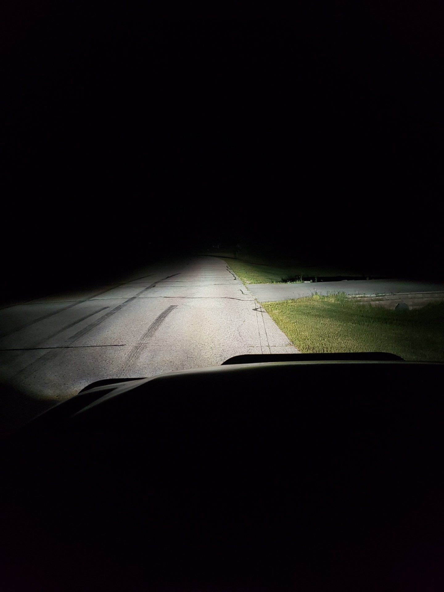

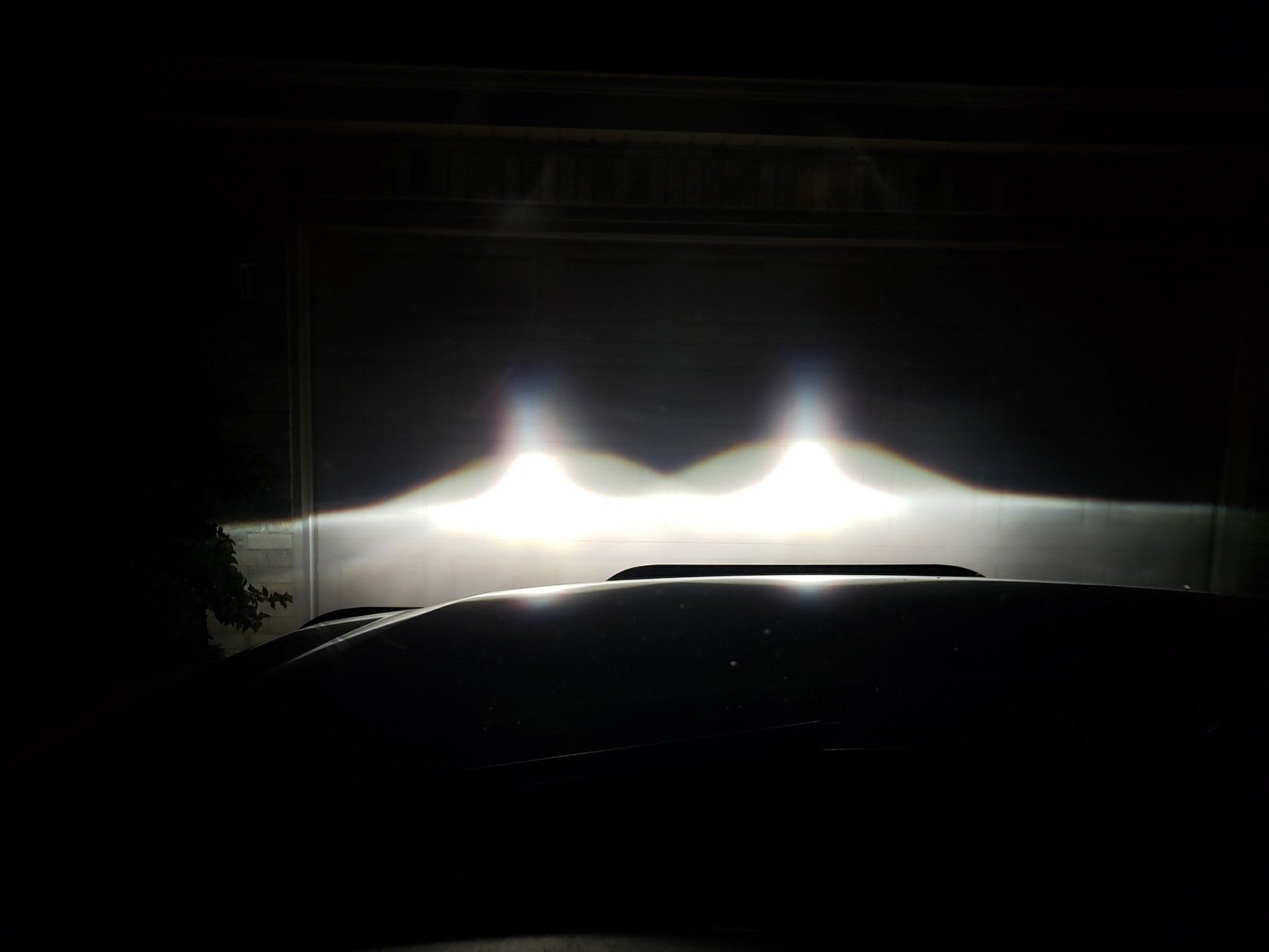

I installed these finally and initially I can see a cutoff line when testing them in my garage. Went for a drive and it became apparent that they were aimed WAY too high and I was getting high beamed by every oncoming vehicle. We aimed the headlights down and now the cutoff line is gone and the light is shining everywhere. Anybody know what’s going on?

I believe your shields are not coming down.
Post #29 on his install thread.
Why would they not be coming down? That post talks about high beams? I’m so confused
perhaps you missed the additional information on post #40 of that thread that tells you to test that the high beam shield drops when connected. It could be a wiring issue but I am not completely sure as I am not there and cannot see you connections but hopefully this will help you retrace your steps on trying to diagnosis the problem.
I see. To summarize, I did not build these lights. I doubt it’s a wiring issue since Lou built these for me? I’m sure he had them tested.
I see, if Lou built them I would assume he tested them to make sure they worked. Thus that would leave me to think you might have not connected everything correctly as that would be the wiring issue I mention. I would give Lou a call in the morning and see if he can advise.
Thanks for your help
