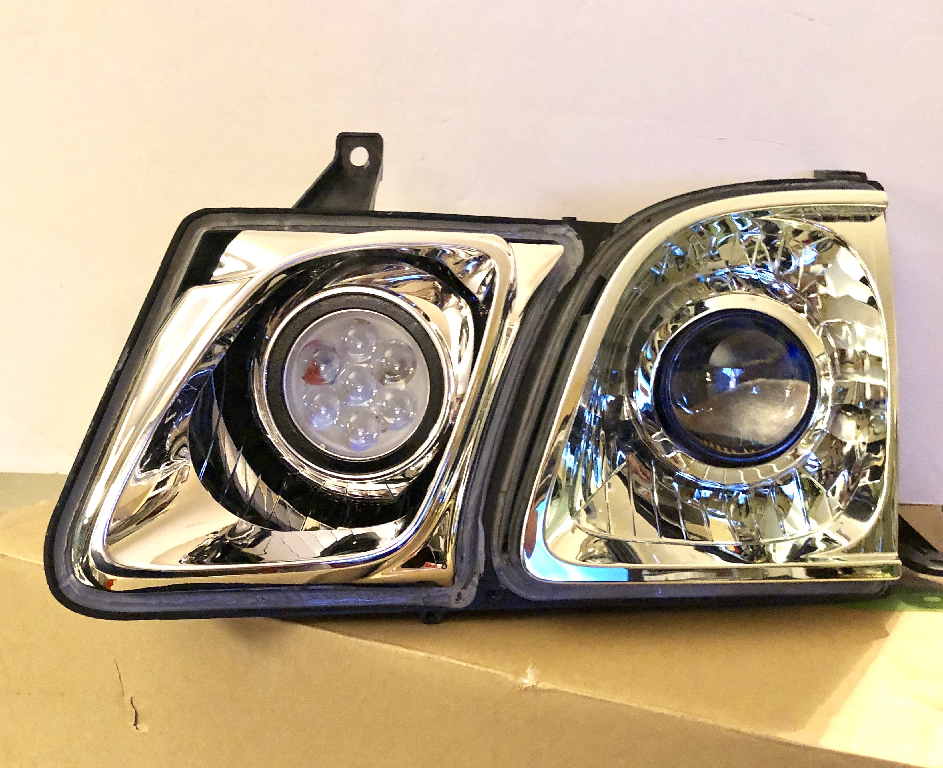

So I just finished 3 sets of plug and play head lights and I’m starting 2 more but I’ve been looking into a possible solution for the high beam location that’s less expensive and easier to install than the Mini H1 which you also lose your DRL(daytime running light)

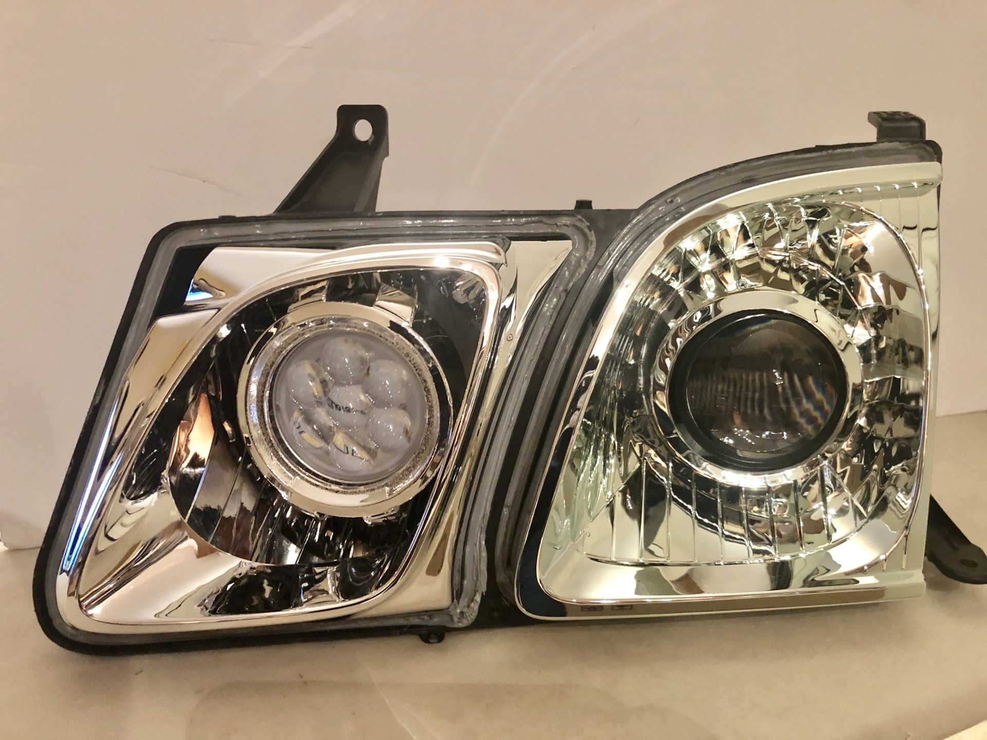

TRS sells a dedicated High Beam LED with a integrated white LED DRL running at a lower intensity

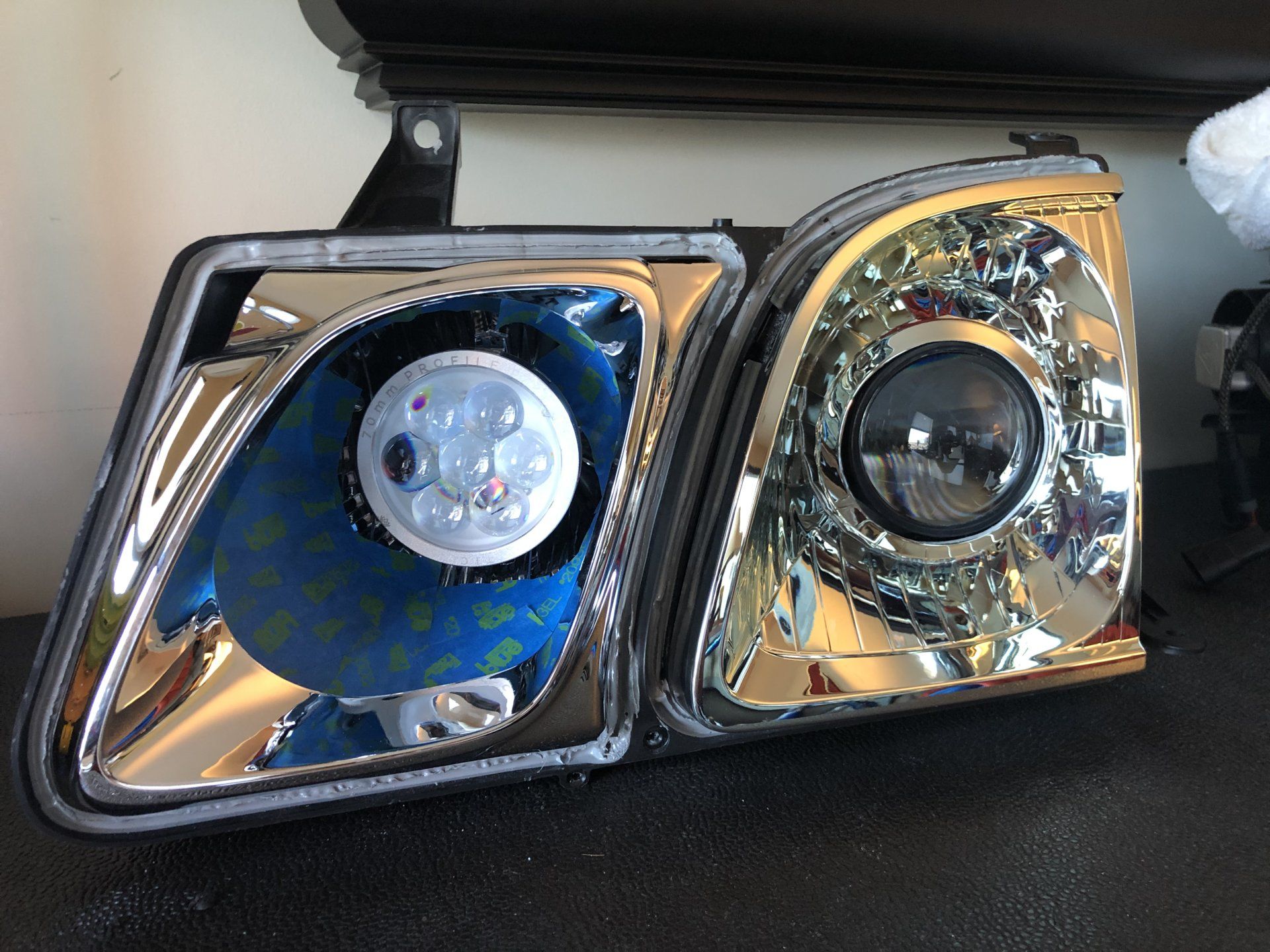

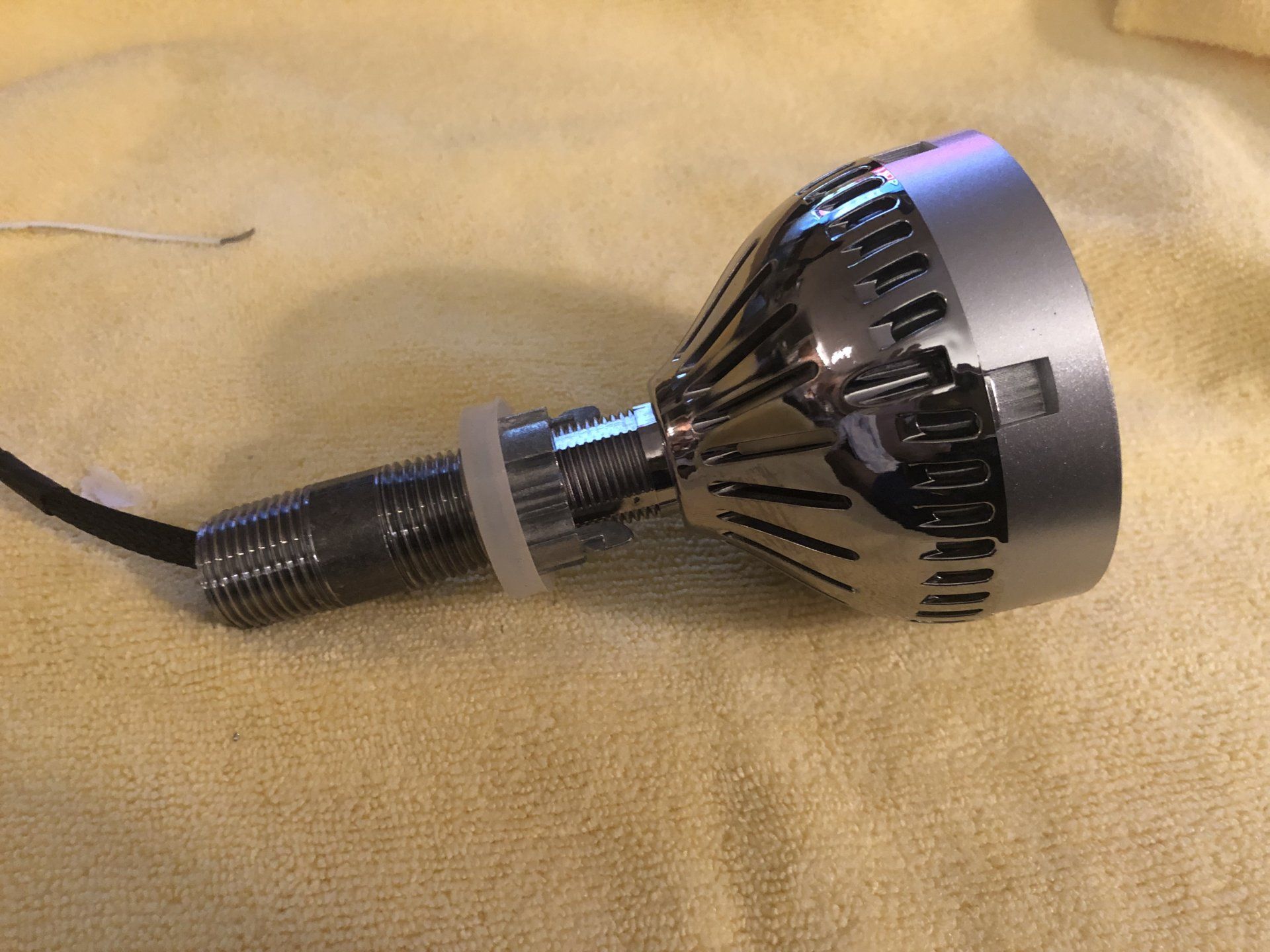

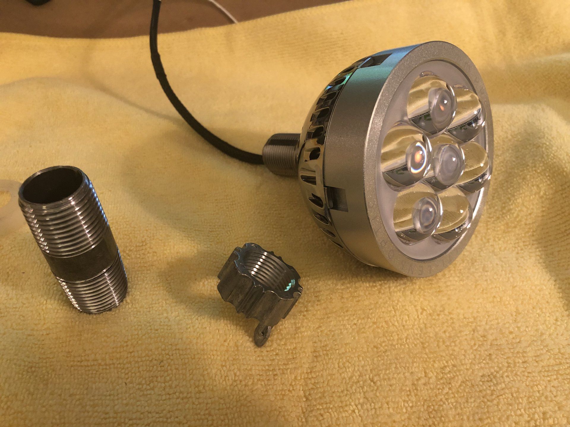

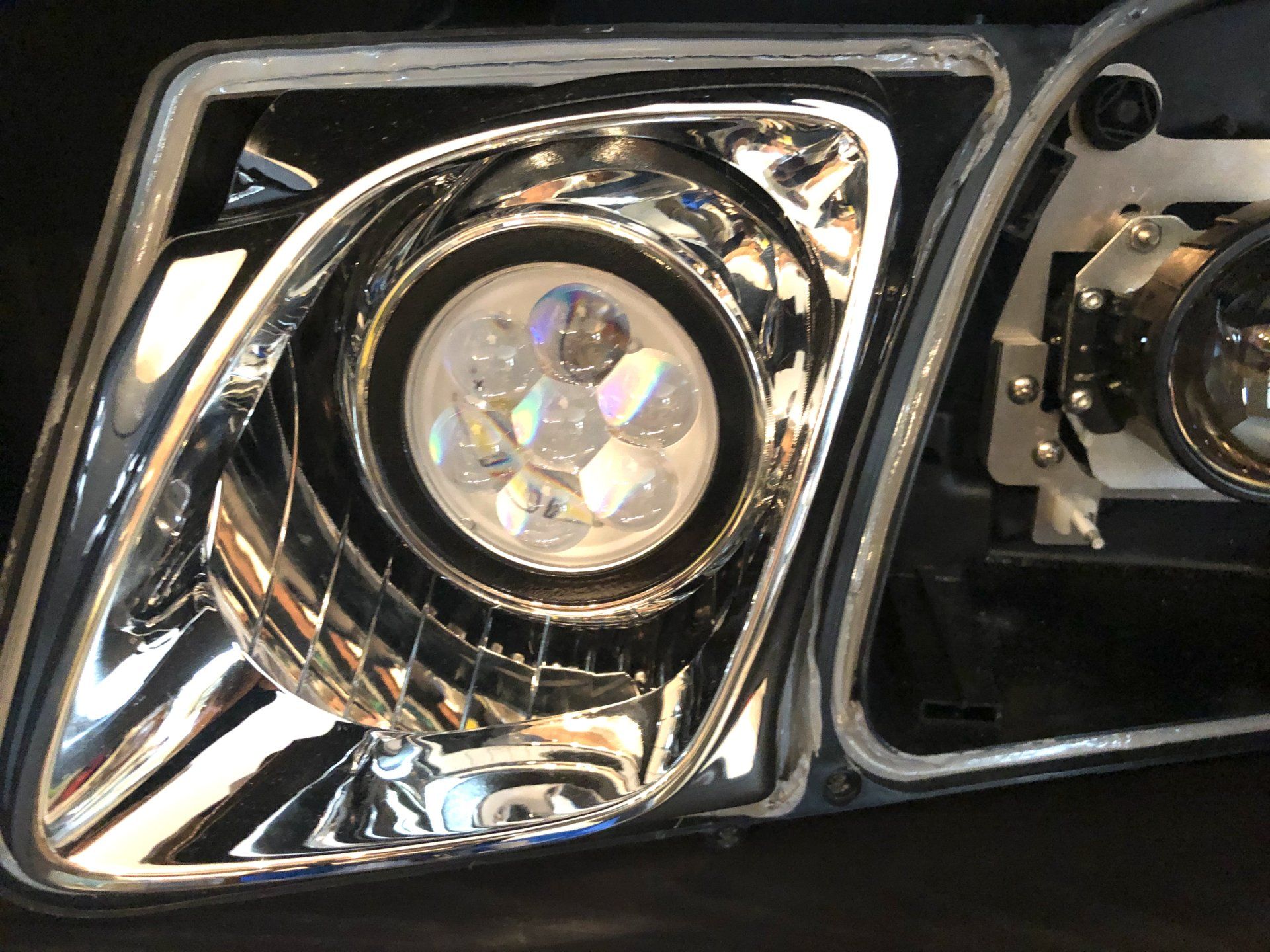

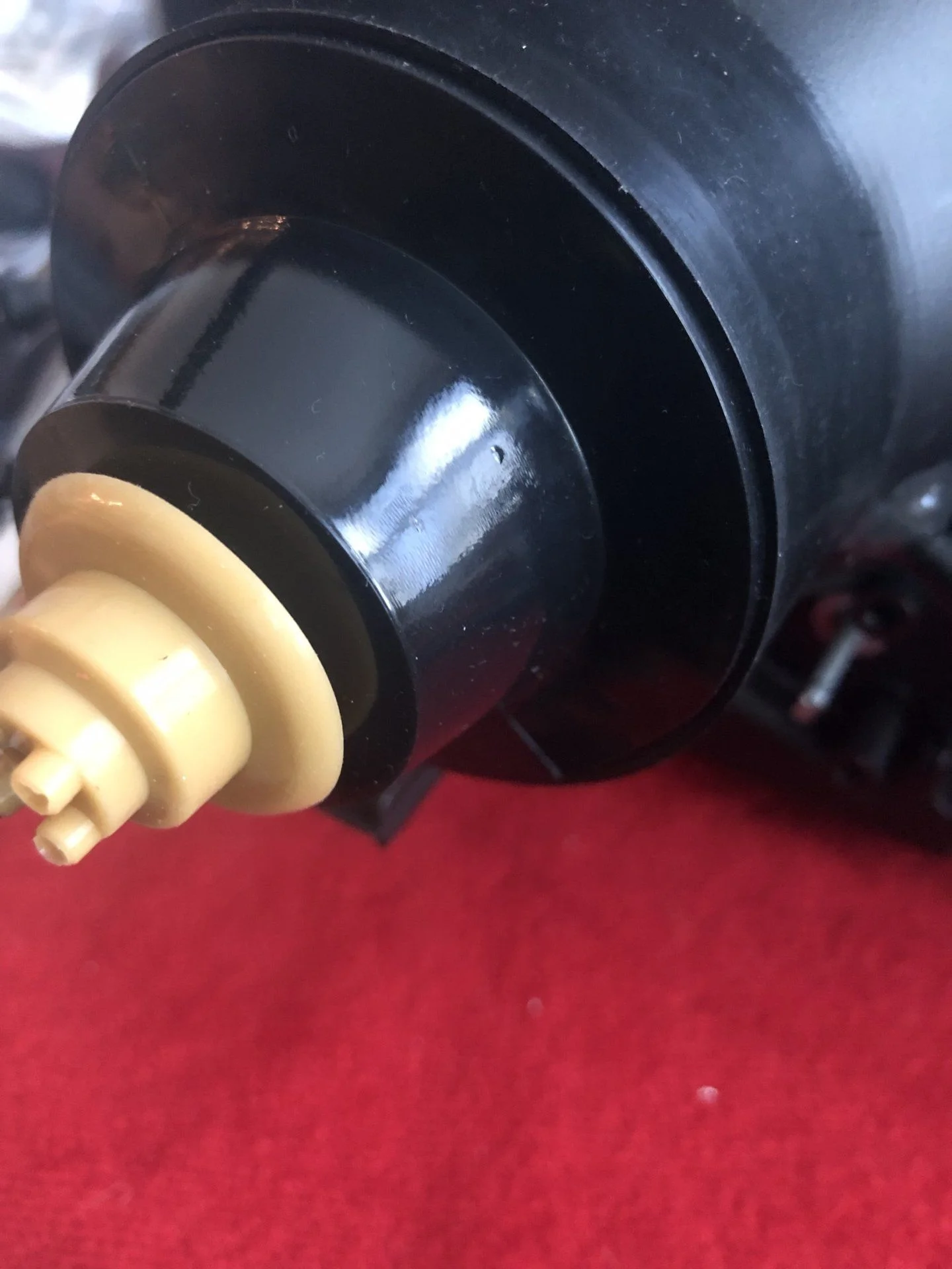

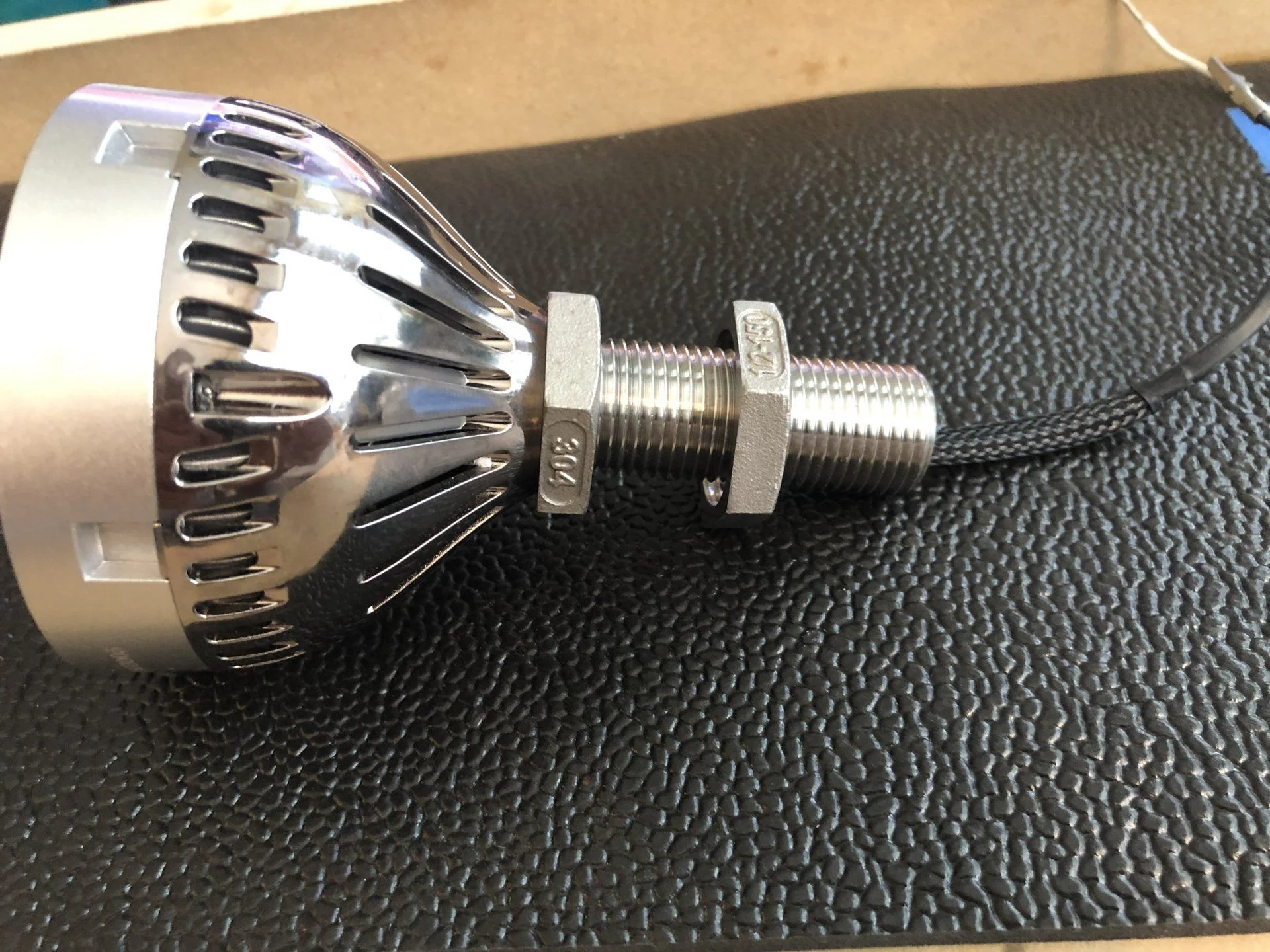

I had a extra housing sitting around... so removing the reflector bowl I then removed that little reflector that’s inside the bowl.. slipped the LED which has a longer threaded shaft thtough the hole and was able to attach the nut .. all done in 10 minutes.. sort of. It set to far back so I found a thread shaft at HD that I got to work..... hacked up a shroud and it doesn’t look that bad.
I talked to TRS about offering a shaft extension and I’ve got a few shroud on the way that should look better but this could be a easy DIY for those with a single projector that want to I have all the lights upfront producing a nice white light and get a big boost in the highbeam location.. I still need to make sure the DRL works in the LX and if so I would offer this as a DIY kit

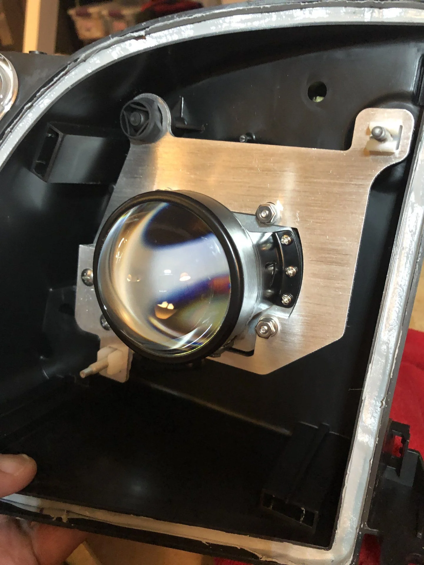

@Luke111 i just ordered the parts from TRS using the Black Friday discount (parts listed in your DYS guide). I then went to your site to order the brackets. Do I just need the mini h1 bracket or the DS2 as well? Is the DS2 for a different setup? Sorry for not reading this whole thread again...

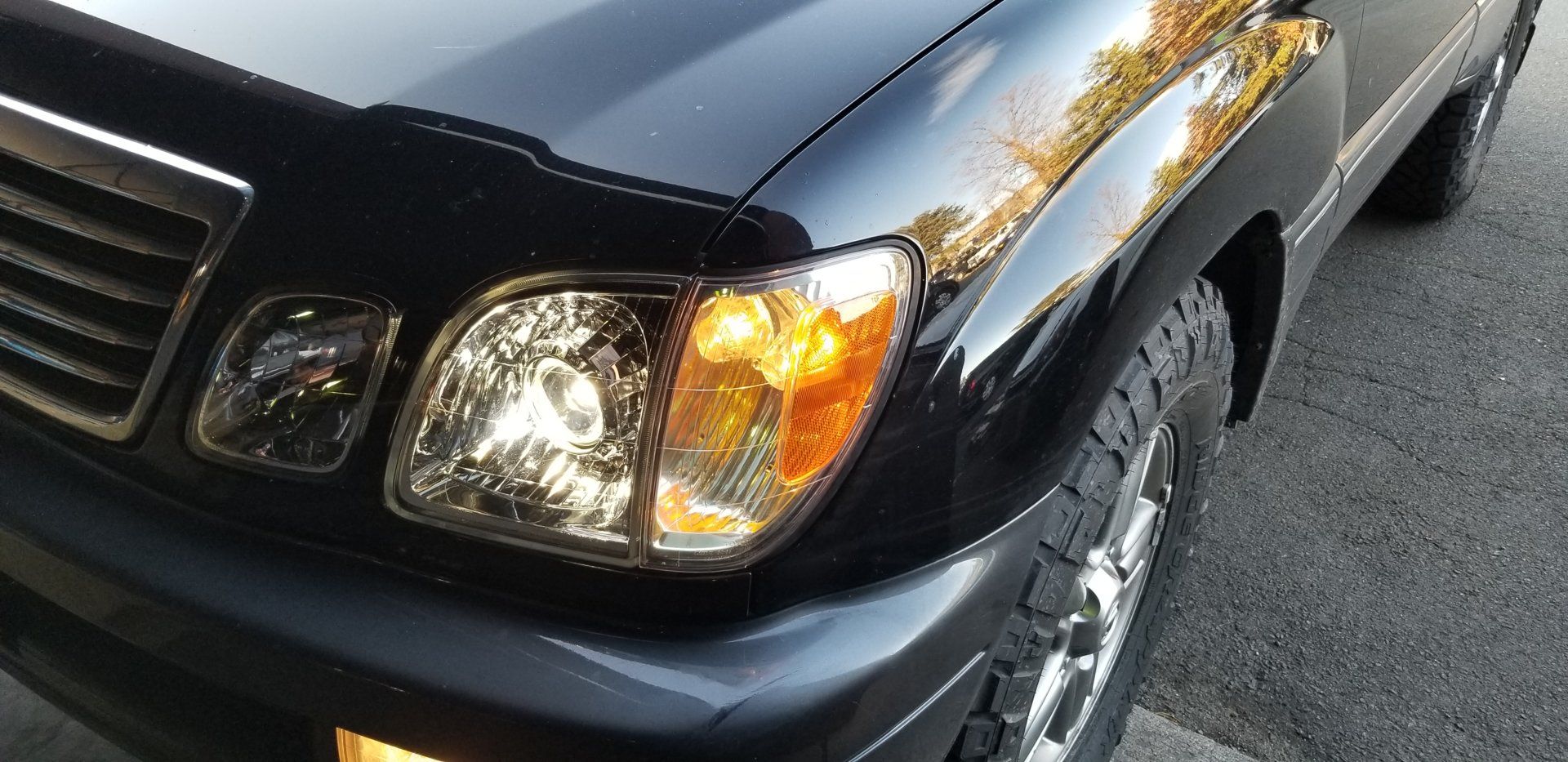

You didn't mess around!!! He's rolling with the D2S 50W Ballast and a 7000K Osram bulb...when combined with the 50W ballast produces a true 6000k output.
If anyone has concerns about down time and install time of the plug and play headlights .. I handed Enrique his lights yesterday at 12:00 and he completed his install and the suns still up..Enjoy those lights!!
Low and high beam output of his lights
Go with the Mini H1... it's a much easier install

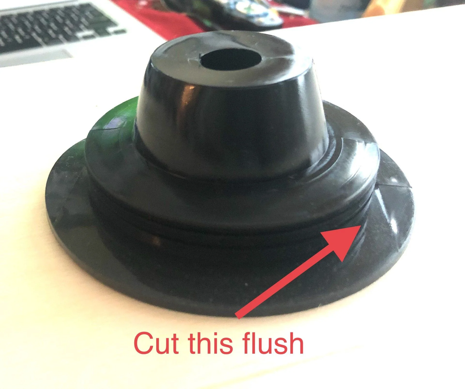

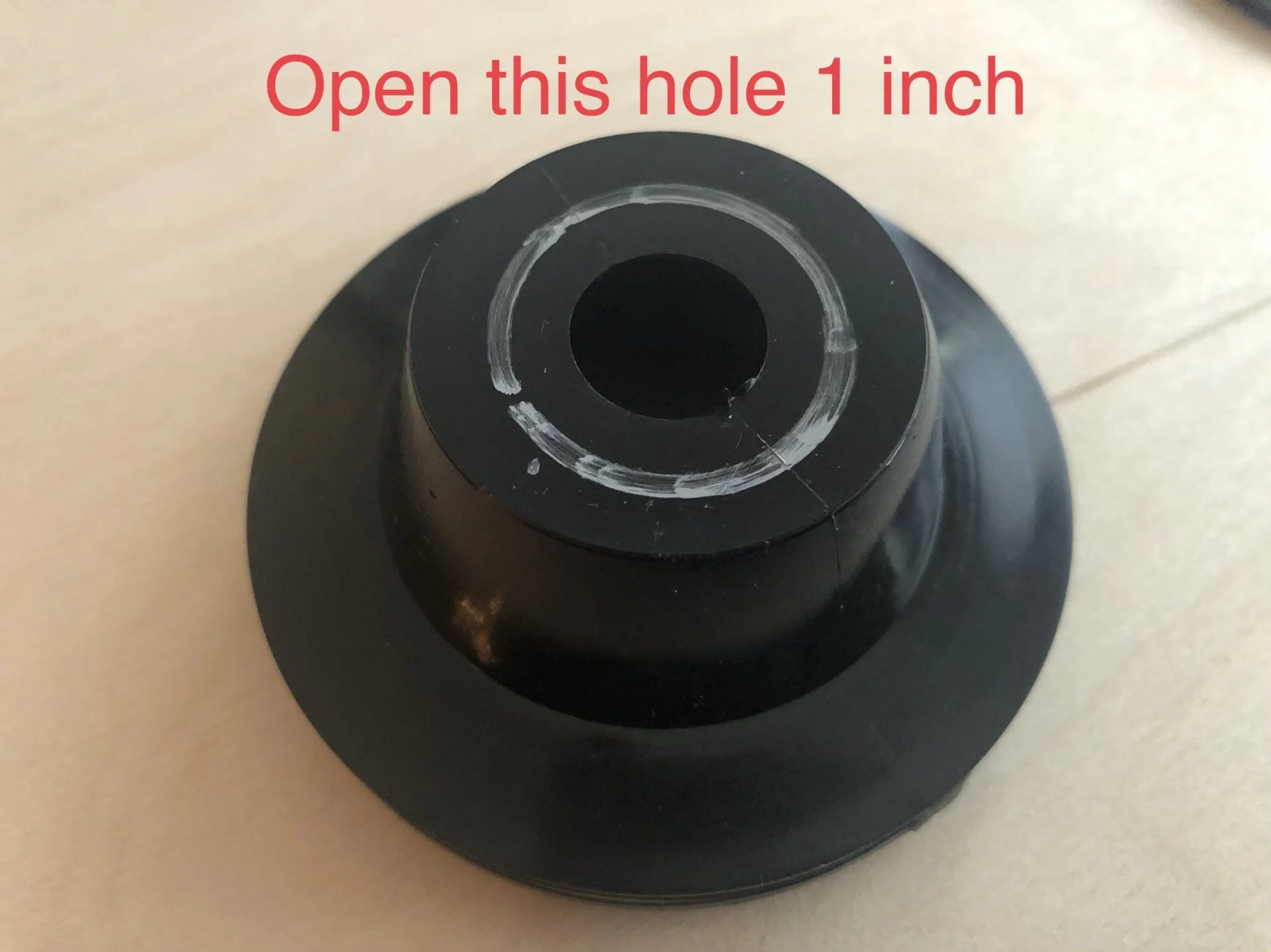

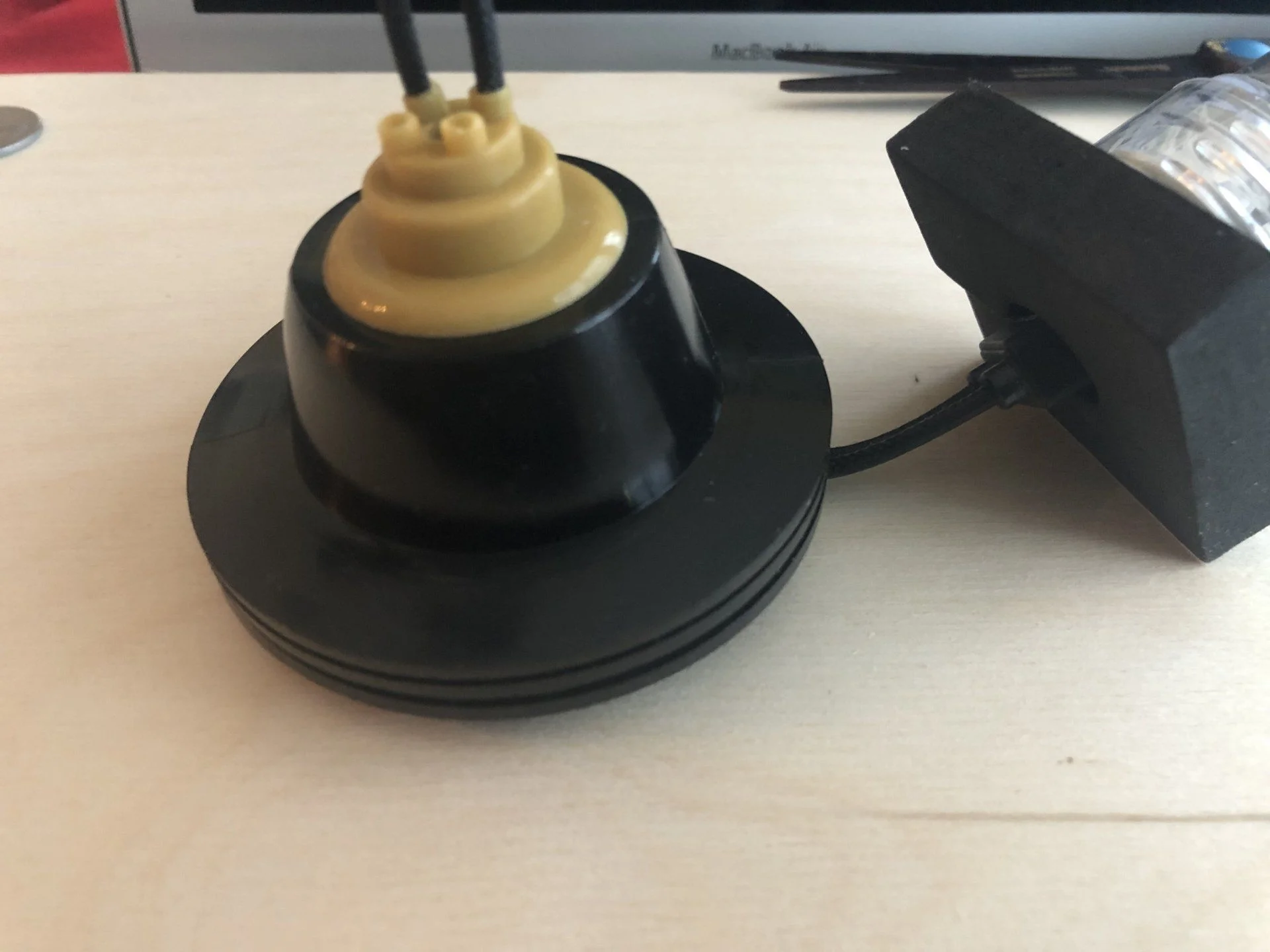

Had some questions about the housing cap I use for the Mini H1 so it’s been added to the install guide along with a link and how to trim it to fit.

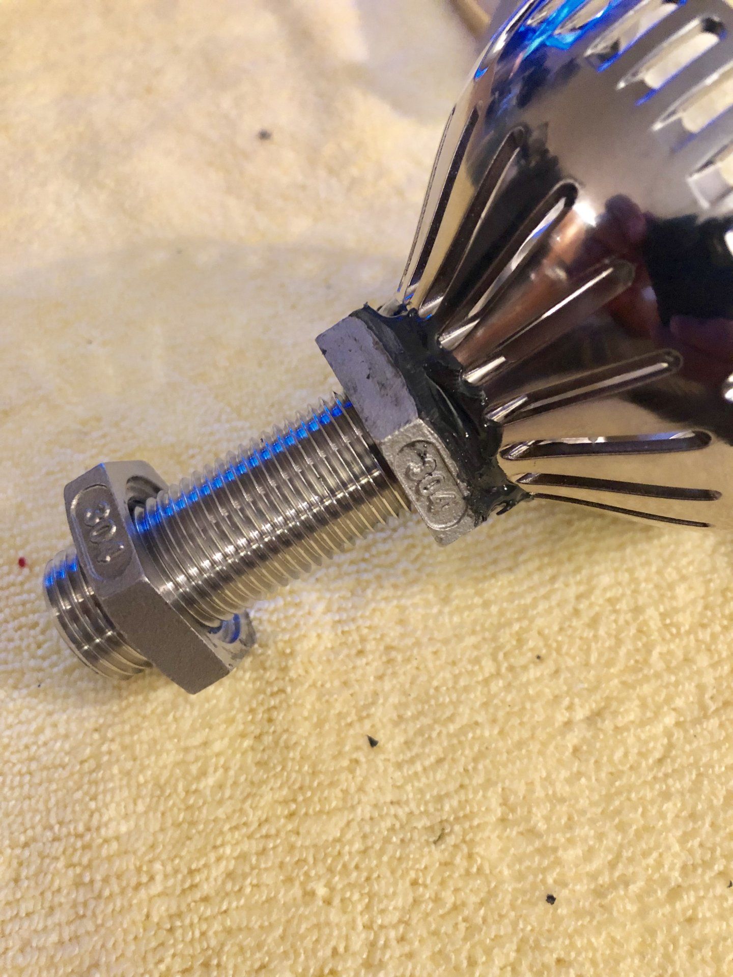

I ended up cutting the plastic shaft off the LED Hi Lens and sourced a longer stainless shaft. Used the nut as a base and JB Welded it on
