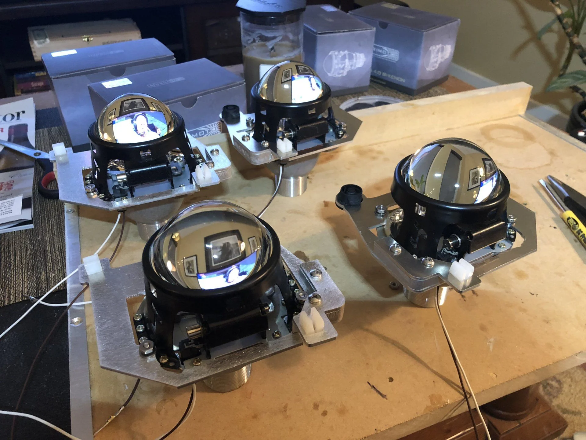

The first pictures shows the bolt JB Welded to the projector... the nut is hand tight to hold it in place until it dries...this is the best JB weld
as it sets up in 5-7 minutes
You can see in the other picture you can easily tighten the nut with the bolt head epoxied in place and in the final picture I JB weld the nuts for insurance they will stay in place. These lights take quite a bit of vibration and it would be a total PITA to open the lights to repair a loose nut
Watching a few video's and reviewing this thread and the install guide will make your job easier

I would order the white TRS clips. You may also want to open up the 4 holes on the bracket where the projector mounts and use 6/32 bolts which should give you a bit of rotational adjustment
