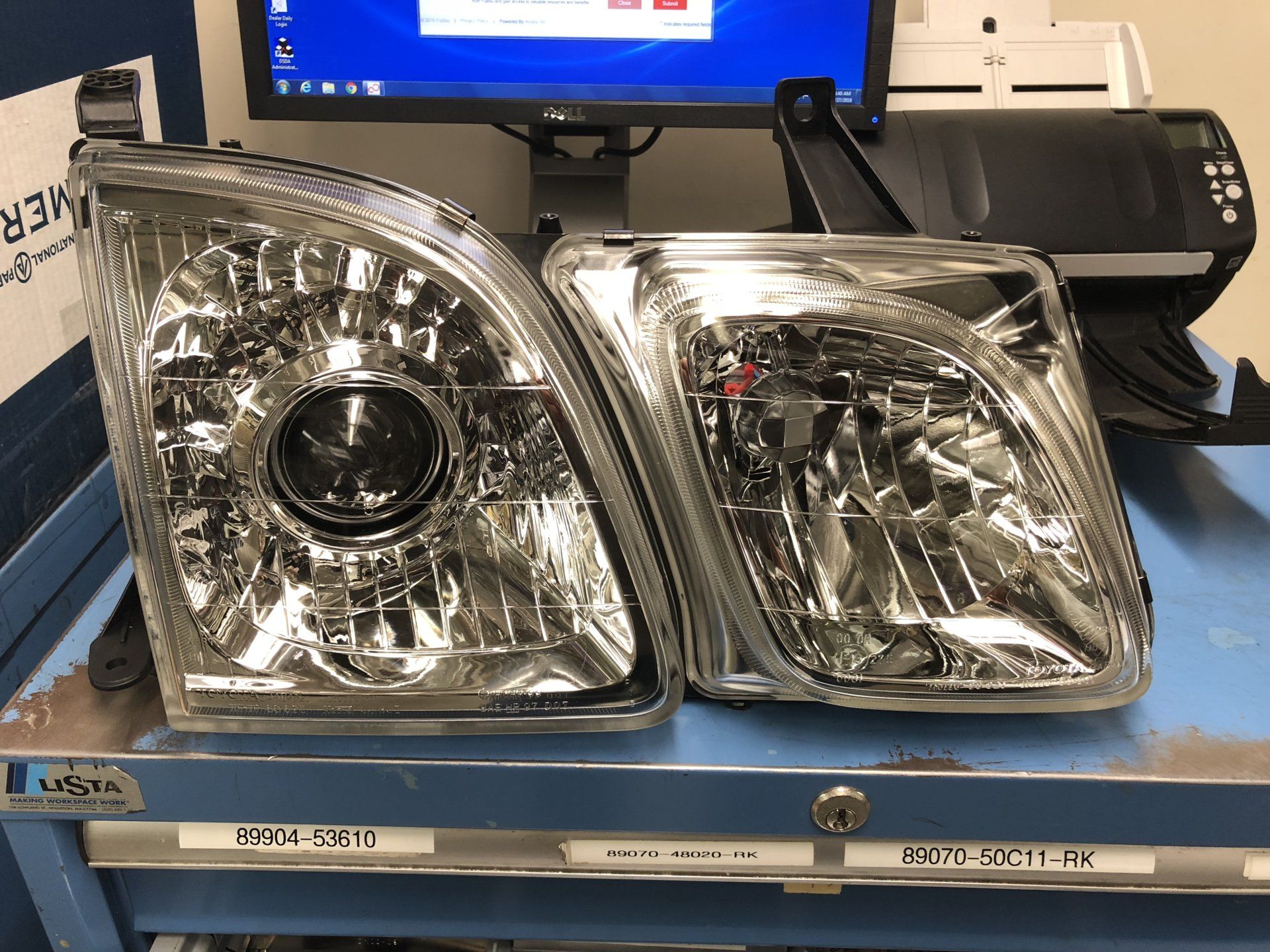

Some of you have asked about glass lens OEM headlights and I assumed they were no longer available, I was wrong. I had my parts guy check and there's a different part number for model years 1998-2002 .....so I ordered one yesterday and drove in this morning to check it out...and sure enough... it's glass. So 2003-2007 have plastic lenses and also have a slight green tint in the shroud. I plan on selling the OEM Housings on my site as soon as i work out the pricing which will be much less then retail
Here's the 1998-2002 Housing with Glass Lenses
Glass OEM Headlights are available
Can you clarify if the 03-07 model yrs can accept the 98-02 glass? Or does the glass headlight only work for 98-02.
I'm going to say yes considering there was no change to the body/frame but I can confirm that in a few days when I test fit them in my 2006
Awesome. I went through a decent hunt replacing one of mine because I really wanted glass and thought they'd been superceded by plastic across the board.

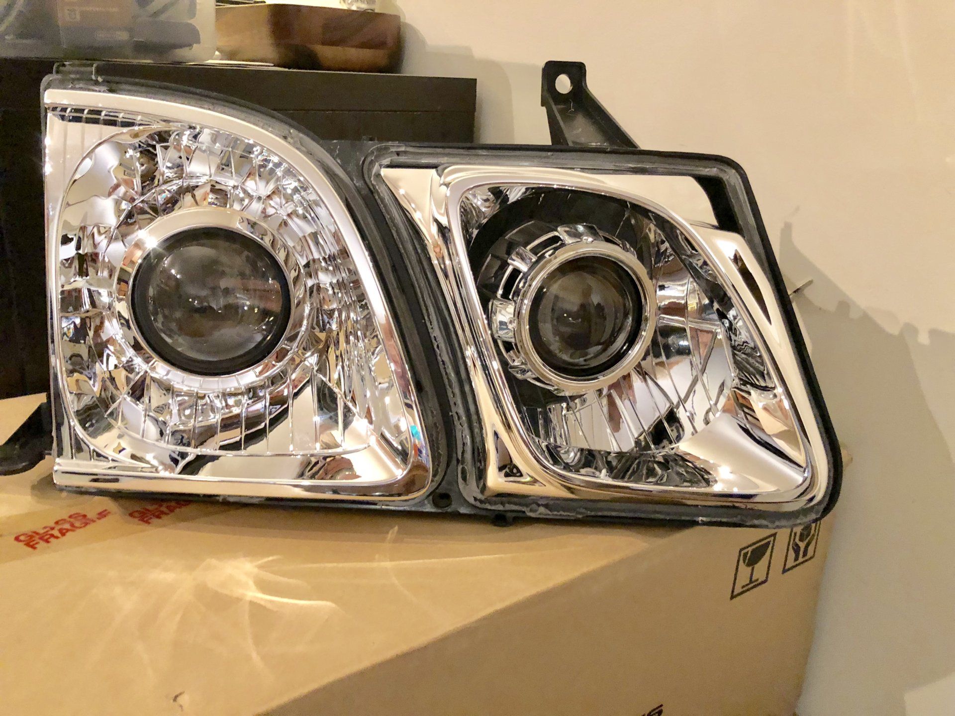

Brought home a pair of the glass lens headlights which will receive a Quad setup for a fellow Mudder and from his own research decided to run the D2S 4.0 and the Mini H1 and sent me this text for his ballast and bulb setup
Lou. Did a little additional reading last night and if it's not too late I would like to go with 35w ballasts for the main headlights, with Osram 66240 NightBreaker bulbs. Highbeam ballasts can stay 55w with morimoto 5500k bulbs.

My setup D2S 4.0 with the Mini H1’s turned off
