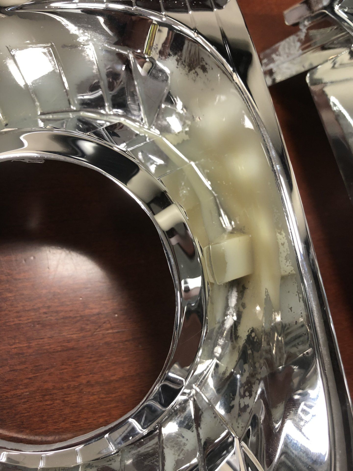

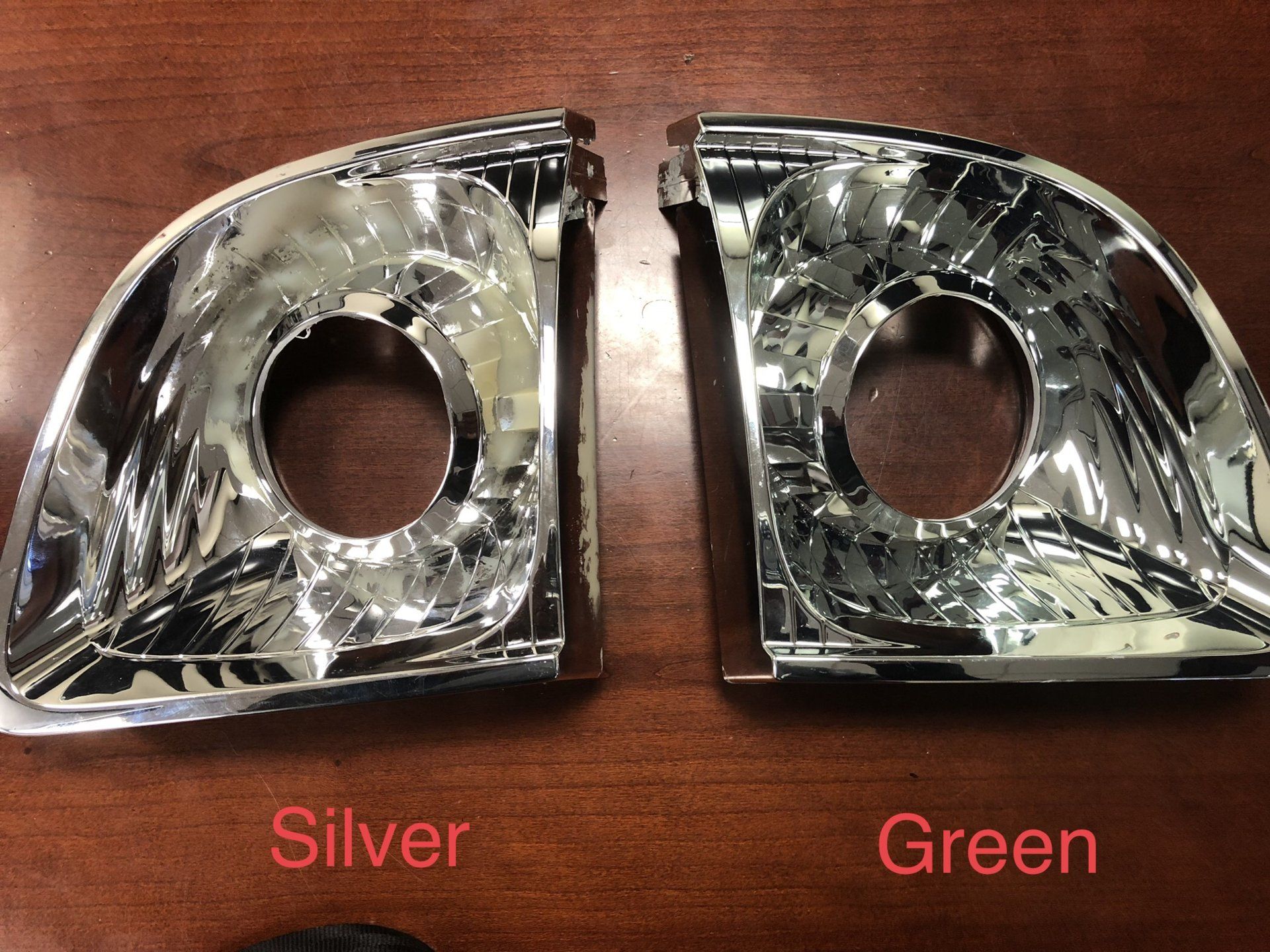

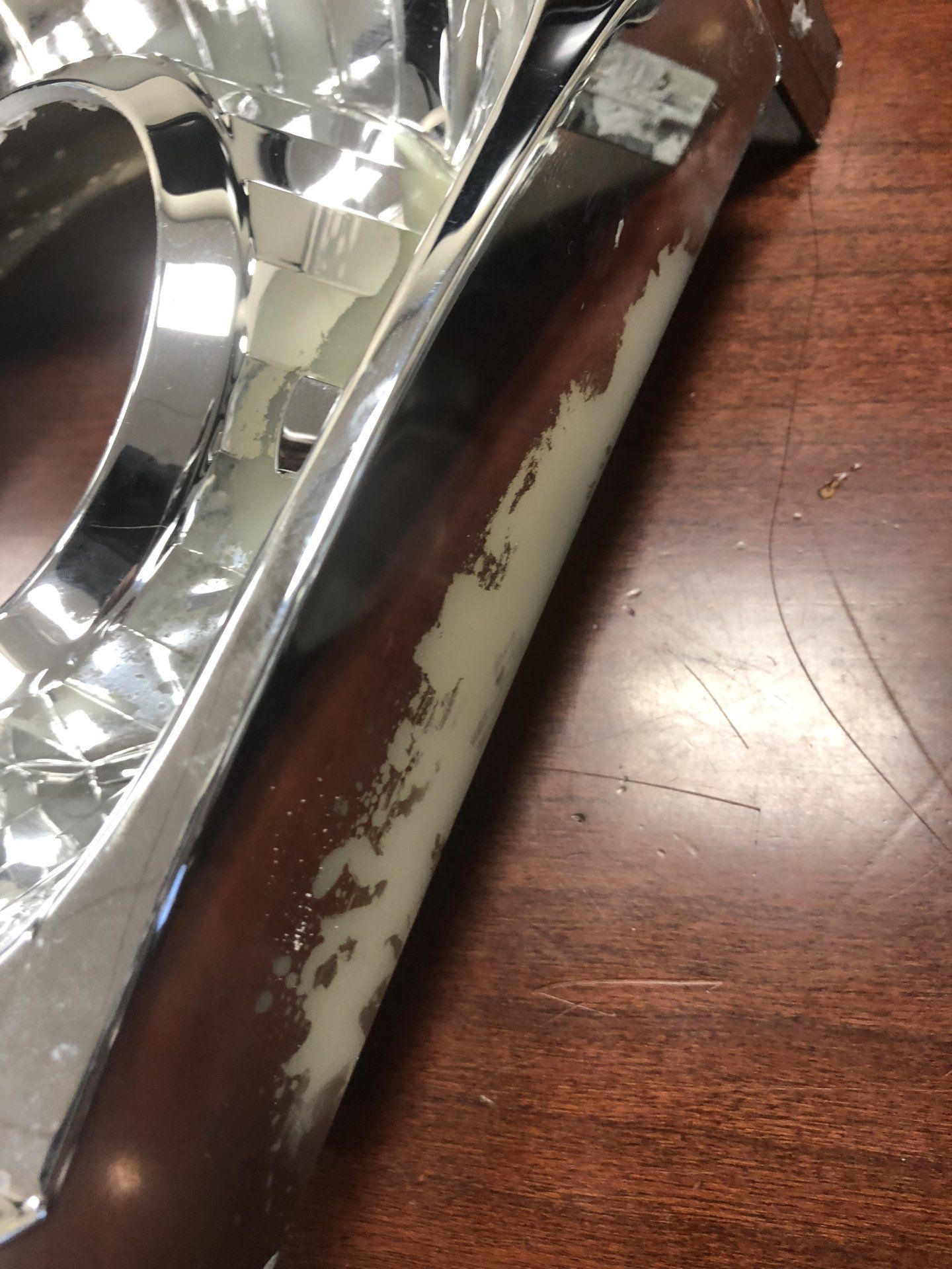

The reason for asking is Lexus changed the chrome process adding a slight green tint to the shroud. So this past weekend I opened up 6 shrouds mostly from damaged lights ...... as I completed one of the older versions (Silver Chrome) and rinsed off the dust....30% of the chrome came off and I'm not sure why. It could be the age of the lights, exposure to the sun and the vibration of the dremel caused it to de-laminate.. I've had no issues with the green tinted shrouds.
So you can wait for the M-LED and then run into other issues which may require you to purchase new housings or install
the H1 because it's a game changer over the halogens you're driving behind.

You could always remove the chrome with oven cleaner and paint them.
Like paint them black? I like that look with black grill.
I'll try that with this one. Guessing I should use heat resistant paint?
Over Cleaner will strip the chrome off just fine. Self etching primer, and several light coats of whatever color paint you want to use and you are good to go.
VHT Paint is preferred, shouldn't see temps above 250*F anyways

What year are your trucks and do your lights have glass or plastic lens?
98, glass lens.
Echoing the other replies, really need to strip the chrome and paint. At this age, even perfect chrome in the housings will flake and degrade sometime in the next few years, retrofit or not. That also makes opening up the shrouds a stress-free task, as you can screw up and hit the chrome all you want, the paint will cover it all.
