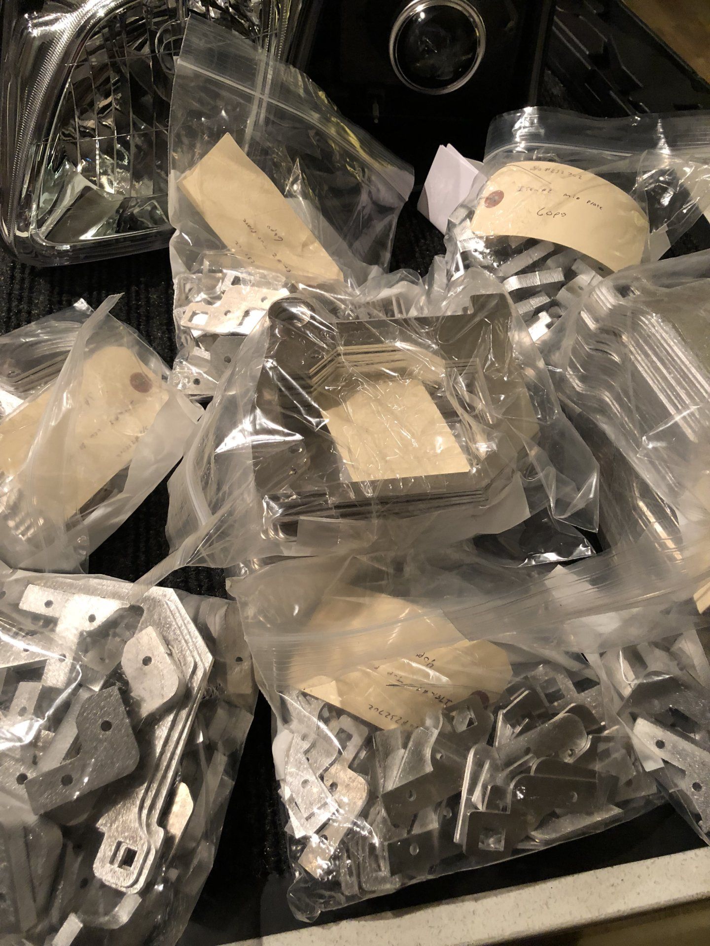

The Brackets are cut and ship today...I should have them tomorrow or Friday. I'll test fit them and open the site up so those interested can buy them.

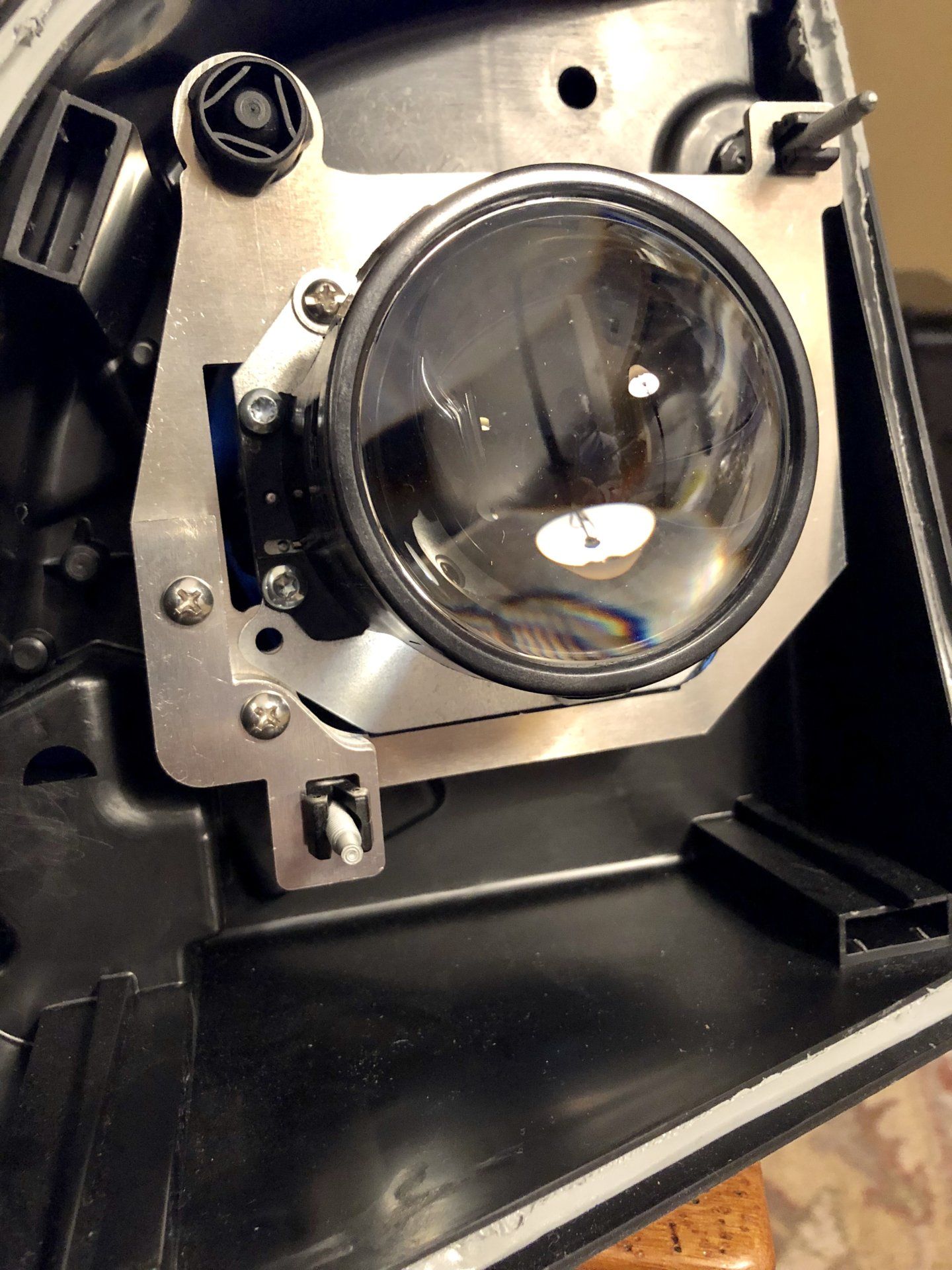

The brackets have arrived and will be up on the site Saturday evening. I’m really excited about the M-Led... I was worried
It would hit the housing but it clears.. I’m hoping to get these in my truck this weekend and if they test well the plan is to offer finished plug and plays lights.

You shouldn’t have to wait long I just need to make sure they are centered in the shroud.
I also had the projector mounting holes
enlarged to allow a slight rotation which will help level the cutoff

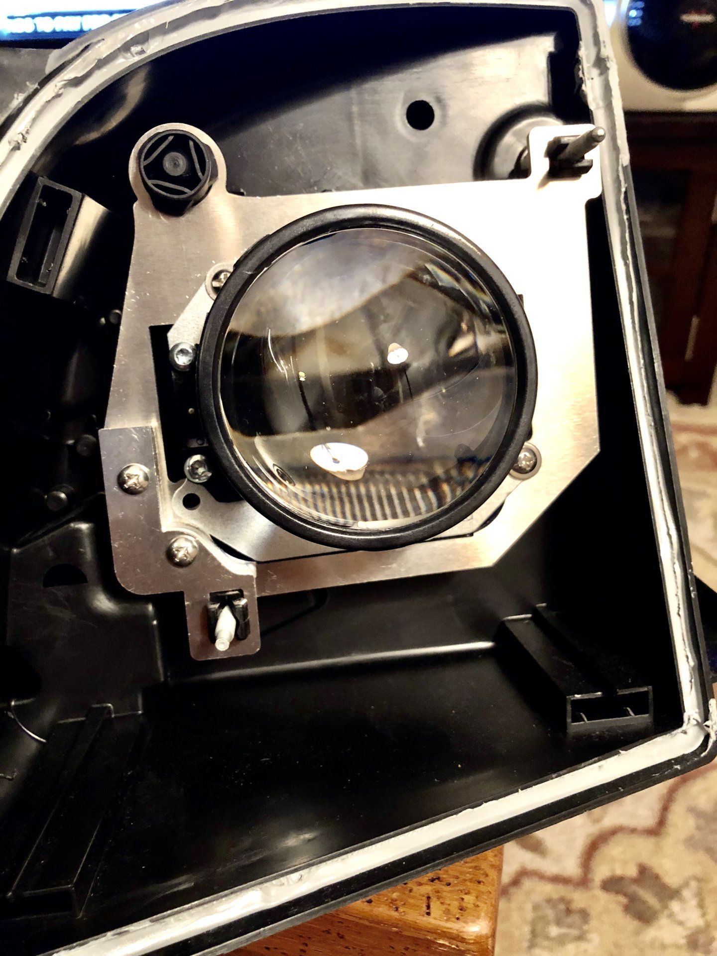

Exciting stuff with M-LED, do you have to trim the shroud to make the lens fit like M-D2S 4.0? Or does it fit perfectly with factory shroud without trimming?
The shroud has to be opened up like the
D2S 4.0
Got it, thanks Lou! I want one, but still debating between M-LED/D2S or just be happy with M-H1.
Sorry for the delay but the Mini H1 are for sale and I'm waiting for a final test fit for the D2S 4.0 bracket ...the sad news is the M-Led which I was hoping would work on the same bracket as the D2S does not... While it bolts on perfectly it's slightly offset and sits 1/4 higher so I'm cutting another bracket meaning another two weeks before it's back.

Yes you have to open up the shroud...the shroud opening is 2.5 inches the M-LED and the D2S 4.0 require a 3 inch opening
