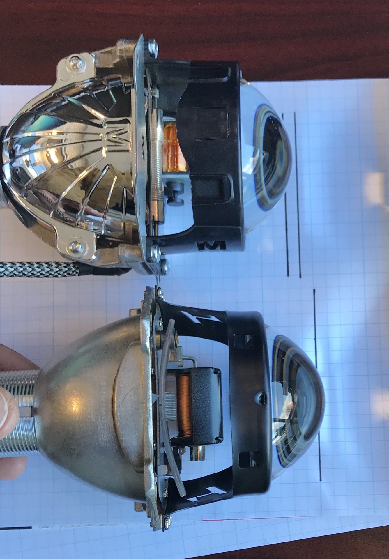

Coming soon, installed in a pair of new OEM LX470 Headlights is the M LED from Morimoto. Word is they have the same mounting holes as the D2S.....so I have a pair headed my way to test the fit on the D2S bracket.
Cool features ....they are Instant On with zero warm up time. You don't need a relay harness as they plug right into the high and low beam connectors and the threaded mounting shaft can be removed from the projector to free up almost an inch of depth for those who don't need or want it.

The M-Led does not fit the current D2S Bracket.
The upper mounting holes match but I use the holes that sit 1/4 below which the M-LED
doesn’t have, so I would have to re-engineer the bracket slightly and change the opening to accommodate the differences in width
Check out the picture with the bracket on the D2S..... it’ll give you a better understanding of how tight the tolerances are on the current bracket and why the M-LED will not work
You can see there’s also a difference in the overall length from the reflector bowl to the end of the lens
I’m going to sit down with my CAD guy and see if we can’t create a bracket that work for both I definitely want to build this bracket
