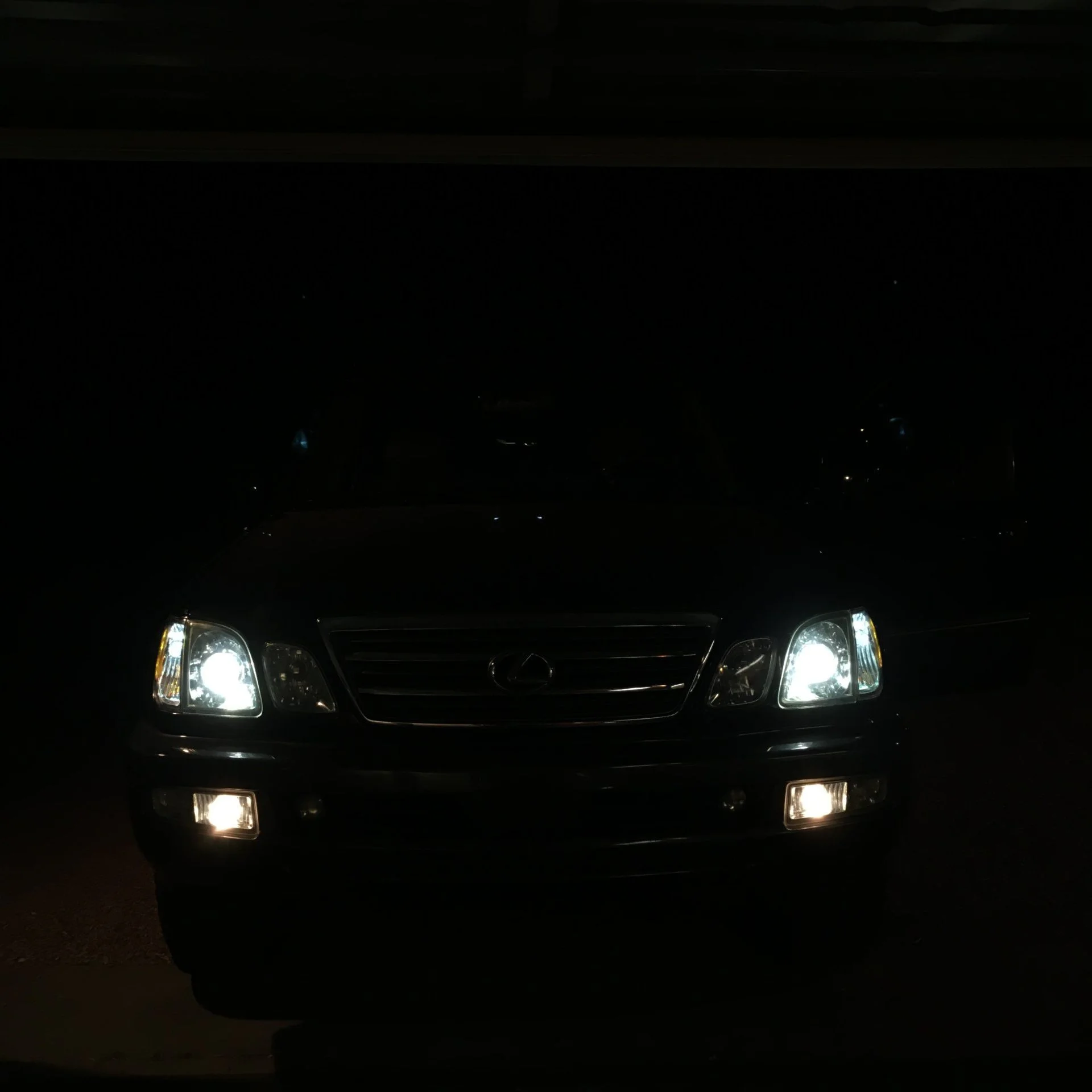

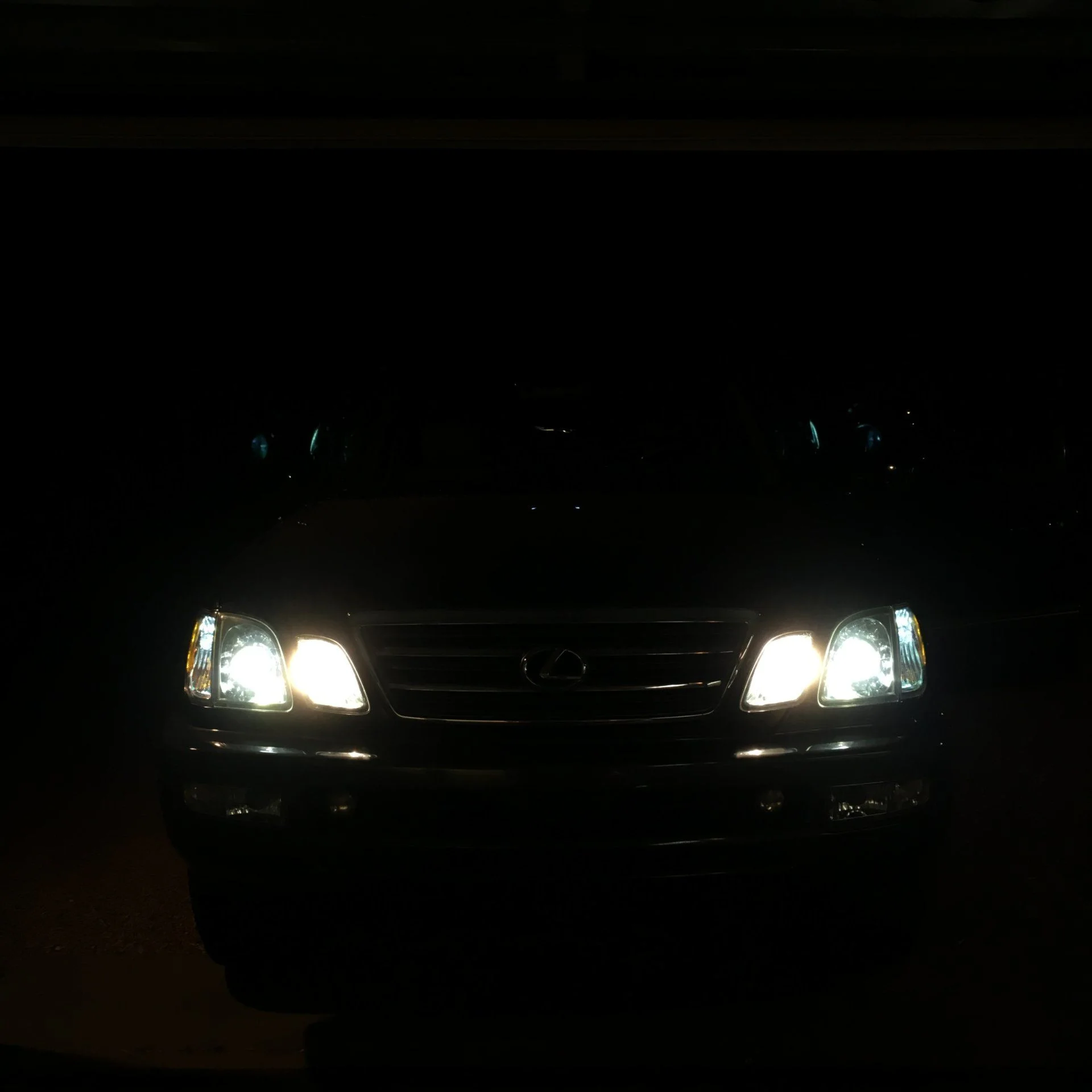

Got @Luke111’s awesome bracket via USPS a couple days ago. Had taken lights apart day before following TRS video guide & Lou’s excellent guide. Put everything together following his guide — pictures and diagrams are soooo helpful. Everything went easily and presumably as it was supposed to. Did my best to adjust lights according to online instructions. Put all the trim pieces back and on and it’s like nothing ever happened! EXCEPT I can now see at night!
No before photos to compare, but results are similar to other photos that have been posted. Here are head-on photos after the install. You can see color difference compared to fog lights. Night time visibility is just so much better, like driving a new 200 series. :) Thanks for the great bracket and awesome instructions @Luke111 and to everyone else that offered advice!

Chris, thanks for the nice review
Lou
