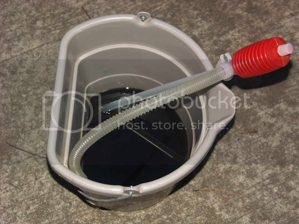

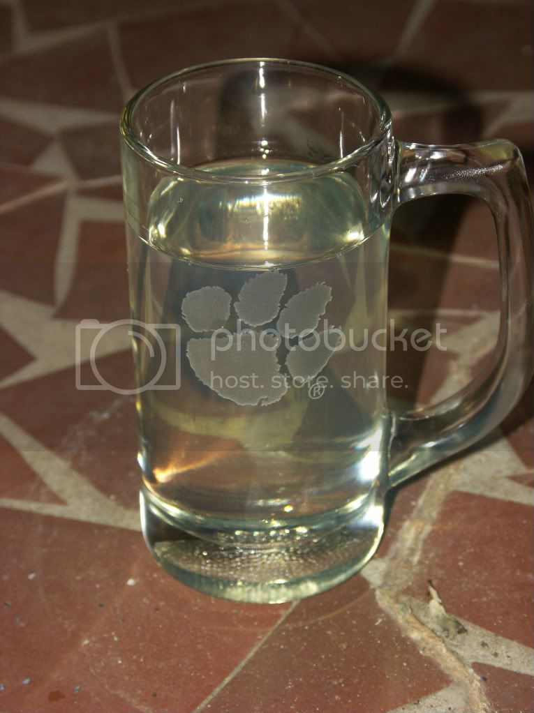

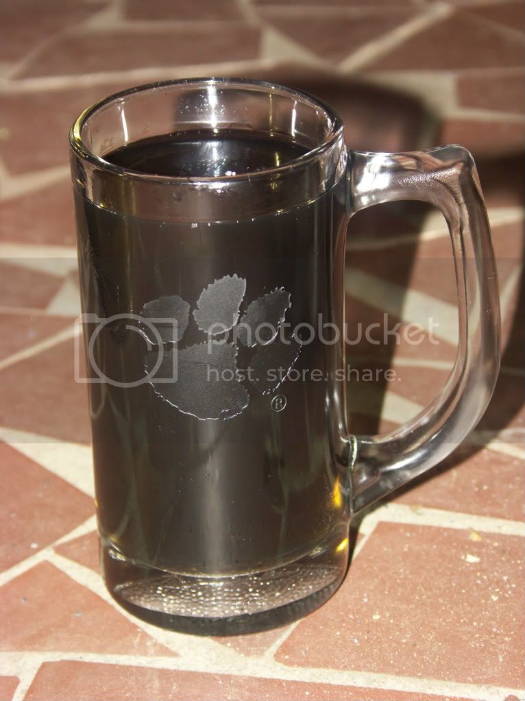

Shouldn't really have AHC fluid leaking out of the shocks so you may want that looked at. Also if you've never had the fluid changed in the system, I'd say you are due!
BTW here's what my fluid looked like new vs what came out...
huh, impressive :-)
well the car has a proper service history with the dealers up until now... what is the recommended service interval for the fluid... darn... i can't get the color outta of my head!
