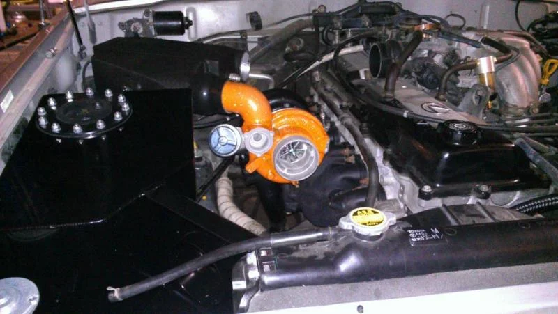

Ok so went up to the shop and the orange in person did all the things I asked for; it surprised me, was really bright and made the turbo stand out, but it was a little too much for my sensibilities. So we are changing it up. The EMS guys rock, they humored me over 3 hours and coated like 4 different colors so I could see them. So out with the orange and in with the new.
Haha, they have a pink one set aside for you! Evidently they were going to surprise me and plastidip my wheels pink, but I don't leave them alone long enough for them to do it. lol.
Purple was brought up more than once by one of the guys in the shop. lol I thought about pink because of the humor of it but only you guys on mud would get it.
Everyone else would just think it was bad ass. Ill let you know the reactions I get ;)
I love all the nice big money turbo goodies and then the $5 dollar Walmart air compressor filter for the catch can. :hillbilly:
My shop has a Pro-Vent oil separator sitting on the shelf I am tempted to try but not sure if I want to spend that kind of coin, plus the inlet and outlet are quite large and would have to be reduced.
Oh yeah, ATS uses purple compressor housings on their diesel turbos so I wouldn't go that route, be different!
Haha that was just something I threw on there while I was naturally aspirated to keep things clean after the rebuild. EMS is building a custom catch can ;). Good eye though. Lol

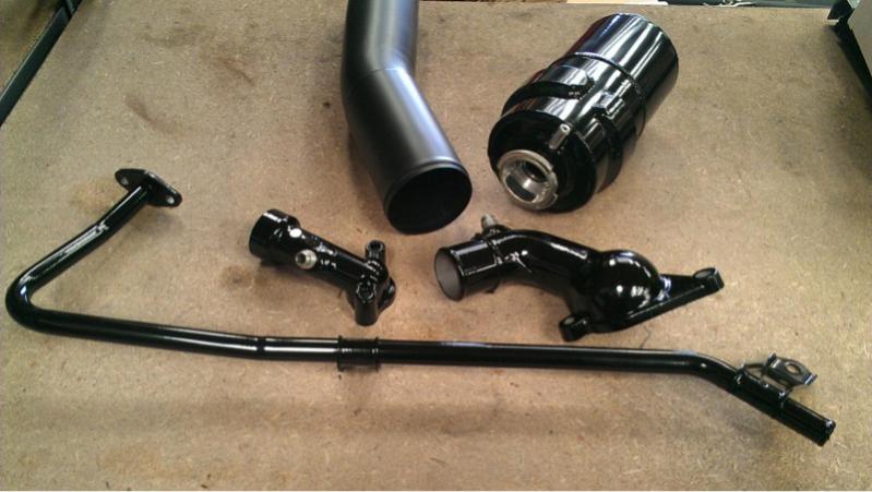

Few more parts
Thermostat housing, with weld on fitting for turbo inlet,
Upper water housing with weld on fitting for water return.
Water tube just cleaning things up it was a little ugly.
Coolant catch can with some aluminum strap to make it fit the evap can bracket.
Charge pipe with double ceramic coating.
Just double? I can not believe you didn't go triple...
Hurry up already! I want to see what that suckers gonna do.
