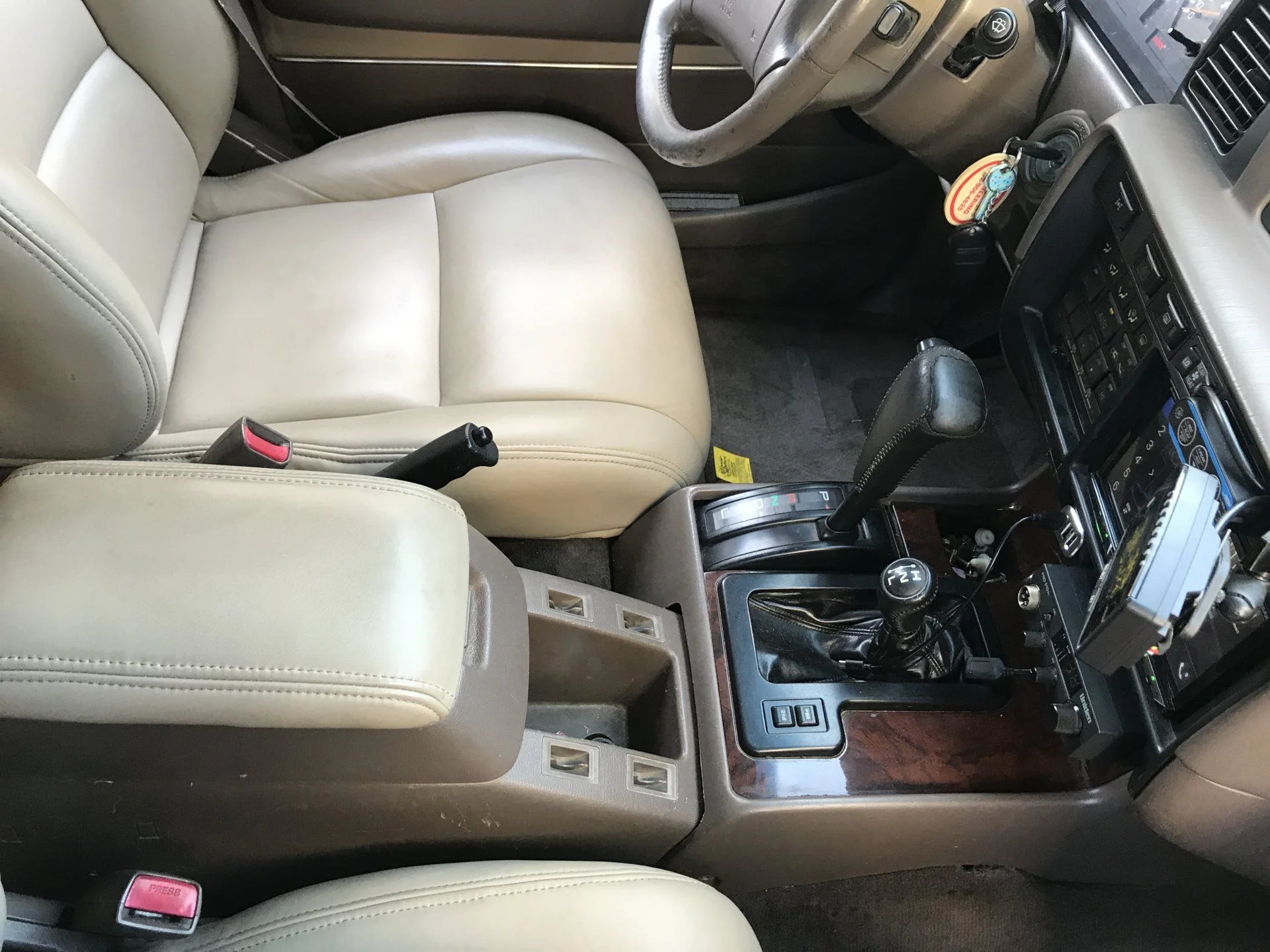

I plan on replacing my center console with a standard landcruiser one for increased storage. When you bypass the OE amp, the center console sub no longer functions,

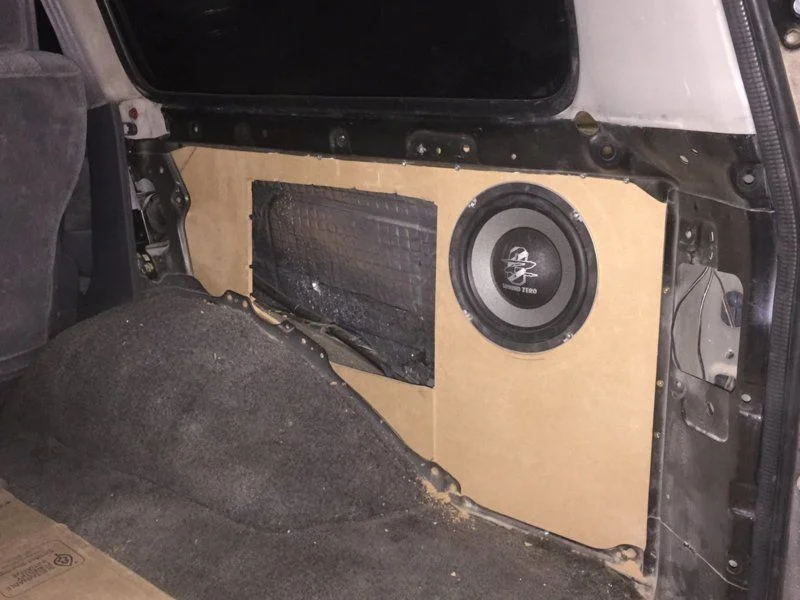

I put a 10” woofer in the rear passenger quarter panel.

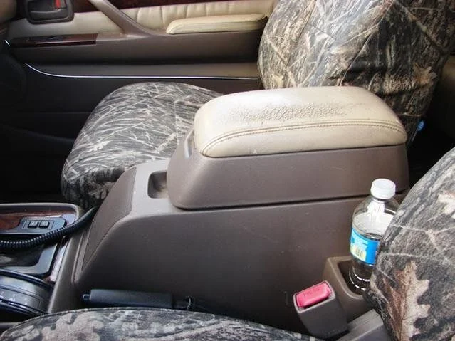

I replaced the LX450 center console with a Landcruiser center console.
Looks OEM & you gain a bunch more room to store stuff in the console since there is no woofer.

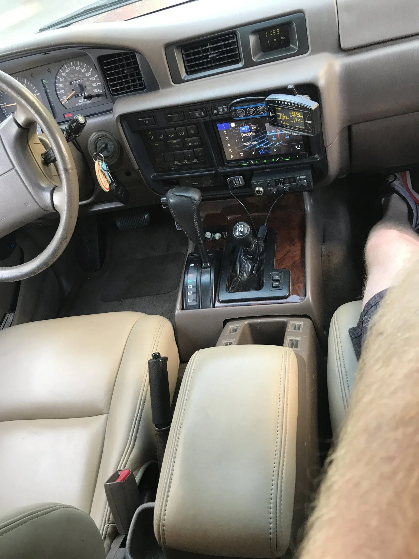

I kept the stock center console and removed the factory sub and CD changer. My amp lives in there now. Two full sized Class A amps can fit in that space along with whatever electronic gadgetry you wish to add.
The stock speaker grill is serving as a vent, but I may mod that into a panel or CB mount later.
