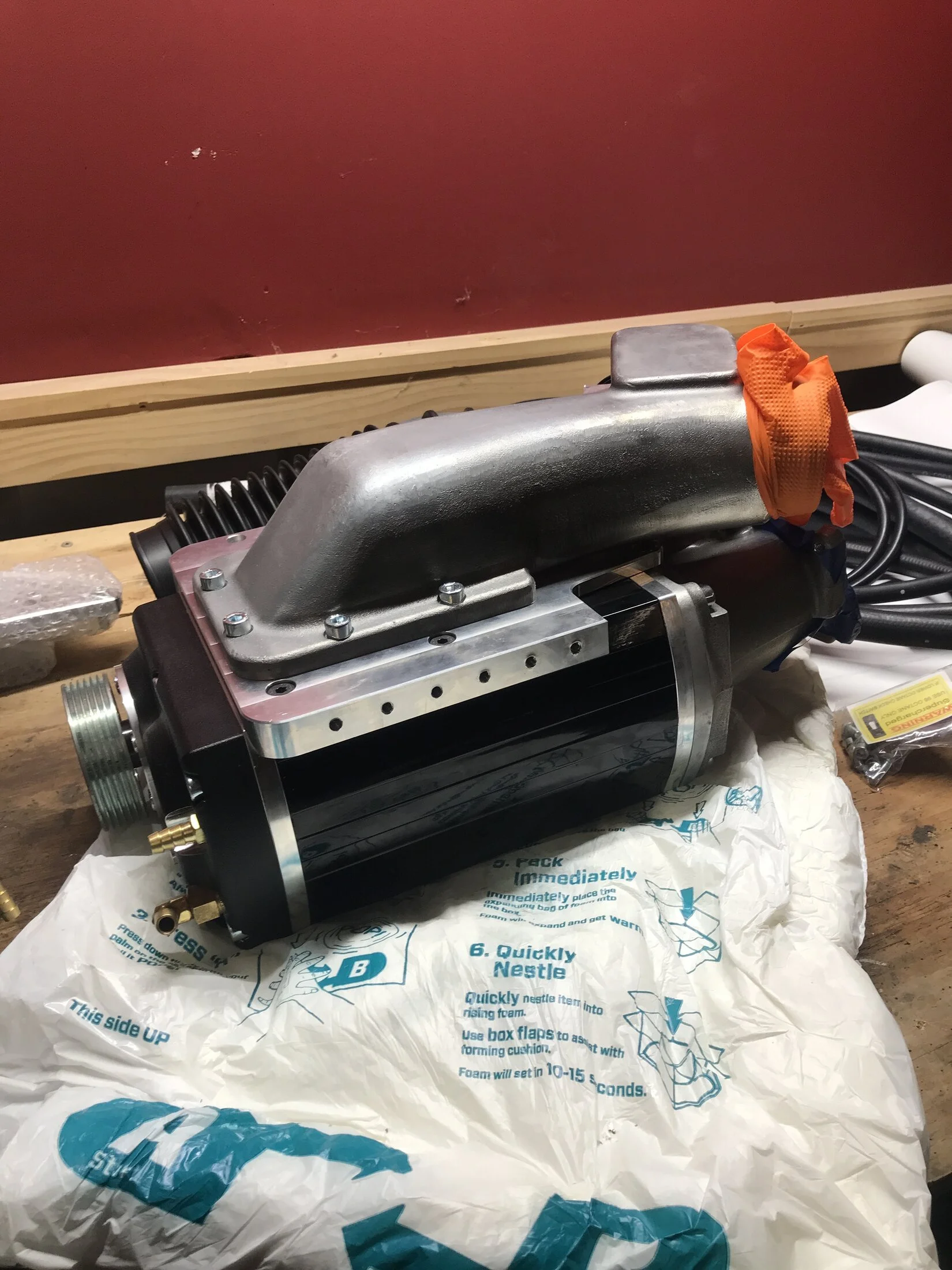

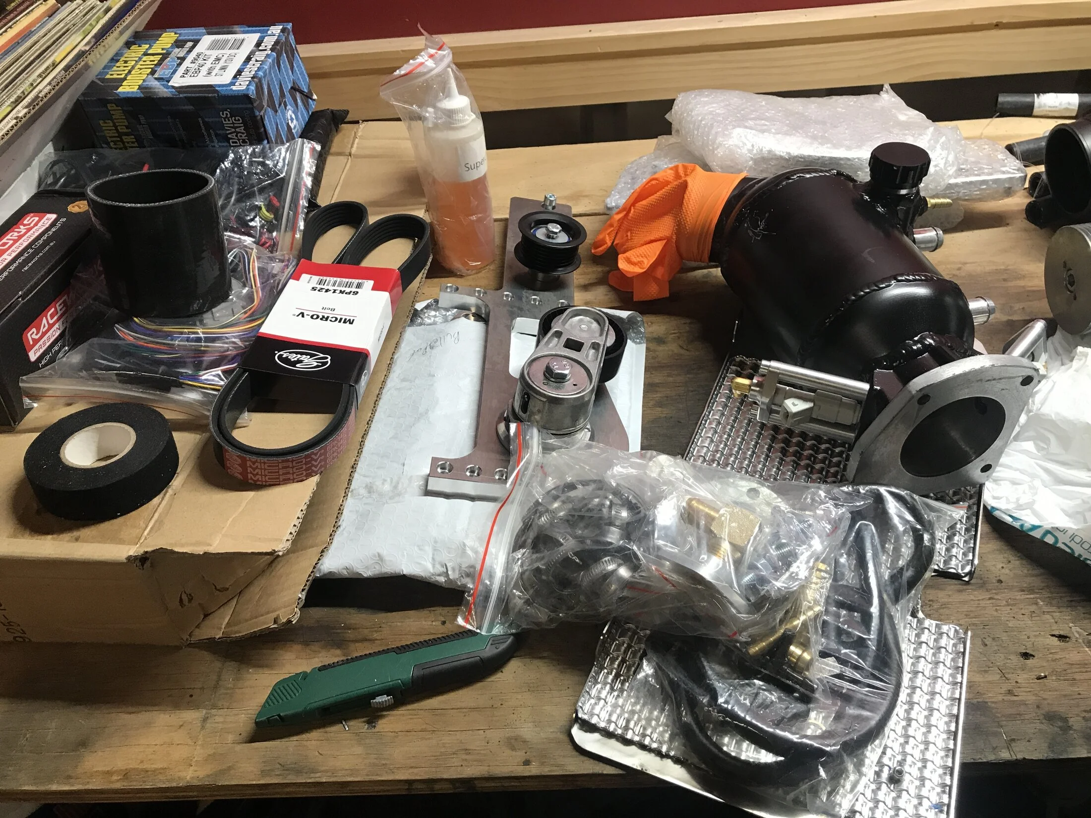

Here are some pictures of everything unpacked. It was 7800 to my door. But I had them send a high flow fuel pump, xede processor, and heat shield. So it could be cheaper without those. It got here less than a week after shipping which I thought was impressive. I still need to get an afr gauge and boost gauge. Also will need to delete the egr for fitting reasons. I got some pretty detailed instructions as well

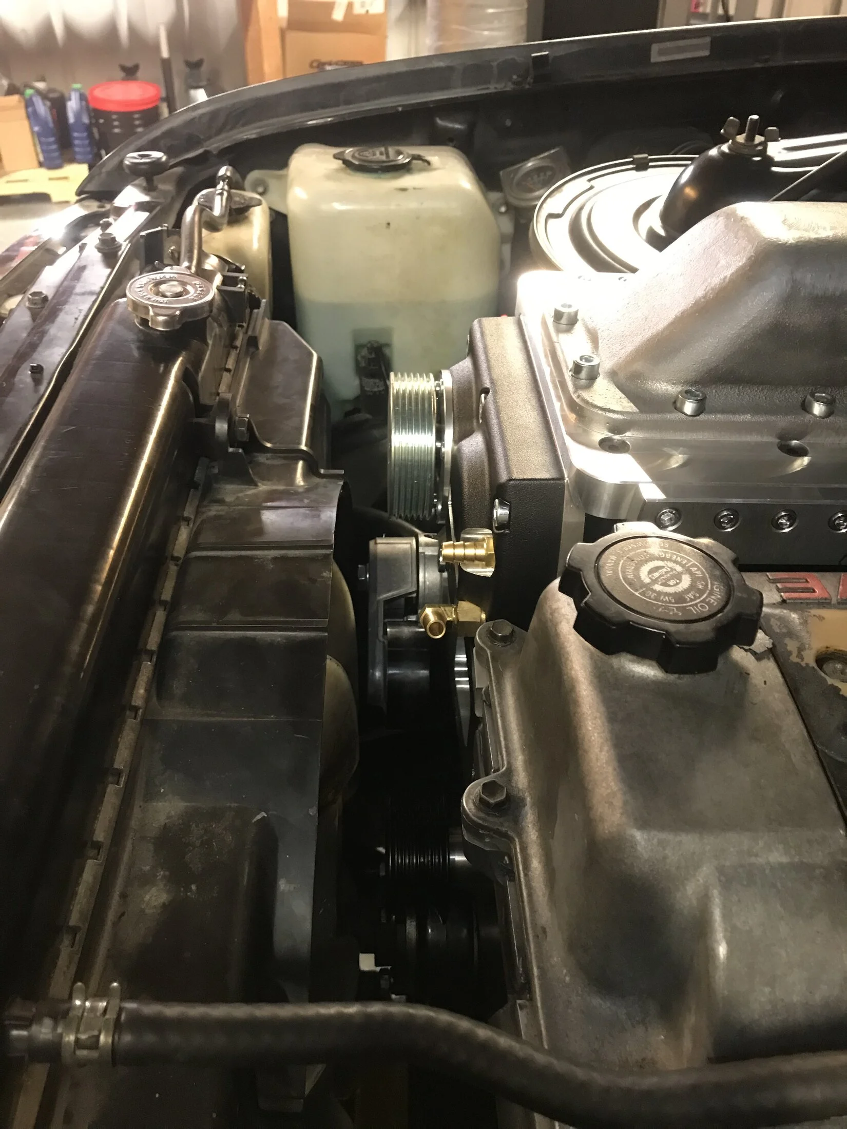

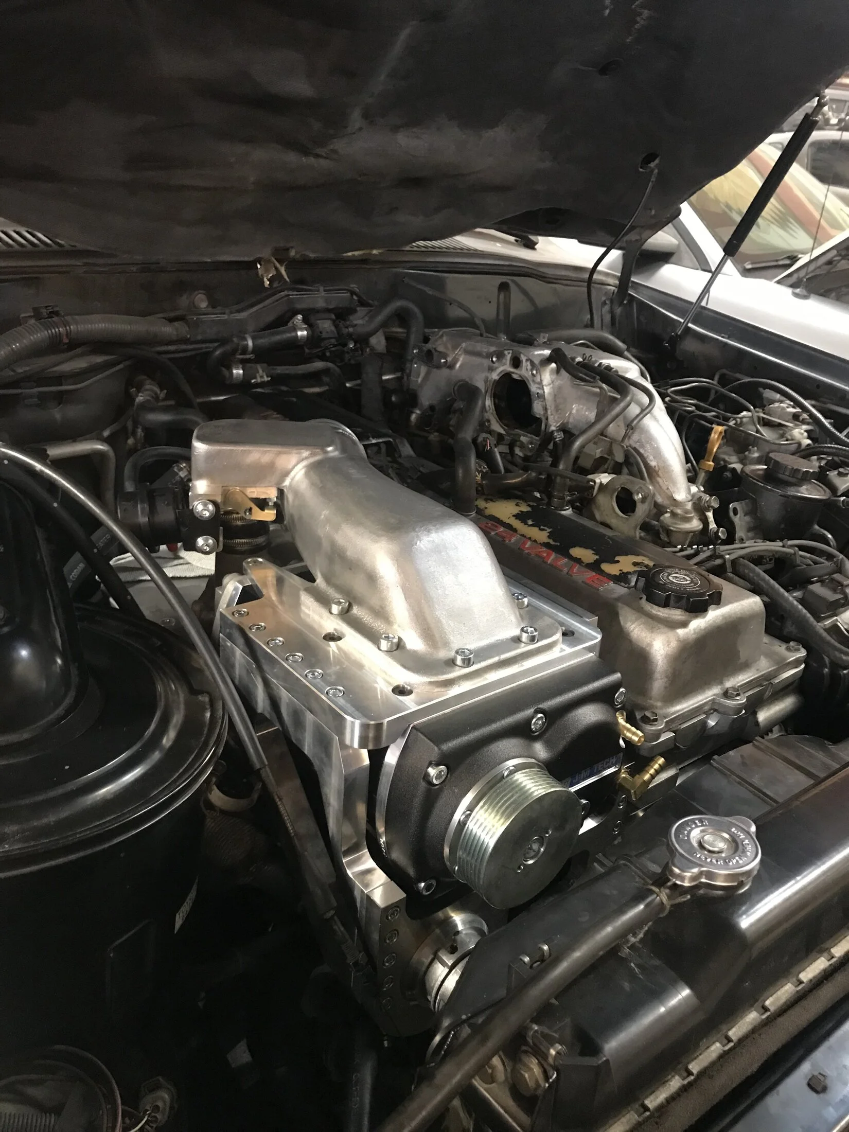

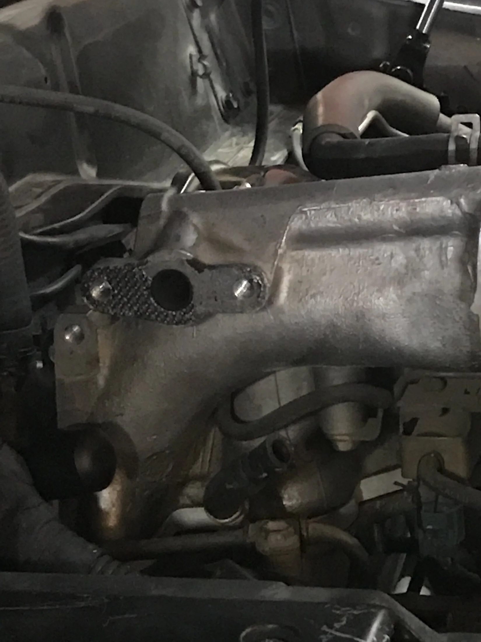

I’m in the process of installing this kit. I’m about to make a block off plate for the egr on the intake manifold but realized I need a boost source. Can I use that hole and make some kind of plate with a port on it? I assume I could since it would see manifold pressure. Also here are some pics
Recommend installing a EGT and coolant gauges. EGT changes fast if you are lean and you can melt the top of the pistons if not careful. Also, I found AFR of 11.8-12.0 keeps ~1400F EGT and watch the low-medium boost while on long easy grades that generates moderate boost for long periods of time and can kill your engine if you don’t have the correct AFR.
If AFR is under control it's very difficult to have high EGTs in a gasoline engine. You'd be much better off with AFR if it's one or the other.
Secondly I'd be looking for an AFR of 11-11.5:1 for a non factory boosted engine with boost.
Thirdly, to the OP, don't forget to go a heat range or two cooler in spark plug. Worked on a turbo FZ a while ago that would usually pull like a train but occasionally fall flat on its face under boost. Needed a good tune up as well so replaced spark plugs with what we would normally put in a turbo FZ, 2 heat range cooler copper NGK's and issue stopped. I can only deduce that it was detonating under boost when everything was warm and the knock sensors were pulling timing.
