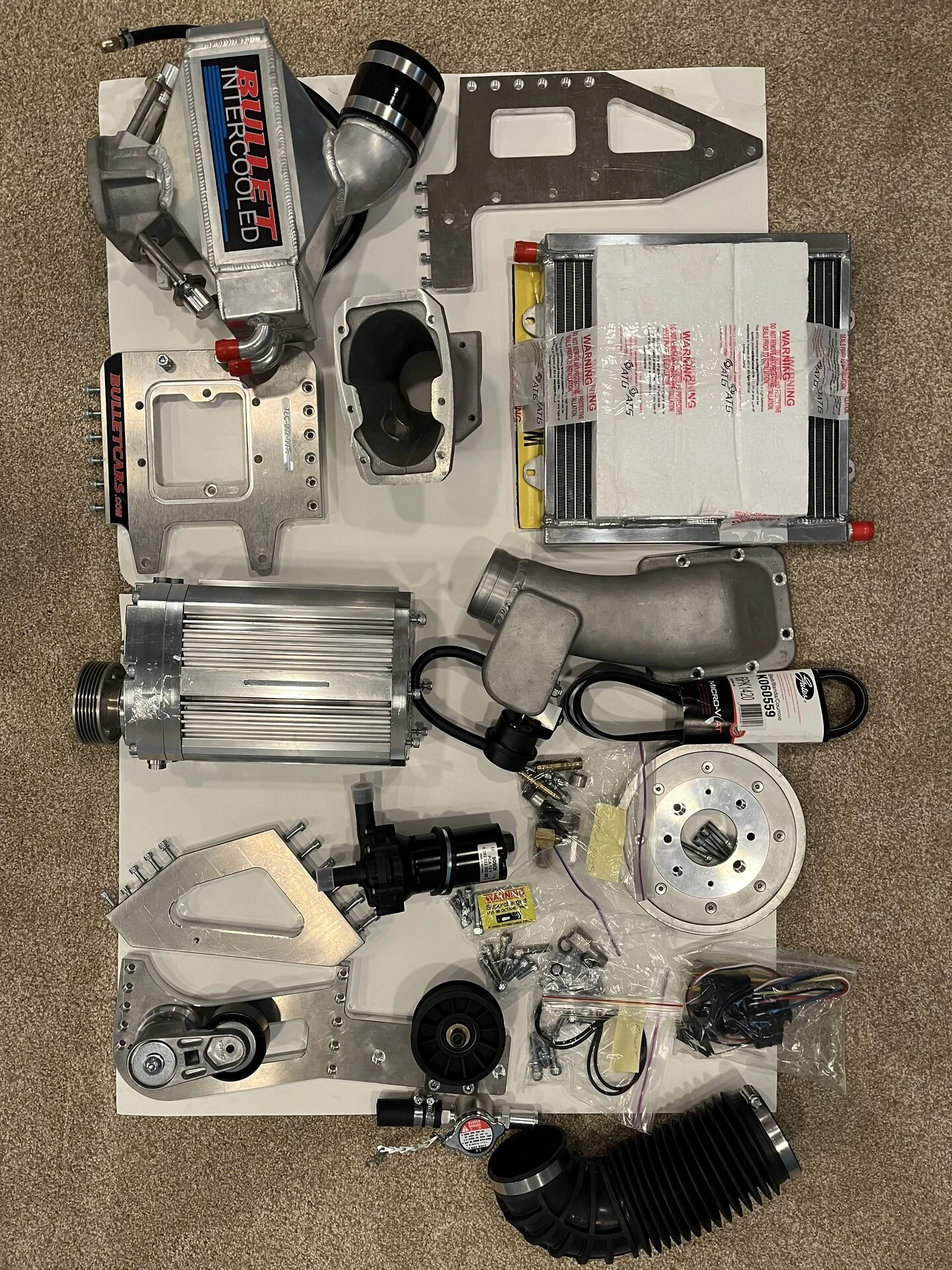

Is this what you’re referring to?
This is my kit for sale. I bought the kit several years ago, but never tried to install it. I decided to keep my 80 mostly stock and bought a 200. I decided to sell it since I don't plan on using it.

I haven't sold it, I still have it. It came missing some of the parts. It was a trade show demo unit and there are a few pieces pieces missing. As far as I can tell, the fan spacer and studs and coolant hoses are missing. I don't have any brackets for the heat exchanger so you'd need to make some mounts.
