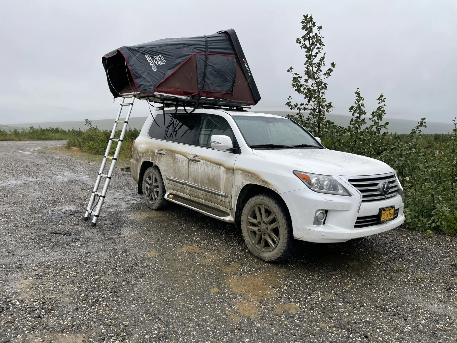

I have an iKamper mini. Really only use it in the fall when bear activity is really high or like this picture when we go up to polar bear territory. And I would not mount it to the OEM bars. I have mine on the OEM rails (which I have switched from LX to LC rails) with yakama round crossbars and rail grab feet. I think this set up is way more versatile and practical than any of the Safari racks I haul everything you can imagine up there. Crossbars go on and off in five minutes. Here is a picture well above the Arctic Circle from when I had the LX rails with the RTT.
Beautiful!
I saw your pic on from the other thread.
Very nice... might have to research on that cross bars.
