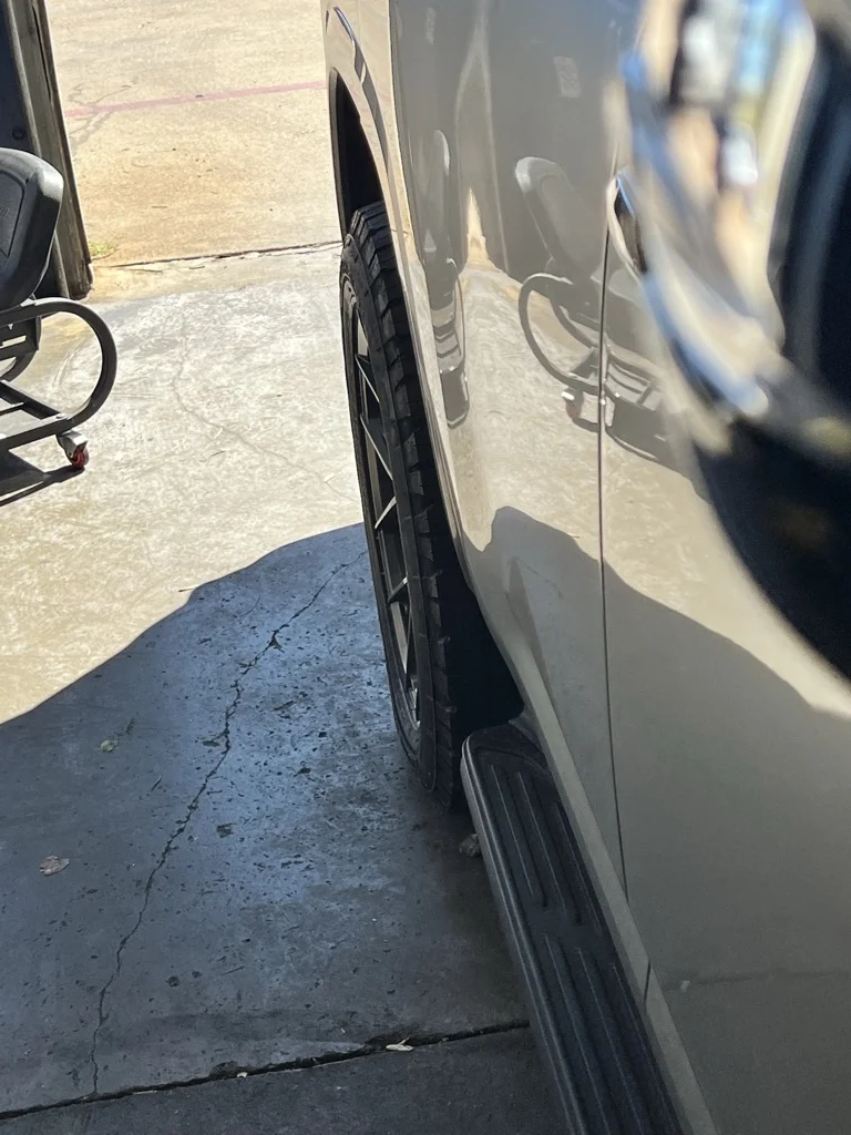

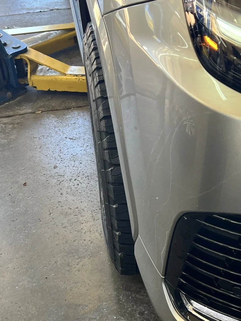

UPDATE: I gave the Vossen HF6-4s 30 offset a try. I installed Continental Terrian Contact A/T 275/55/20 on two wheels and mounted them to see how far they stuck past the fenders. There was some slight poke (see photos) but not as much as I expected.

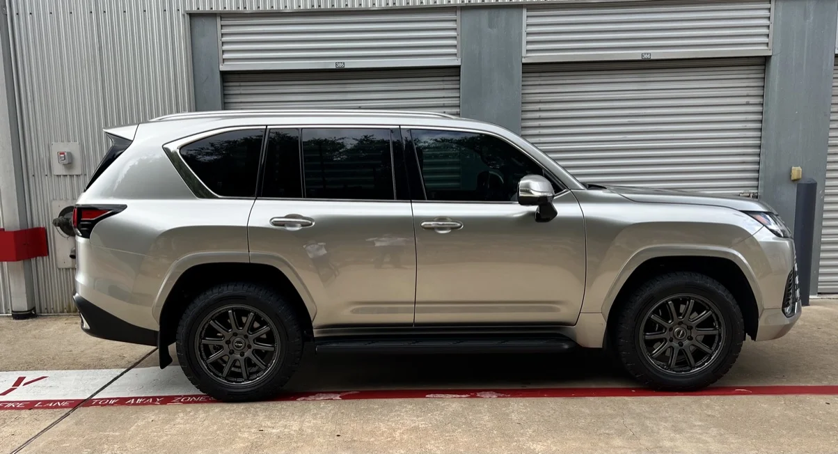

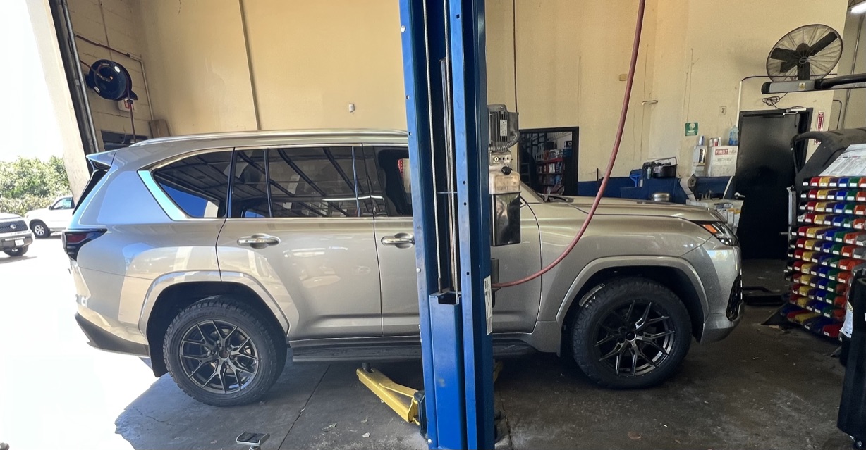

I then asked the tire shop to mount the Continental Terrian Contact A/Ts on the JAOS 20-inch wheels with a 55 offset. The JAOS Tribe Cross wheels fit perfectly and did not stick out past the fender. I could have gone with a 285/55/20 tire, but Continental doesn't make this tire in that size. I spend about 90% of my time on pavement, usually in light mud and gravel when off-road. Therefore, I didn't need to go with an aggressive all-terrain tire. My goal was to keep the ride quality as close to stock as possible.
I am pleased with the fitment of the JAOS wheels. JAOS only offers the wheels in two colors: Matte Gun Metal Metallic and Titanium Gold. The Matte Gun Metal Metallic is darker in person than shown on the internet. I prefer more of a BMW Silver Color and wish that would have been an option.
