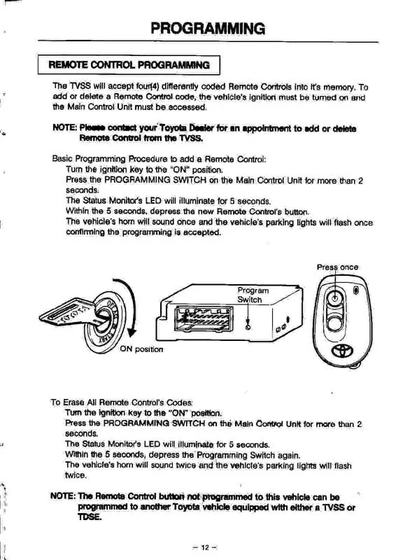

attachment.php
The remote fob is available from the dealer, Toyota is cheaper. Programing is easy, somewhere I have the whole RS3000 manual.
I think I'm going to need some help. Where is the main control unit? I opened the fuse cover and found the plug shown above, but mine doesn't have a programming switch nect to the plug? am I in the wrong place? Any help on this Kevin?
