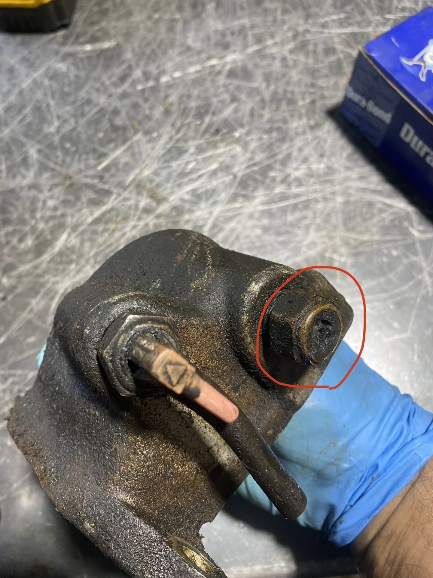

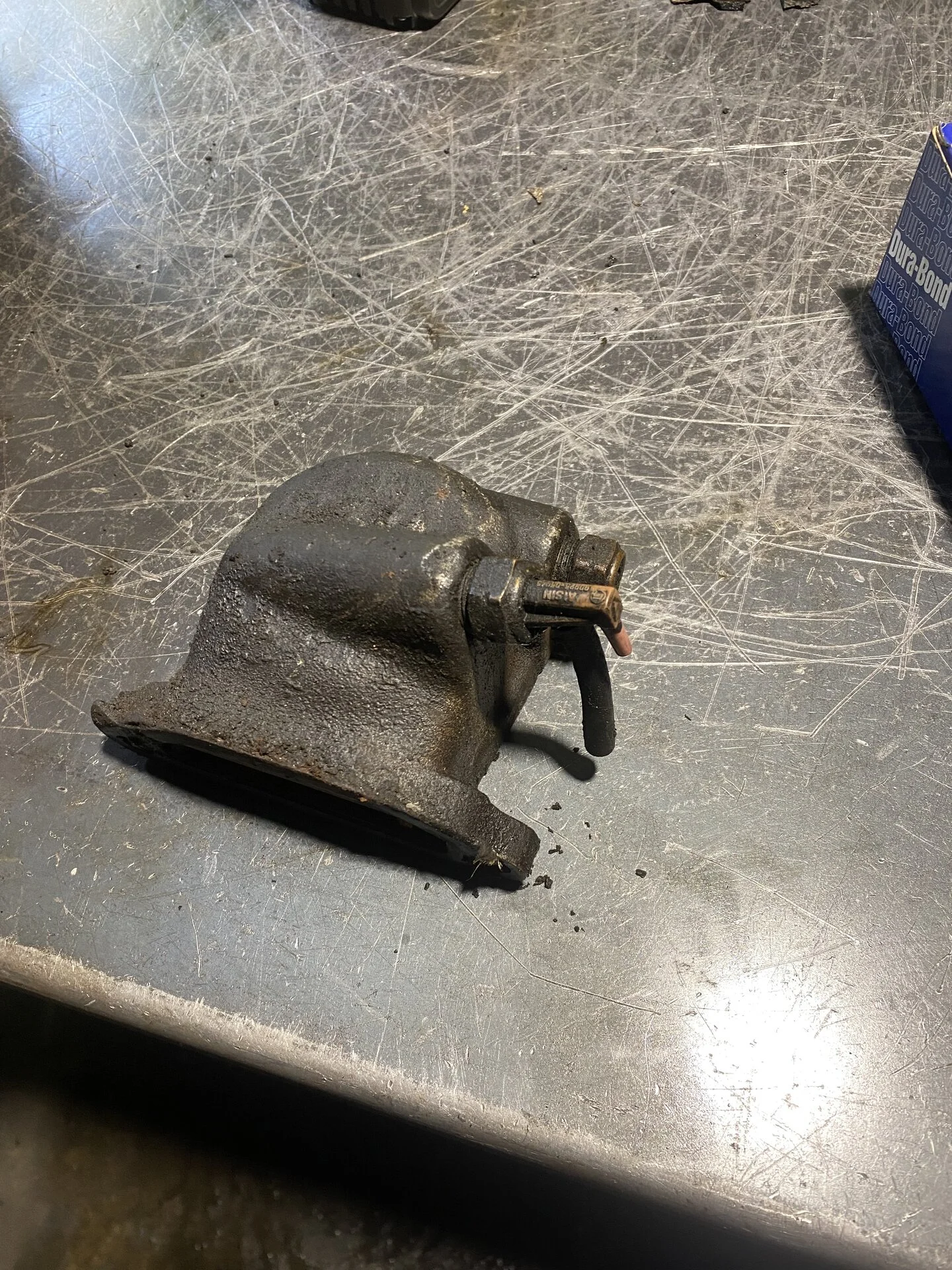

Rebuilding a 2F motor in a late ‘85. In the lower thermostat housing there are 2 sensors. One is a switching valve and the other I thought was a coolant sensor, but doesn’t look like the replacement parts. Anyone know what this sensor is?
While removing this unknown sensor, the thread pulled out of the housing, so now I need a new housing. In the earlier model 60s, the therm housings do not have these sensor ports. If I am planning to de-smog, do I need either of these two ports?? I’m not exactly sure what function the switching valve has.
I can get the earlier model housing but the later ones (with the sensor ports) are not avail.

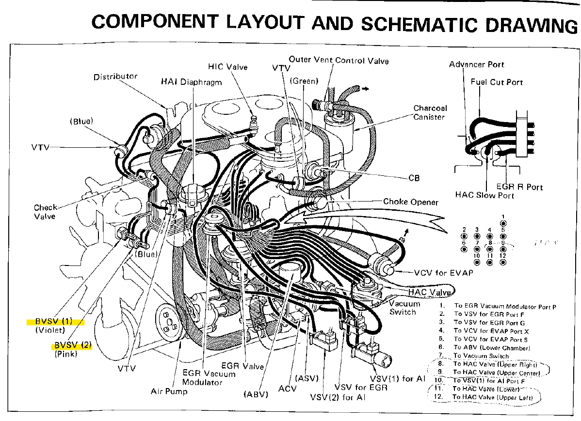

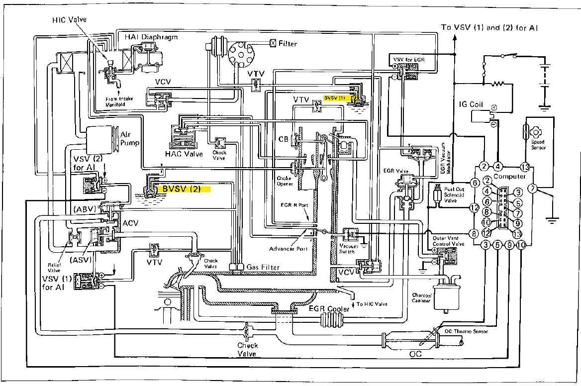

It looks like the broken one is the BVSV 1. In stock configuration this BVSV is used for the vacuum advance of the distributor as well as purging the Evaporative Emission Control (charcoal canister) into the intake manifold during engine operation.
The other one, BVSV 2, is used for the choke opener system. This opens the choke plate when the engine is warm to lean out the mixture.
You will have to wait for input from someone that knows desmog how the distributor vacuum advance is worked out. Technically you don't need the EVAP system but you don't have to eliminate it either. I suppose you don't need the choke breaker if you can remember to push choke knob in when the engine warms up and it starts running poorly.

The standard desmog keeps BVSV 1 (top, broken in your picture) and runs one vacuum to the EVAP valve on the driver's side fender and one to the EGR port on the stock carb.

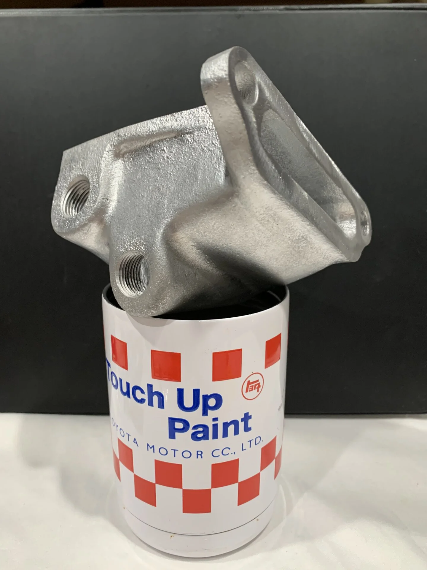

who told you the 2F lower Thermostat housing with the Double BVSV ports is not available ?
there in-stock in my Vintage Teq Parts Dept. .... :cool: 💥

Sorry for the late reply. I had actually been on your website before after finding an older post here from you on this part. But I cannot find it on your website. Where do I need to look? I’m not finding it when searching for thermostat.
- i do not have these listed on the store , because there a professionally restored unicorn special request needs parts topic , on a case by case basses as well
