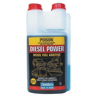

    G'Day Fella's,
    2wheelbob, this is what I have been adding to my fuel (Chemtech Diesel Power), for over 300,000 kms.
    Getting 10+ liters of it for free, certainly helped convince me to use it.
    Hope that helps
    D'oh!
    Homer
