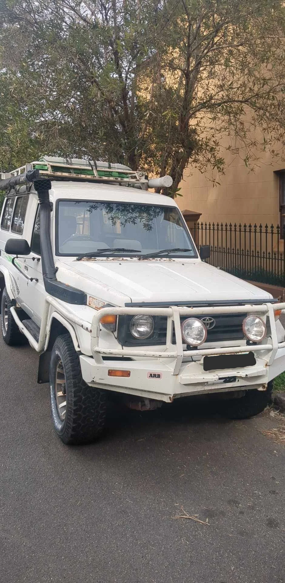

Recently inherited my old man's 1996 HZJ75 troopy. It was in a bit of disrepair when I got it, but I fixed a few things up and took it to the mechanic and asked for a compression test. All cylinders are at 300-320 psi. Manual says this is well below limit (384 psi?), mechanic says "about the limit for what we would call a ‘healthy’ engine".
So, is 300 psi on the verge of dying or just being unhealthy? And is the best path forward to get a engine rebuild and the cylinders rehoned?
Cheers for any advice.
