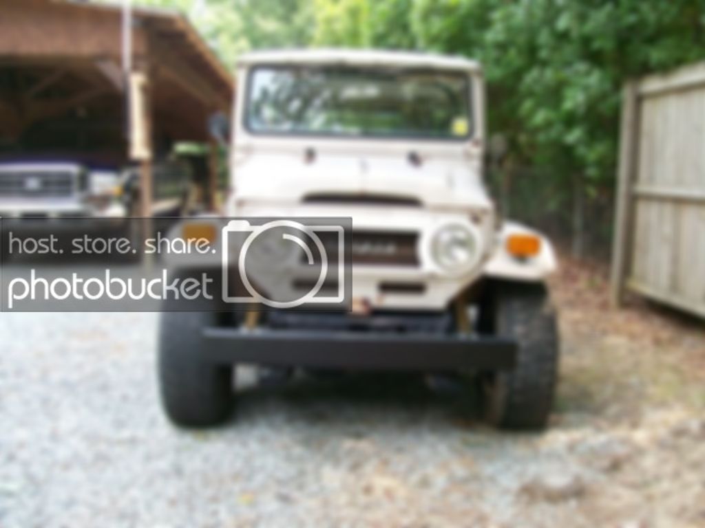

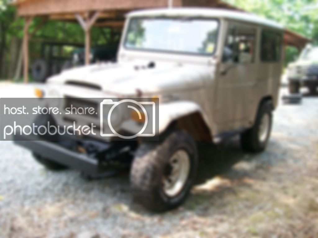

Fortunately, the ONSC club members helped us out and we were able to find a nice "rolling project" in a '71 FJ-40 from R.K. He had a potential buyer get a bit "iffy" and let me know it could be available. We drove up today to check it out and decided to take it on as a project.
My daughter is beside herself. It sure doesn't help with the negotiations when one party is so giddy with excitement that they can't contain themselves. Then he had to look at my daughter...

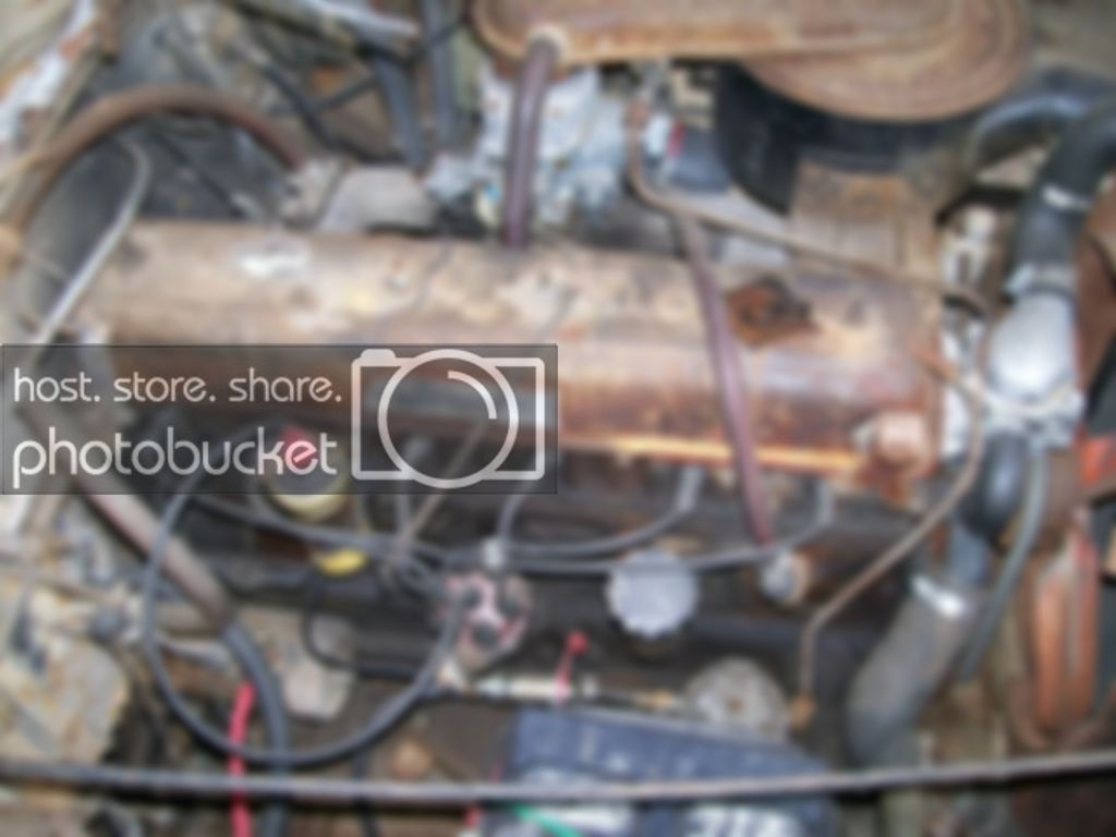

Its a sound rig, needs a few things to get it road worthy, a couple more to get it road worthy for a teen-ager but we have through October for our time frame to make that happen. Hopefully, I'll be able to take advantage of all the knowledge in this group to help me grow up from the ease of bolt on mods of my FJC to actually having to work on a vehicle, I might even have to get dirty.
First up will be troubleshooting the lighting since I've got to get the headlights and driver rear taillight working. Then, I've got to rig in some 3 point seat belts and get some fresh shoes installed on the original wheels. Next would be doing the disc brake conversion, power steering modification and relocate the transfer case shifter to the floor.
That will be good enough to get her relatively safely driving on the road. We can then start tackling the cosmetic issues while she is able to drive it back and forth to school, swim team practices, little sister shuffle duty, etc.
But, I fear that I have stepped onto a very slippery slope, one which I fear will pick up speed quickly...

Here is a link to R.K.'s photobucket page with the pics but I'll link up a few now...
