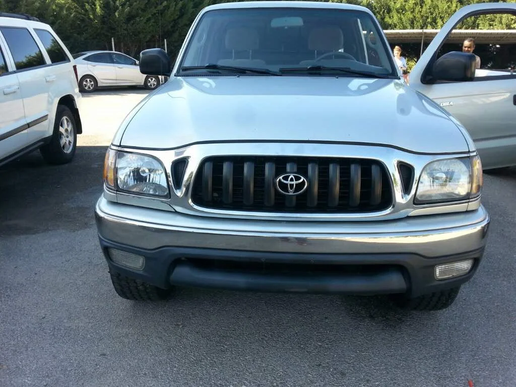

Hi there
Been a toyota fan and we own 3 in the family.
Considering a Tacoma pick up to haul stuff around and occasionally will be on snowy roads and dirt roads.
Should i go for a 2003 or the newer model 2005 ?
Insisting on a manual and Xtra cab.
I believe the 2005 have better seats and roomier. What about reliability ?
Most of them in Lebanon are imported from US with 100 k miles +
I found a 2003 with 108 k miles but V6.
I was told the early i4 is just as good and better on mileage.
Will the I4 be significantly better on gas mileage ?
Pls advise.

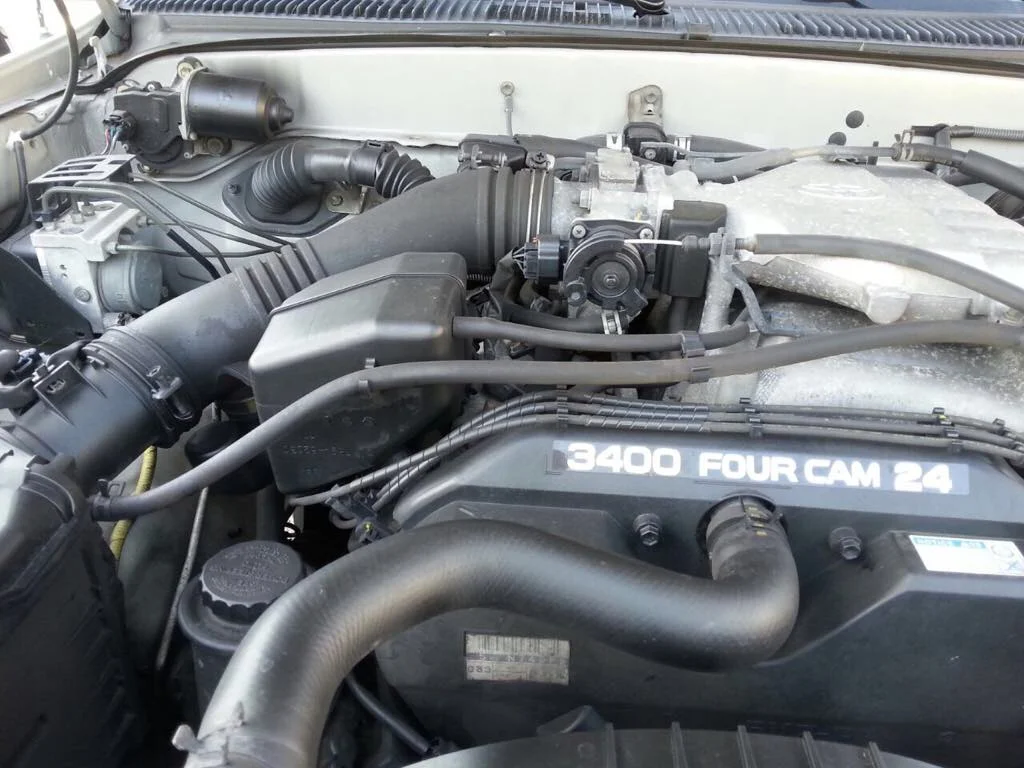

Hi there the 2003 Tacome TRD V6 has 254 k miles as per Autocheck.
Looks like it was rollled back when exported. Autocheck report is clean.
I guess too high and probably will need engine refurb soon.
Pls advise ?
Should i avoid gen 2 2005 ? Read 2005 is a strange year for Taco s with all the changes.
Truck will mainly be uses on road with occasional off roading / trailing.

Both the V6 engines (2003 and 2005) and proven solid, but any truck with 200+ thousand miles is going to need some attention. I don't think a full overhaul should be expected, but you'll have to check on serviceable things like timing belt, water pump, throttle body, ball joints, steering rack, wheel bearings, clutch. The 2005 was a new model year for the Tacoma, but not the 1GR engine, so the issues were in other areas like frame/body mount issues, ring and pinion failures, 6 spd tranny problems (throw out bearing?) and maybe others I've forgotten. But a lot of the issues were with folks who wheeled hard and so understanding the history and usage of the truck would be important.
My feeling on the 4 cyl versus 6 cyl is that the gas mileage differences aren't significant enough to outweigh the advantages of the V6 power and torque. Seems like it's only a few MPG difference between the engines.

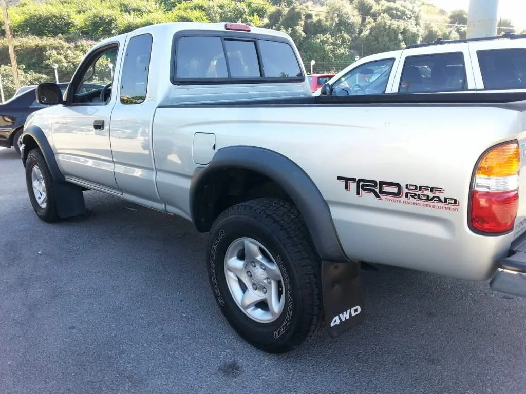

I ll be going with a V6. Is a TRD worth it ? I guess it comes with small lift and e locker.
Anyone knows where the e locker switch would be located on 2004 Tacoma V6 ? Asking as I am on travel and a close friend is checking the truck for me.
Jay
Button just left of the stering column says diff lock. Make sure it works. Easy enough to just install a button/place TRD stickers on a rig.

Is a TRD main difference in the rear locker ?
Would a V6 in a 2003 have significant more power over an I4 ?
The 95.5-04 trucks have a 150 horsepower 4 cylinder and a 190 horsepower 6 cylinder. Second gens are I believe 158 horsepower 4 cylinder and 236 horsepower 6 cylinder. If you're hauling stuff, putting bigger tires on, or towing the V6 is worth it for sure. If you like to pass people from 50-70 MPH a six cylinder is a must. But the 4 cylinders are pretty torquey and perfectly fine for most. I actually put a set of shocks in a friend's 02 regular cab last weekend and I drove it about 50 miles. Went just fine. I put 100k on a second gen 4 cylinder I bought new and loved it, especially the gas mileage. But passing at speed required downshifting 2 gears. There are some early tacomas with lockers that aren't TRD models too. But they are rare. On a first gen it's pretty easy to swap the locker in afterwards if you don't have it. On second gens the whole rearend housing is different because they used the same 3rd member for the lockers as the first gens. Second gen non-lockers have a beefier rear. But on second gens you could get an optional limited slip (mine has this) also in the larger rear.
