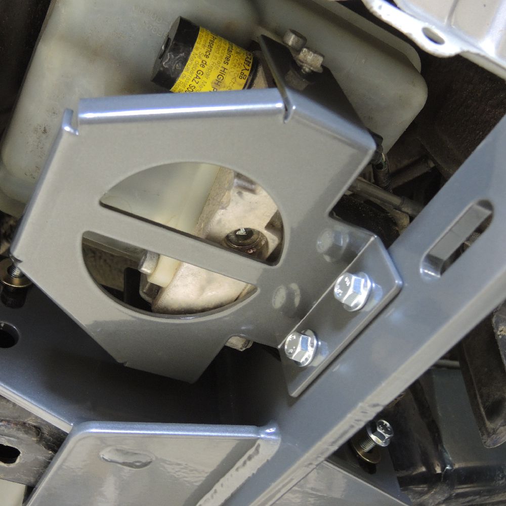

Not a Dissent, and I just finished my ARB rear bumper last week... well, 98% finished. The 2013 rear quarter panel reflectors are not exact fits for the bumper swing arm covers, which i knew going into this, but I am happy with the ARB bumper. I also need to drill holes for the Buck up sensors. (I am ordering the Spare Tire Carrier and Gas Can holder soon) my only gripe about ARB is their silly cage nuts... they use them on everything...
Not a Dissent, and I just finished my ARB rear bumper last week... well, 98% finished. The 2013 rear quarter panel reflectors are not exact fits for the bumper swing arm covers, which i knew going into this, but I am happy with the ARB bumper. I also need to drill holes for the Buck up sensors. (I am ordering the Spare Tire Carrier and Gas Can holder soon) my only gripe about ARB is their silly cage nuts... they use them on everything...View attachment 3313974

oddly enough, I did not have to touch the AHC. The ARB bumper does not get in the way or require you to move the AHC resi etc. I did have to remove the spare tire, spare tire cranker thingy, metal tire holders, and cut out some metal bars welded to the rear frame, and for giggles removed the resonator... but that was no biggie.

The ARB bumpers don’t have the same style wing supports. It’s just a thin bracket that holds the wing and clears the pump.
Yeah, I wasn't happy about those wing brackets when I was installing, I felt like I was being hoodwinked by ARB. LOL
Plus they are wonky when you are trying to install them and level them and line them up with back bumper. (actually used a level)
But supposedly they are replaceable if the wings get damaged??? But I am happy with the bumper... so far.
