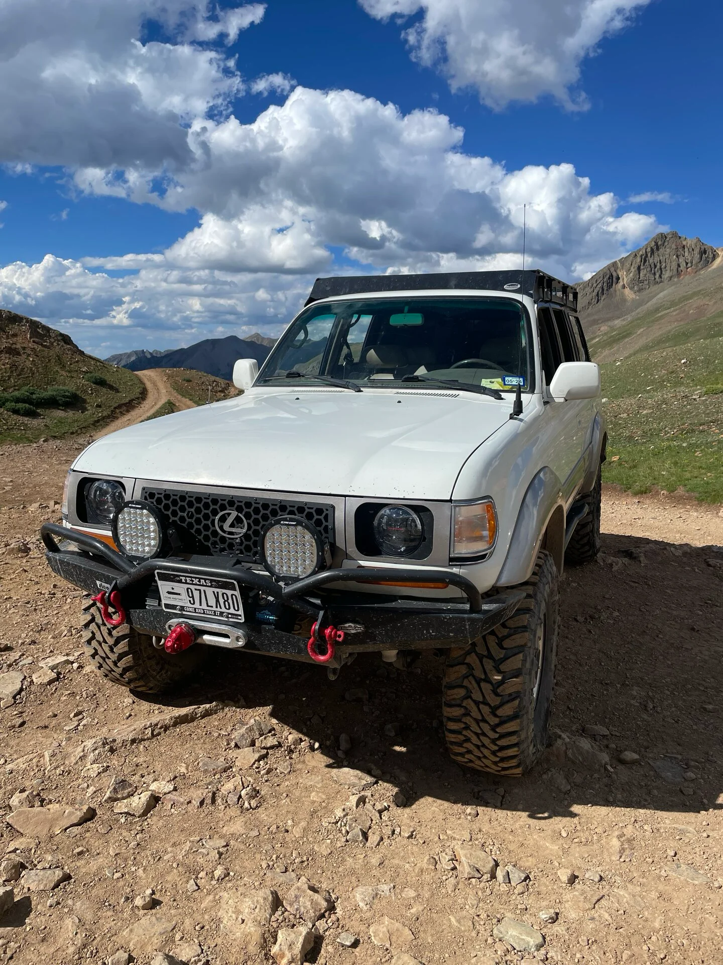

Looking for the brightest, widest coverage headlight aftermarket replacements, period. Cost is not an issue here...
Jun 13, 2011
39
576
Flagstaff, AZ
It's dark out here, and I'd like to have some bright, non-blinding headlamps so I don't have to activate the aircraft landing lights...

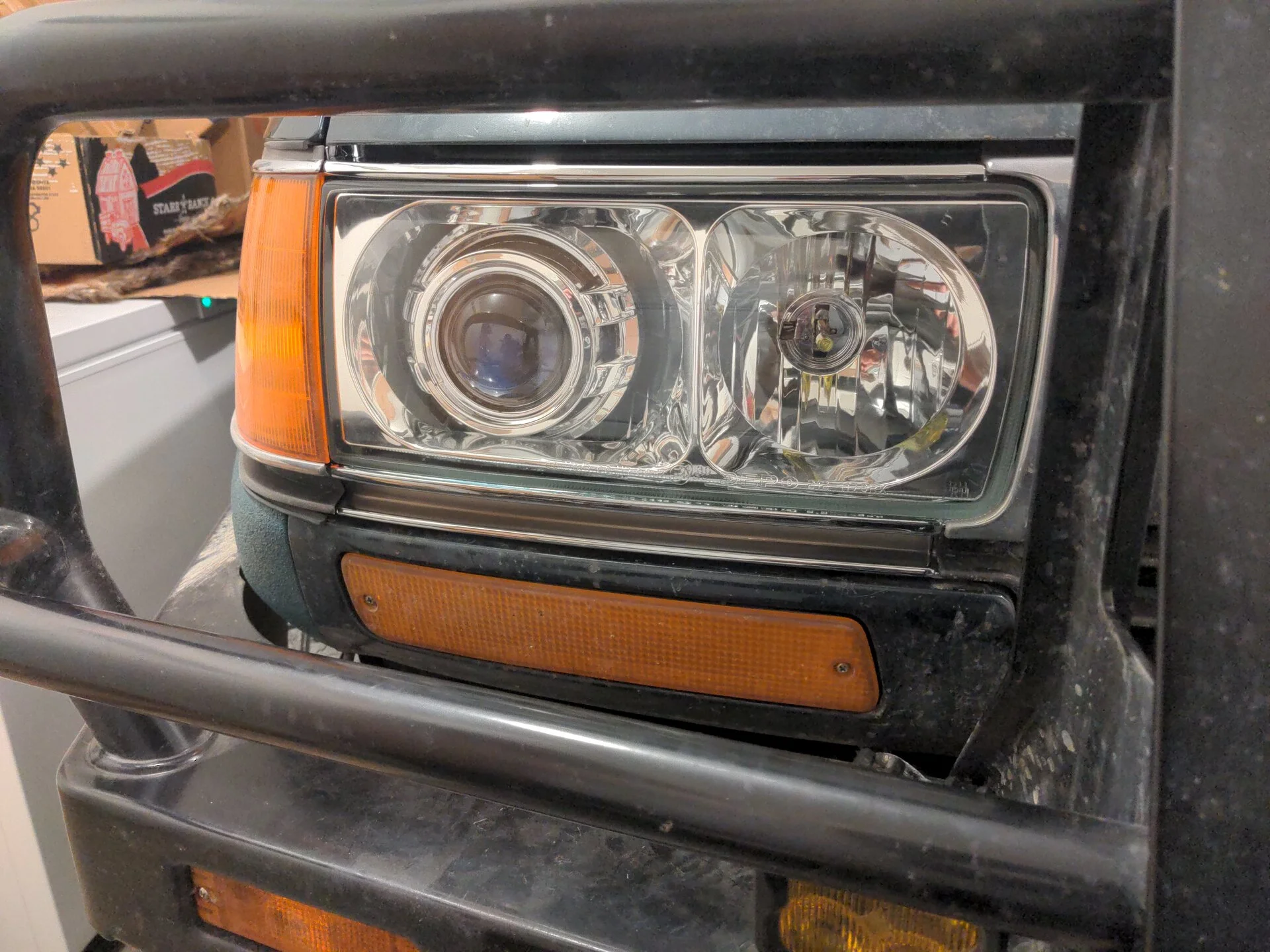

I’d be reading up on the retrofit options for projectors in depot housings. Believe there are a still a few people offering to assemble the packages and sell plug and play.
In my *very* limited experience, projectors are the best option for these old rigs. Get a clear lens housing like a Depo and graft whatever Morimoto projector model that will fit into them. A LED setup would be great, but the reflectors are wrong, so the scatter is horrible.

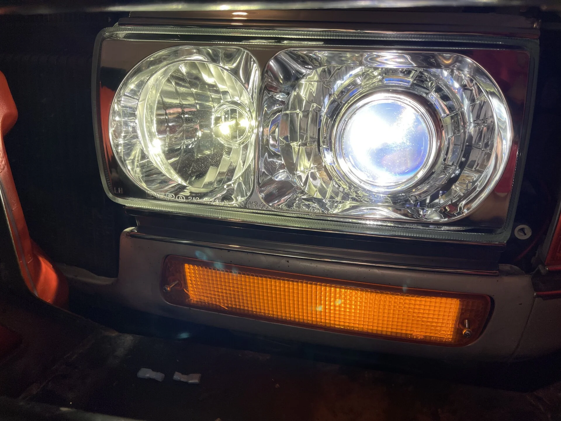

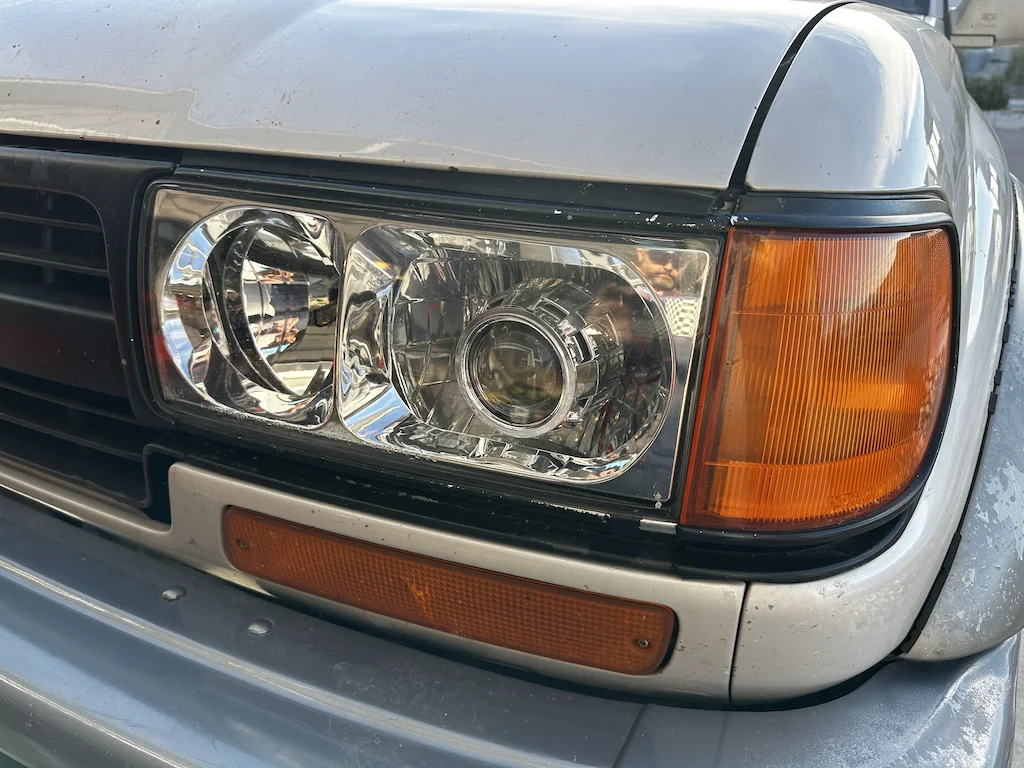

I did H1 projectors with cheap H1 xenons/slim ballasts into a set of Depo headlights over 10 years ago, they're still doing great. I've gone through a few ballasts but the cheap Chinese Xenon H1 bulbs are still original and I just keep a pair of ballasts in my spares box. The retrofit itself is super straight forward once you take the Depo glass lens off the housings.
These are pretty much exactly what I used, I'm sure you could do higher quality with Morimoto or others, and I've always intended on redoing mine, but mine just keep working.
H1 Projectors
Slim 4300K Xenons
Depo housings and morimoto d2s mini projectors. Pretty easy to install. Took one evening per headlight. Check out theretrofitsource.com

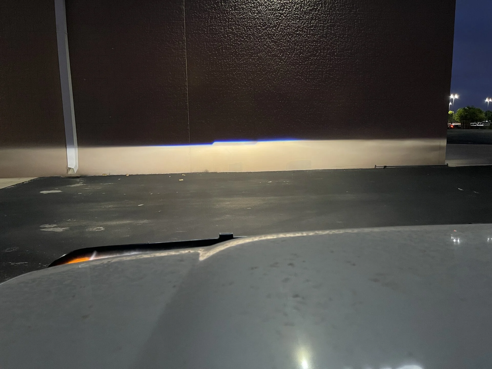

I doubt there is a better solution than high quality projectors for low beams. Its the dark season in AK and I like the output while not blinding traffic. The high beams are just silly bright.

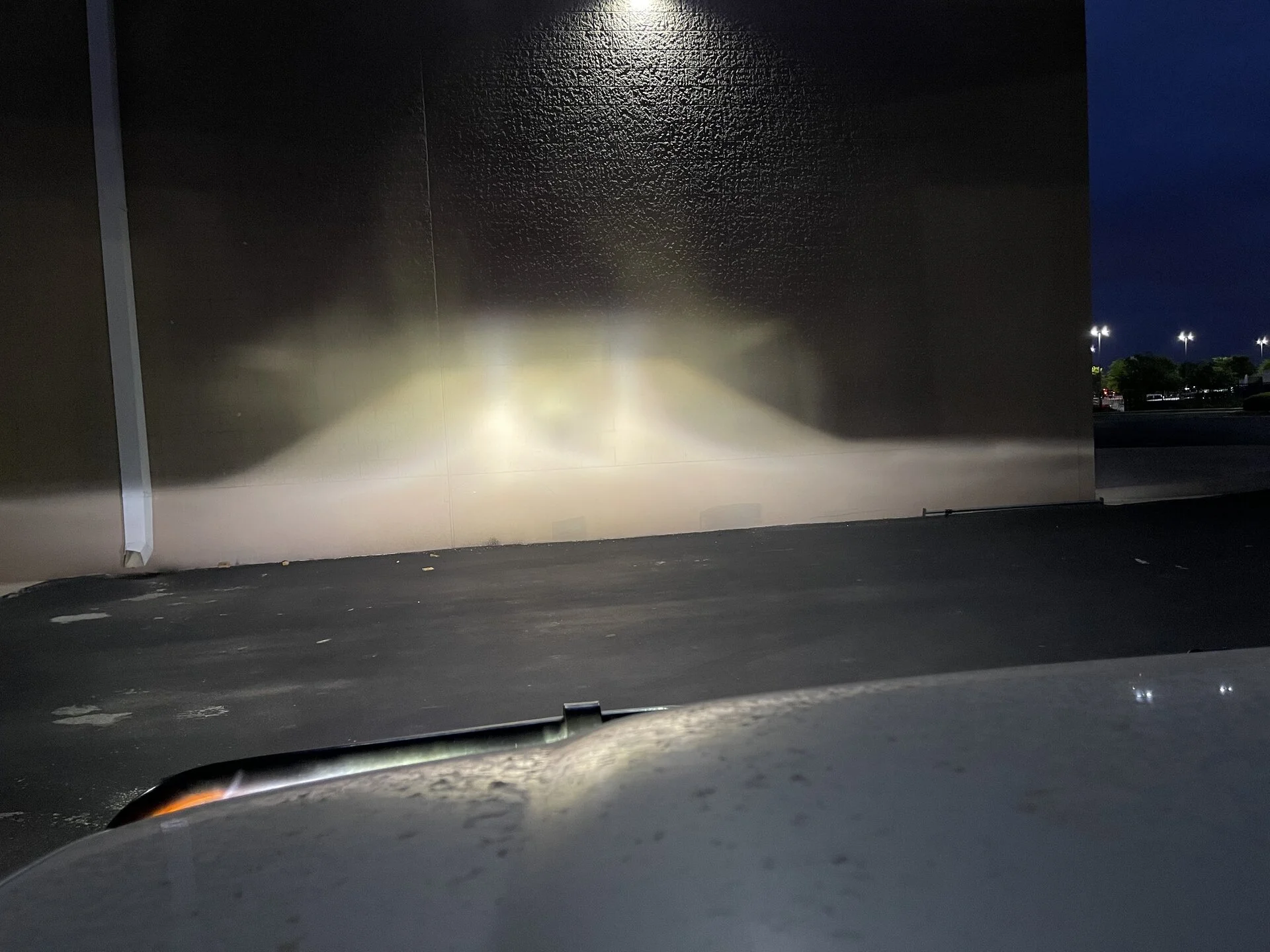

7 inch round headlights will likely give you the most options. Truck lights and jw speakers are some of the most preached. I run marimoto 7 inchers and I like them a lot. However I have good night vision so I never run my brights. Also my cutoff is adjusted very low.
If you struggle to see at night then you might try to turn down interior lights. Make sure both headlights have the same cutoff height and keep it just below the average side mirror of people infront of you at say 30 feet. You don't need high beams ever if someone is in front of you anyway. Then when it is just you. Your high beams will have a very long throw.
