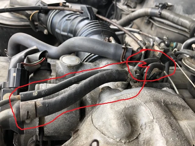

I will be replacing valve cover gasket and these 4 small hoses are original and I am afraid that they are so brittle and I won't be able to reuse them.
Attached is a picture showing 4 small hoses. Looking for part numbers for them. Thank you in advance

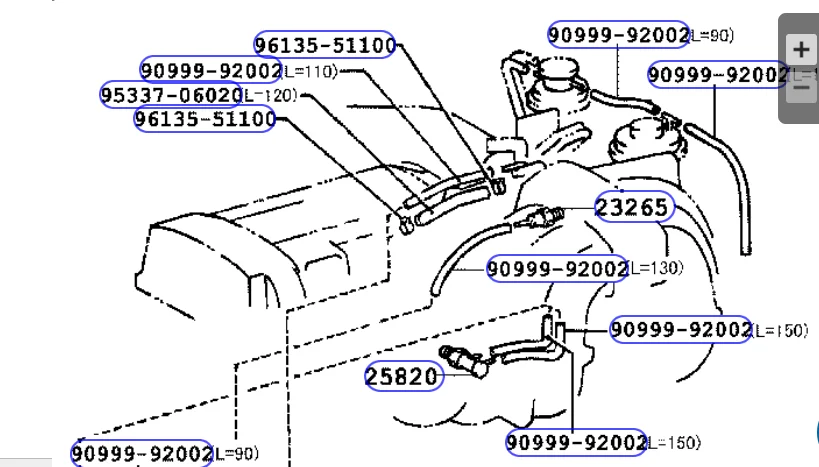

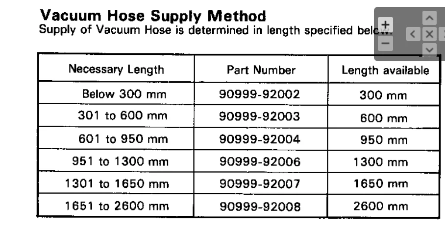

FWIW, I always buy the longer 90999-92004, which give s me enough length to replace all the vacuum lines at once, with a bit left over. It's pretty cheap, even at retail.
These are the parts Onur referenced, just so you know what goes where, not that you could mix them up...
If the hoses you can see are hard and brittle, ask the hoses you can't see under the intake are hard and brittle too.
Now is the time to refresh all the coolant hoses, all the vaccum hoses under and around the manifold.
