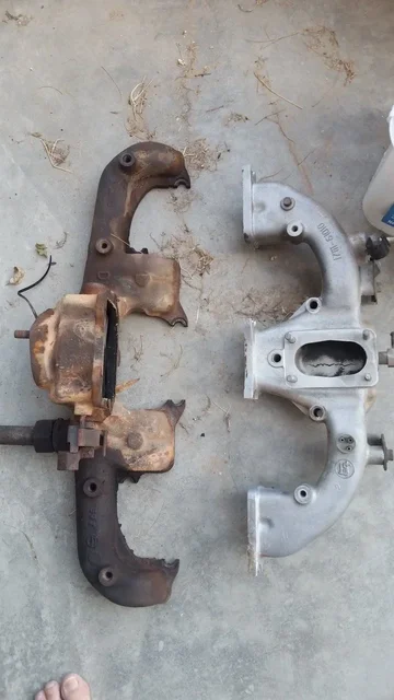

I have been off the radar for awhile, but have a shiny 1975 FJ-40 in my garage getting some motor love.
Check out the split intake. Exhaust is warped as well. I already put the feelers out in the classifieds, but am posting here too because this is my back yard. :)

Hard to find off a 2f and not warped. cruiserparts has trued assys with new gaskets but pretty pricey.
What about a machine shop that will alumaweld the crack then has the machinery to plane the combined intake/exhaust assy together. I know of a place, I'll look up the name when I am at work on Monday.
