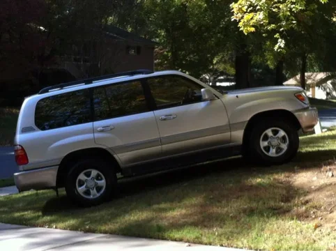

I found this 99 100 series local a couple months ago and so far it has been great. Rear locker and sub 150k w/ full service records.

Awesome deal. Nobody around here would budge on price At all. She got that at like 60% of blue book.
