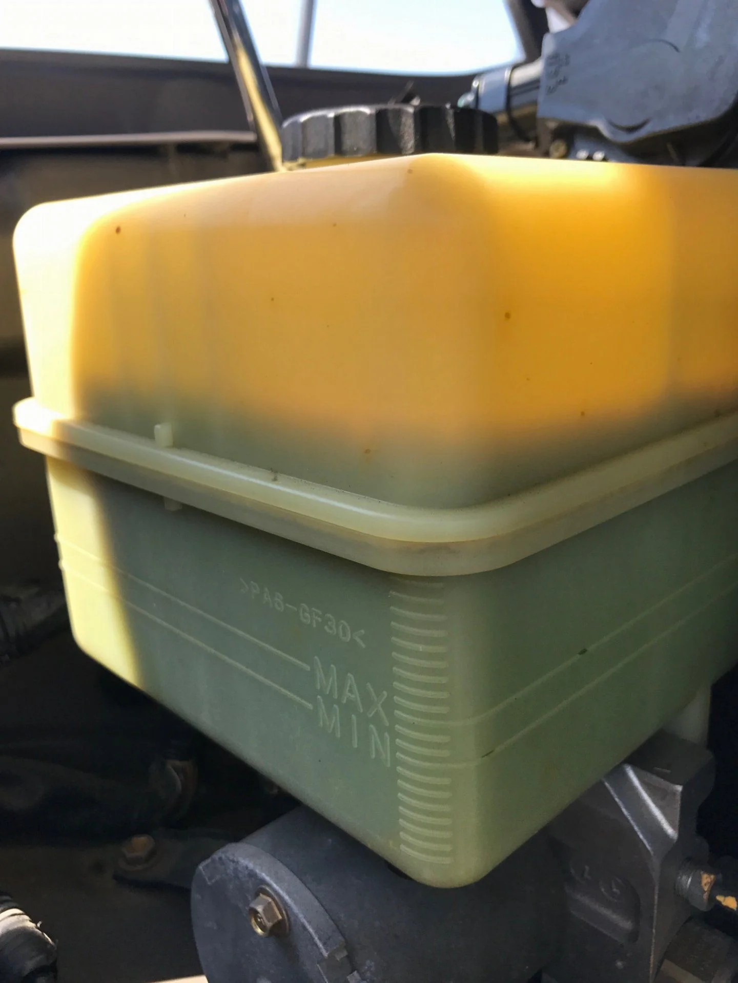

So we went and looked at a 98 LX today with under 200k. It was in great shape for the age, and was owned for the last 150k by the same owner...but was bought at auction and has no maintenance records. Carfax is clean, but has almost no maintenance on it...and the VIN was coming up as an error on Lexus.com. Everything looked pretty good, or as you'd expect, but I have a question on the AHC (big surprise, right?). The reservoir was WAY overfilled. Even at HI it was well above the seam. It raised and lowered relatively easily (from what I've read on here), but doing the graduation test was tricky. I took pics at HI and LO, but the hood struts were wore out so I don't know if you can tell. Anyone have any idea if A) having an overfilled system would cause damage, or B) if the amount the fluid level seemed to move looks like ~7+ levels?

No, the system being overfilled will not hurt anything, the system is not sealed so any true excess will have leaked out of the weep hole in the cap, same with power steering, brake fluid and coolant.
If somebody "topped" it off with say... brake fluid. That would definitely cause damage and won't be obvious at first.

Why is is overfilled is the worrying thing, the AHC fluid isn't something you just have in your garage. Did the PO comment on this? Someone must of worked on it.
Can the owner show you a receipt for Toyota AHC suspension fluid? With a reservoir fluid level that's significantly above Max (which isn't a technical issue as such, I run mine slightly higher than Max) it really suggests to me that it's been topped off - but with what? Show me the receipt or work order that lists the right fluid. As damper accumulators age they loose pressure and therefore accept more fluid (fill more) under normal operating conditions. Accordingly, the reservoir fluid level gradually lowers and this might (does) encourage owners and unwitting mechanics to top off the reservoir. Not a problem in itself as long as the right stuff is used.
A '98 with 200k on it, if still running original damper accumulators, will have degraded damping as will a conventional system. Serviceable takeoff accumulators can be had for a reasonable price (I just gave a set away for the cost of shipping) so don't get too hung up on potential dealer replacement costs for these parts. It's also very likely the vehicle's neutral pressure are excessively high, and this combined with aged and low pressure dampers causes poor damping. Neutral pressures are easy to correct with Techstream and flat dampers need replacing which is something to factor in at some point. If the system has been topped off with something other than AHC hydraulic fluid then it's possible the damper accumulators will completely rupture in the not distant future. For example, it's been well established brake fluid eats the dampers internal membranes.
