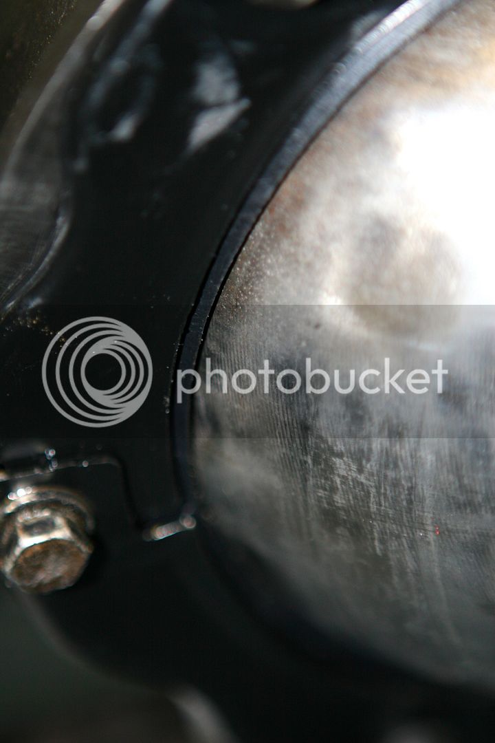

I thought I'd share my first experience with the Longfield Lifetime Wiper Seals, being a relative noob to the world of knuckles.
I've only helped do the knuckle job a HAMOM's and this is the first time doing one on my own. Not being the brightest bulb in the box, I try to make sure I cover my butt by reading twice, doing 3 times, redoing again and finally having someone else come over and fix it for me.
Remembering the order and orientation of the knuckle wiper seals is one small thing I don't mind taking off my mind and using these wipers sure does that. For the FJ-FZJ80, it replaces the felt, rubber and steel ring. Just put the UHMW ring on the inside of the knuckle ball, mount the steel ring/bolts, torque down and it makes an amazing fit.
I can now see the genius in the simple design, the plastic ring will wear/form to the knuckle ball making for a perfect seal. I tried to take some close up pics to share with others who haven't seen them installed...
Can't imagine going back to the OEM set up after using these. I guess a long term test will tell the tale but at on-set, looks like a sound idea/design to me...
Let me know how they work. Have had one request for them, but was the day prior to coming into the shop and it was too late so we went with factory, of which i have never had a problem. I like the factory myself as it lets you know when you get soup.

Will do Darin. I agree that the OEM set up works as designed and isn't a "bad" set up. I'm a simple guy and find that these one step solutions to usually work well for me. That is, assuming it last as long as others have posted on Pirate and ih8mud...

I just installed a set of the longfield wipers two months ago with a front axle rebuild and am happy with them so far.

Ditto. Low mileage - on Dozer... But I think they will prove to be money well spent!
