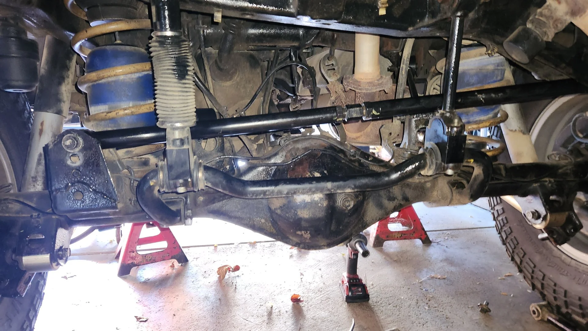

This mine. It already have:
1. KDSS spacer
2. Eimkeith Panhard correction bracket
3. Ironman 4X4 KDSS adjustable panhard bar

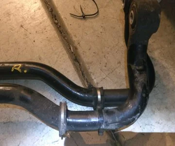

This is the clearance at 26" shock extension. Without Ironman adjustable KDSS Panhard bar it would already touch each other.
Top is GX460 30 mm rear KDSS bar
Bottom is GX470 33 mm rear KDSS bar
As you can see the the passenger side are at different locations. The ironman KDSS Panhard bar totaly at wrong location for GX470 but does not seems it's going to be a problem if you run 1-2" of bump stop extensions.

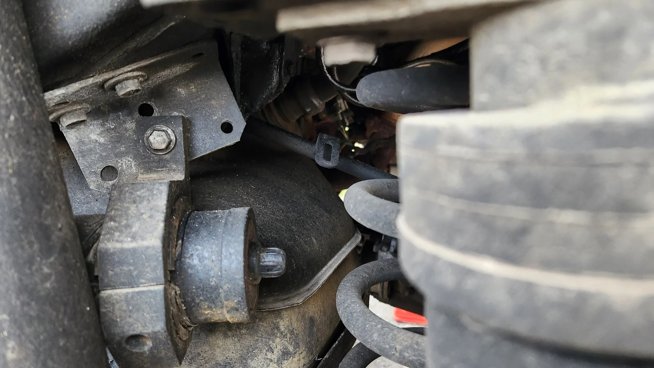

The upper bushing stem are larger. 17mm vs 14 mm and might need to drill the frame bigger.

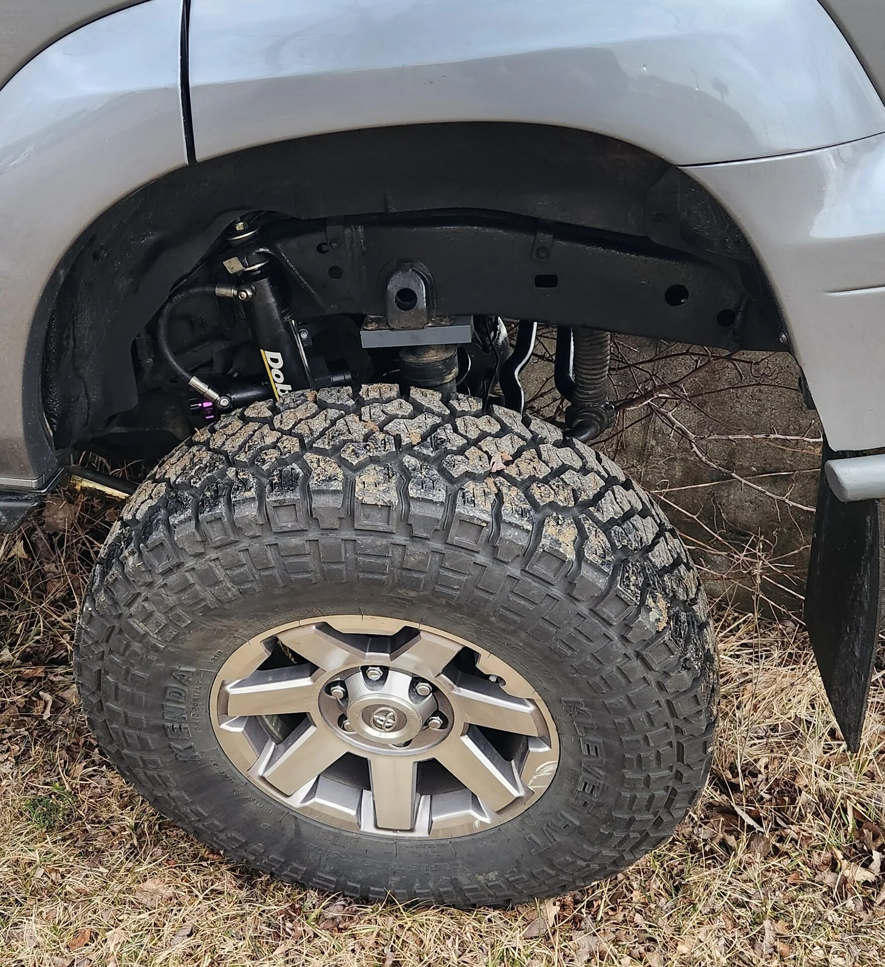

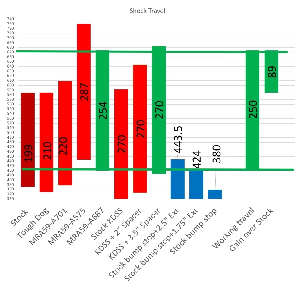

Bought Dobinson MRA59-A687 for 4" lifted Land Cruiser 80 series or 22 Tundra. The are 26.5" long compared to stock at 23" long.
Pros :
1. They come with 3 different set of bushing size and the smaller one fits with no modification.
2. Valving are actually perfect for my truck that estimated are about 5200 lbs. sprung-5600 Lbs. total. Still plenty of adjustment up and down.
Cons:
1. The reservoir bracket are wrong so you need to get different bracket or buy the one for MRA59-A575.
2. Even with Ironman KDSS Panhard bar, Eimkeith PCK and Treaty Oak KDSS spacer it still max out at 25.5" and will destroy KDSS ram. So I need to come up with another solution.

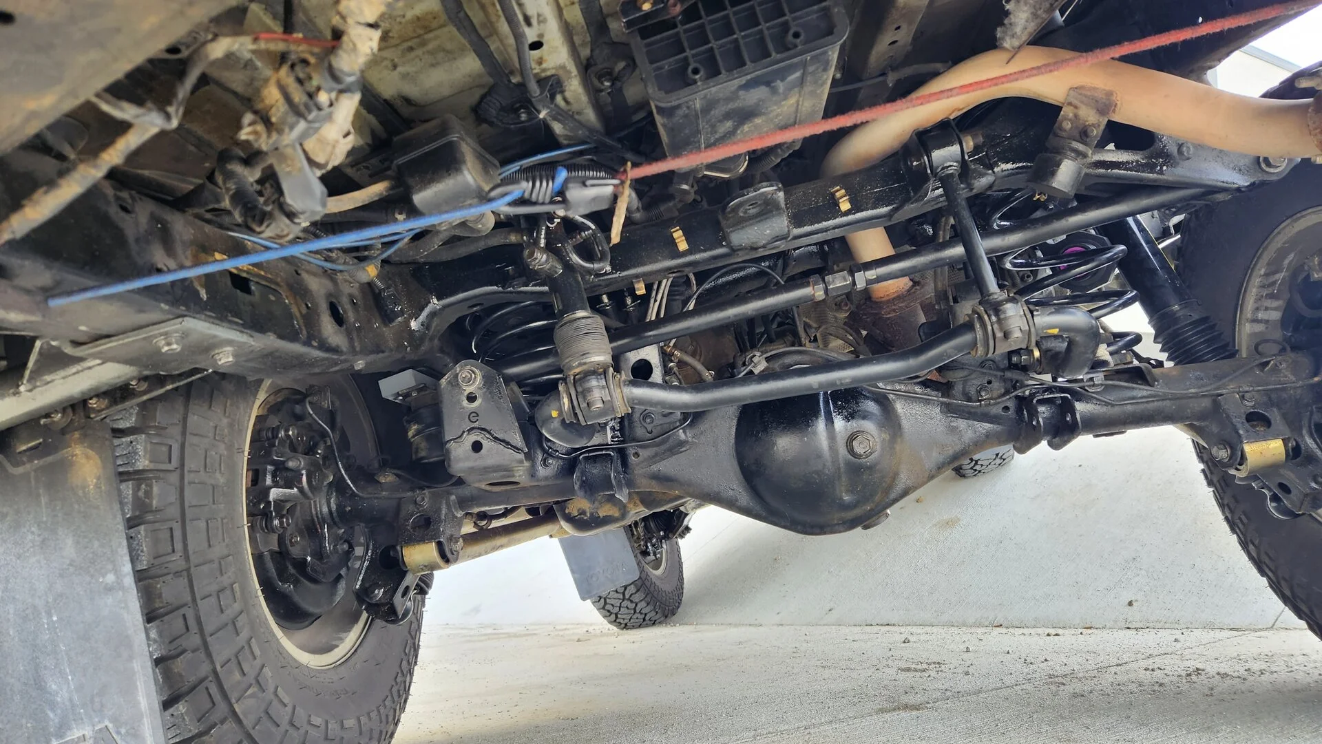

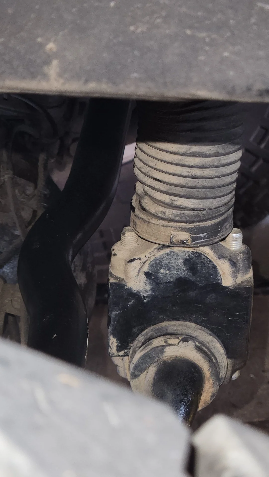

The Green line is what think would be the safe KDSS travel limit. At max articulation longer shocks would be fine, but straight up and down is when the panhard bar would collide with KDSS bar. Hit it hard and the ram might get damaged.

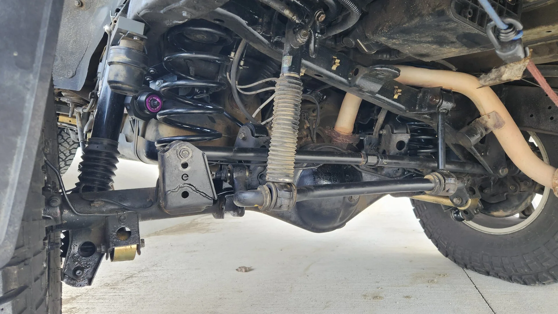

End up relocating the KDSS up and got rid of the KDSS spacer. Which give another advantage of raising KDSS out of harms way too.
Ran out of ramp to test max flex. Still have plenty of clearance between KDSS and Panhard bar. Shock still have travel left
Finally found some ramp at industrial complex to fully test it. So far it was a success. I might even go back to OEM panhard and sell Ironman KDSS Panhard bar.
The KDSS interference happens at full straight up and down travel and not during articulation.
KDSS ram fully extended
KDSS ram fully compressed.
Never mind the bungee cord. That was left over for the DIY Aux tank that was started but still haven't got finished yet🤭

You are using a different stock rear bumpstop than I had on my GX470. You have like a 4Runner smaller bumpstop and that’s why you ended up needing a spacer.

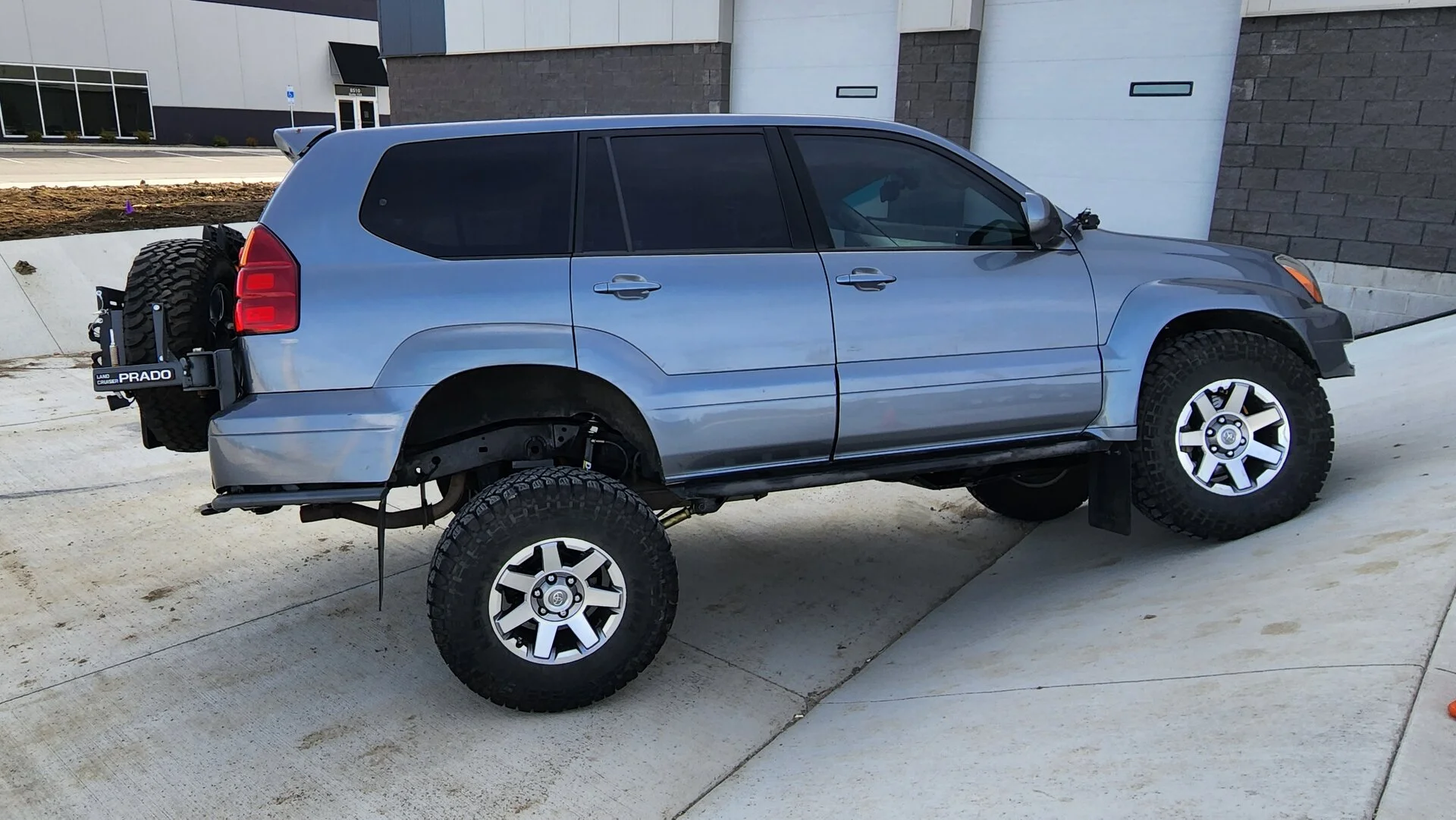

Got it on the bumpstop. As long you measure it right to prevent your wheel from rubbing the top of the wheel well or preventing the shock from being the bumpstop…then any bumpstop works. You won’t be hitting the rear bumpstop that often anyways.
And I’ve been wondering about the 701Vs but they require too much weight to hold at 2” which is my preferred rear riding height (23” hub to fender).
My 675Vs with a 3/4” and 3/8” spacers are too soft to hold at 2” with my gear fully loaded but work great when I only have half my gear in there.
Anyways, thanks for the responses. It’s been helping me geek out over the right components for extended rear travel at 23” hub to fender.

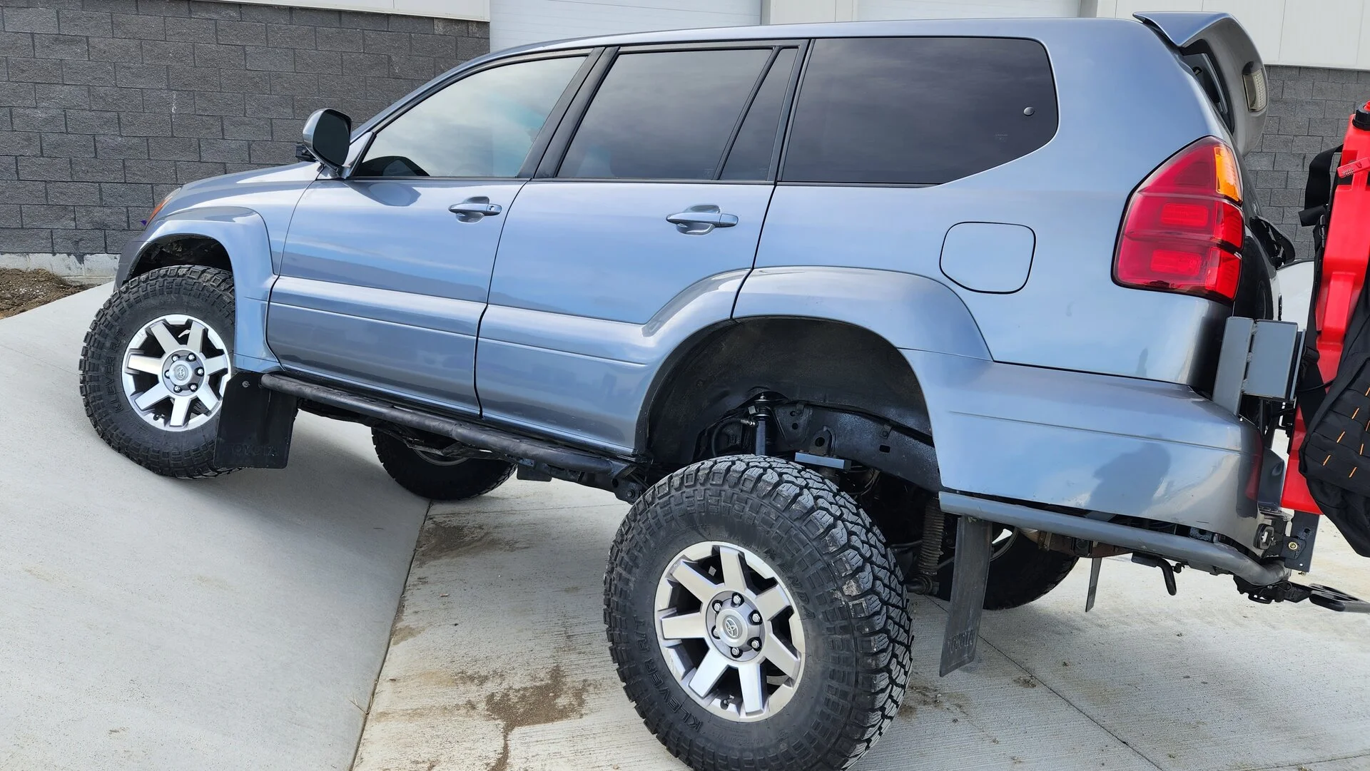

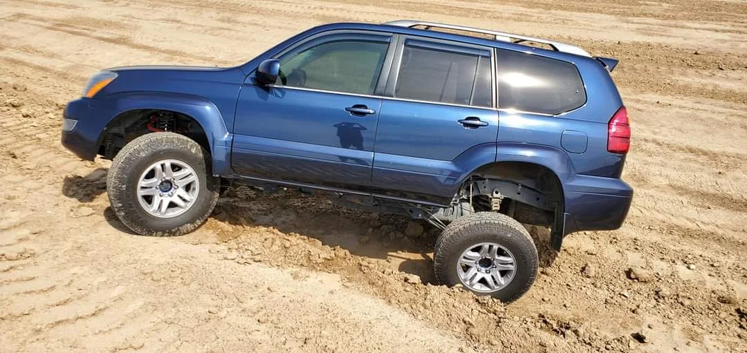

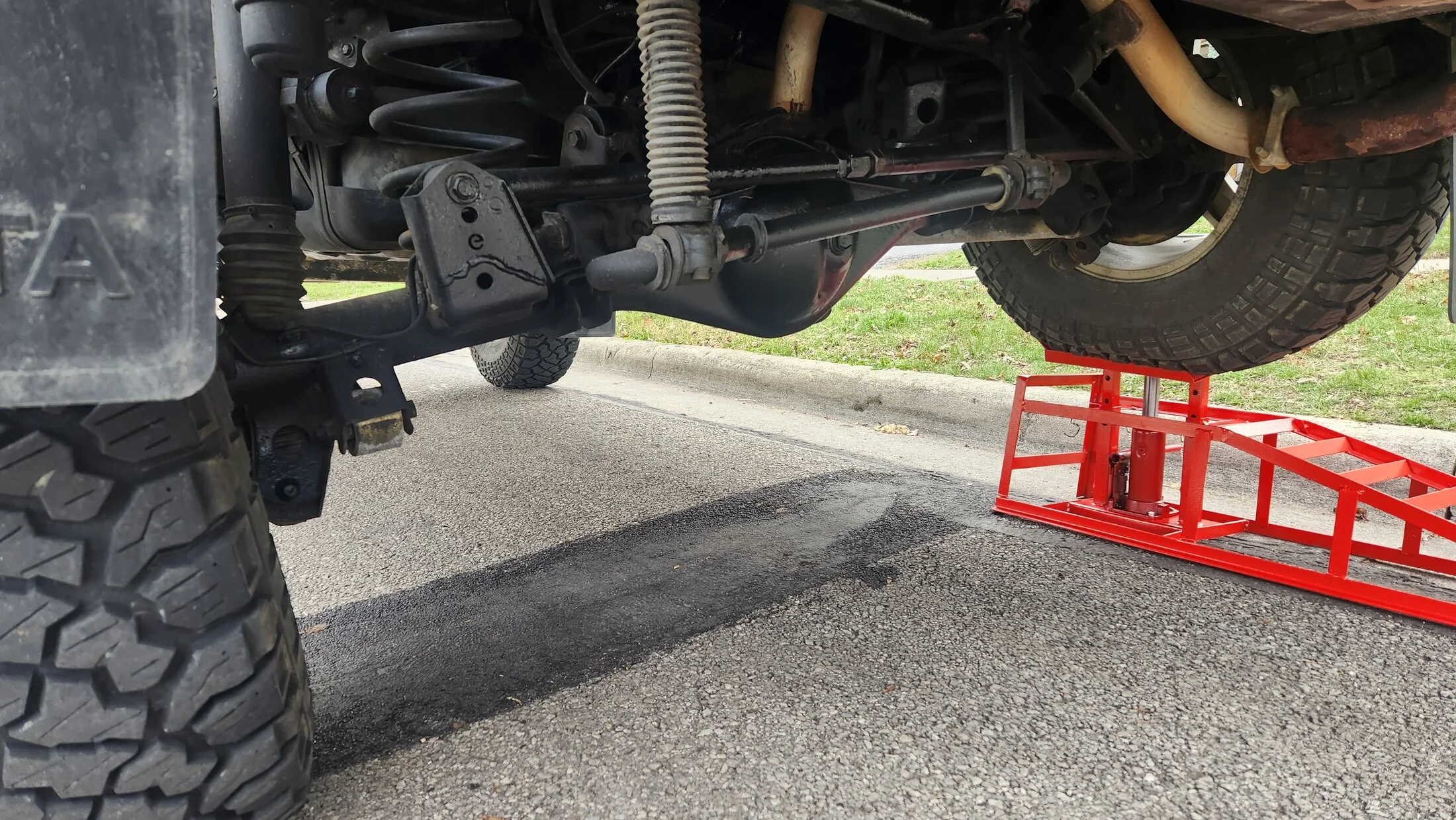

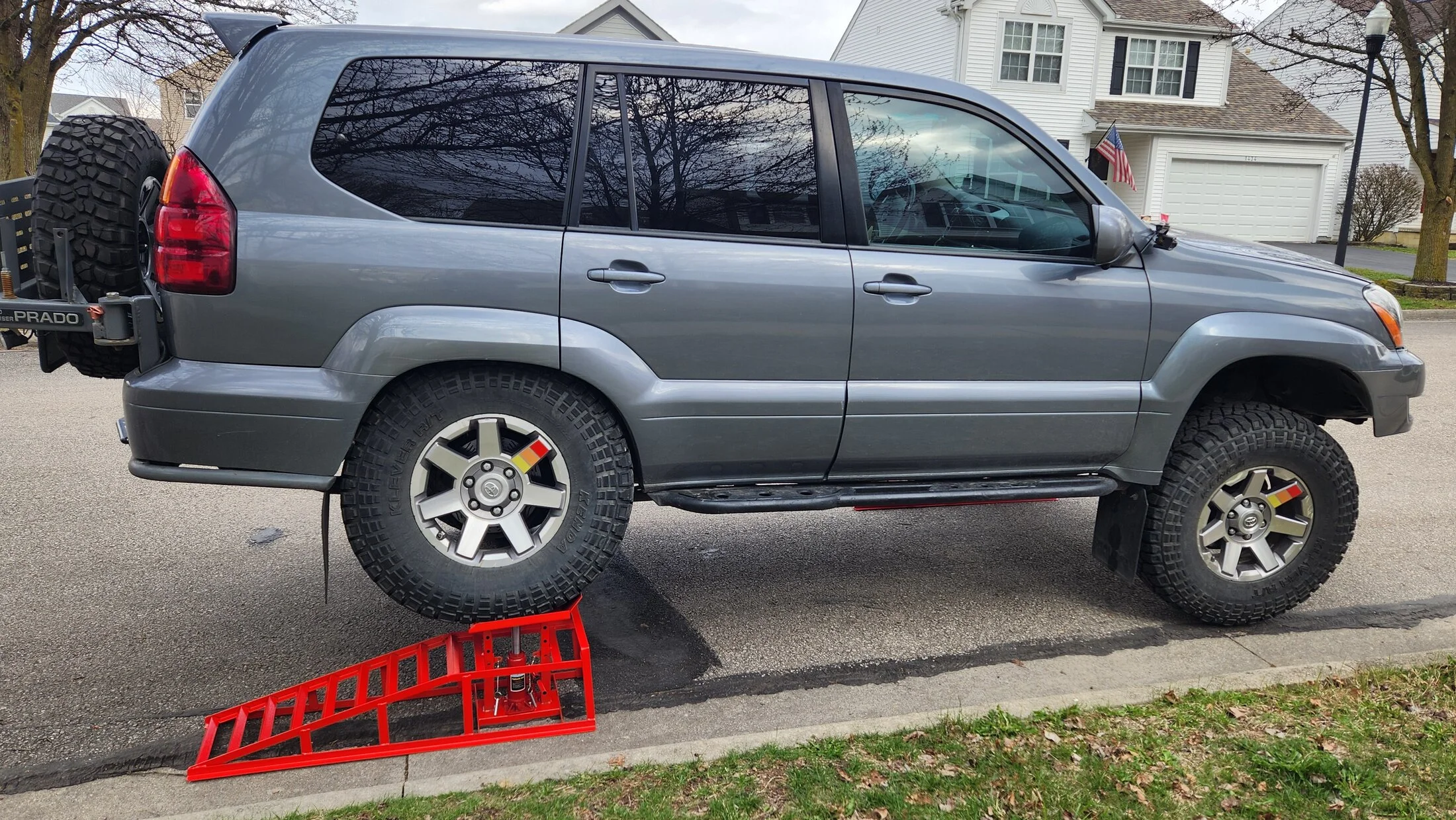

Testing this ramp and it is not recommended for Cross Travel Index testing. Too flimsy for side load.
Total 30" and none of the wheels lift off the ground. Not bad for 10" travel rear shocks.

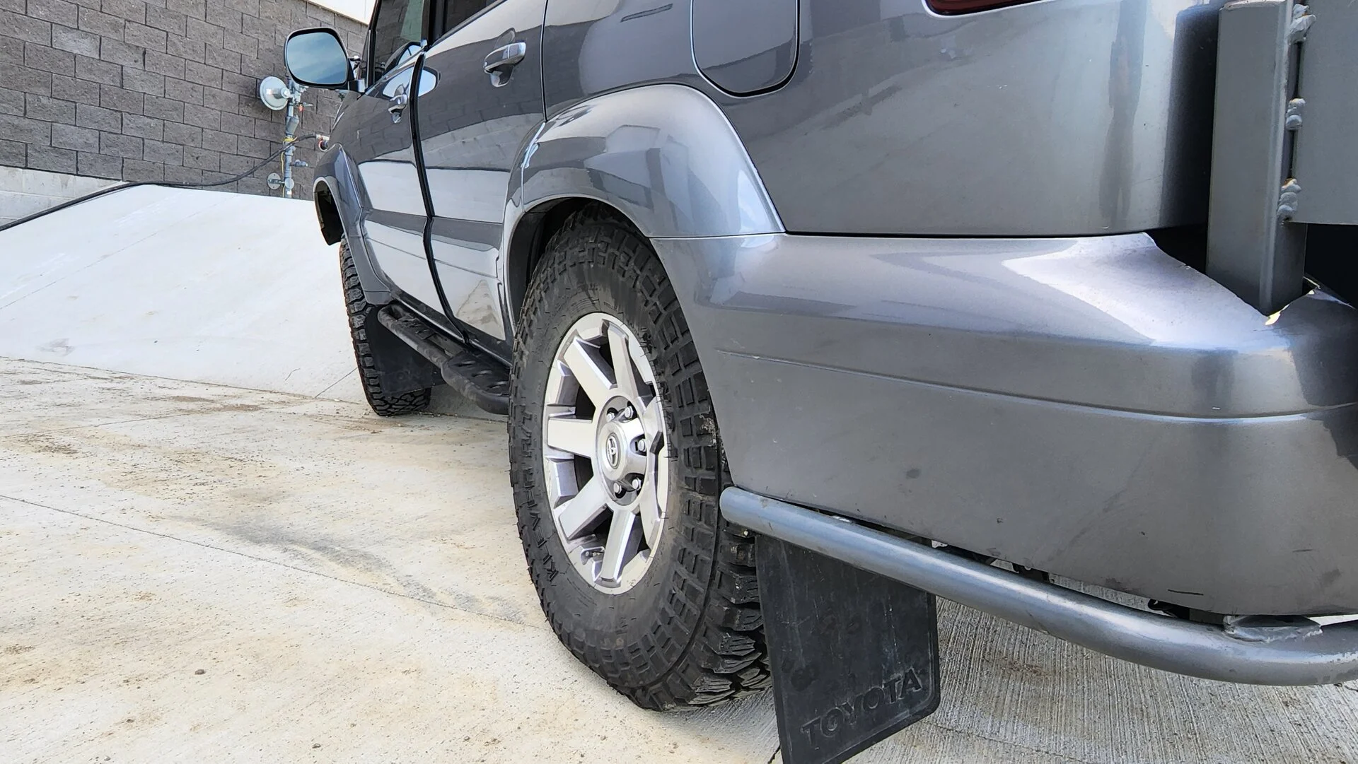

Massive improvement on trails without the headache of driveshaft rubbing upper link hitting fuel tank that is common issue with 12" travel shocks. Plus I have 1" more up travel.
OEM twig upper link still have plenty of clearance and not rubbing the fuel tank.
Passenger side KDSS link and panhard bar is really close.
