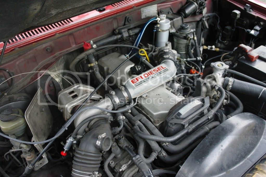

Also, here is my engine bay. The intercooler core will sit between the battery and fuel filter. Charge piping will run across the top of the engine.

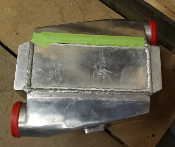

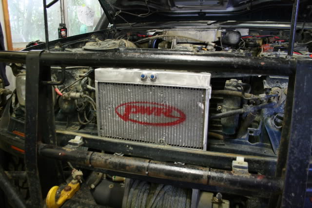

I am doing the same but with one of these.
And one of these.
