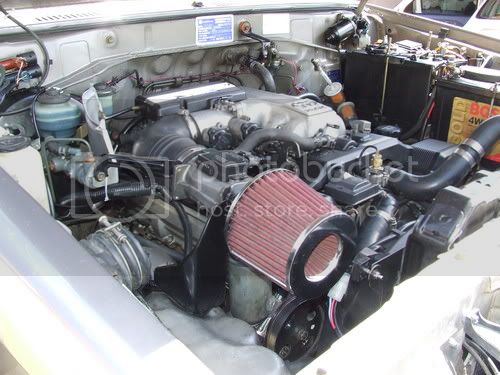

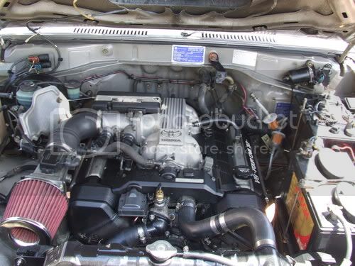

Is yours manual or auto transmission? If auto, there are many Toyota engines that can be used. The 1UZFE 4.0l V8 from LS400 is probably the most popular gas engine that people put into the Prado (many in New Zealand). 22RE would be really under powered. 5VZFE (3.4l you mentioned) would be decent. I think mechanically all these are pretty *easy* to put in. It's the electrical that will be challenging...
Here is how the 1UZ looks in a Prado (good):

That'll be the challenge no matter what engine you swap in. However, many of the swappable engines are connected to A34X transmissions as well. So I don't see why it is not possible to have the new ECU control your Prado A343F transmission. For example, the LS400 uses the A341E transmission. Basically the same as the A343F minus the 4wd stuff. *Just* a matter of adapting the wiring.
