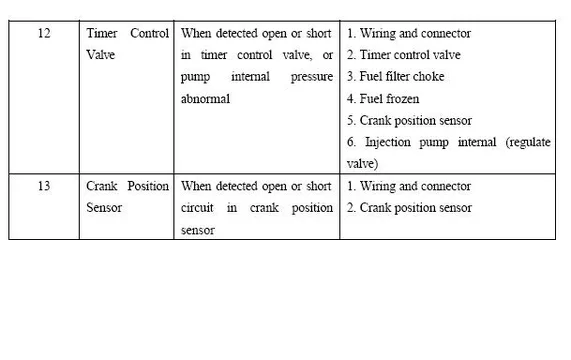

still have code twelve, PLEEEAAASE help. i have changed fuel filter, changed crank position sensor, and checked for continuity in all wires from crank sensor and timer control valve to the ecu, everything seems fine. injector pump is brand new , less than 6000k on it. i reset ecu and light stays out for about 5 minutes then comes back on. i have no power, there are 2 other trucks in town and the can do 60k at the bottom of the hill and be doing 90k at the top. i do 90k at the bottom and 60k at the top. i don't know what else to do. :bang:

i found out that the previous owner sold me this rig over the whole code 12 thing. he did put in a brand new injector pump. therefore it shouldn't be pump related, tcv etc. i have checked everything else on the code 12 list. i'm at a lost what to do next. how do i check the timing, for the belt jumping a tooth? i can't see this being the problem, as the previous owner had the code, then change the pump but code remains. i would hope the timing wouldn't be wrong with both pumps, and it was the toyota dealer that changed the pump. is there another pump in the tank that could be screwed, or should i drop the tank, clean it and change the line to the filter. if it is blocked would the internal pump pressure be wrong, thus triggering a code 12. HELP ME PLEASE the previous owner is on the forum as killerv asking many of the same questions i have asked

2.4LTE Fault Codes
We can get it sorted out.
