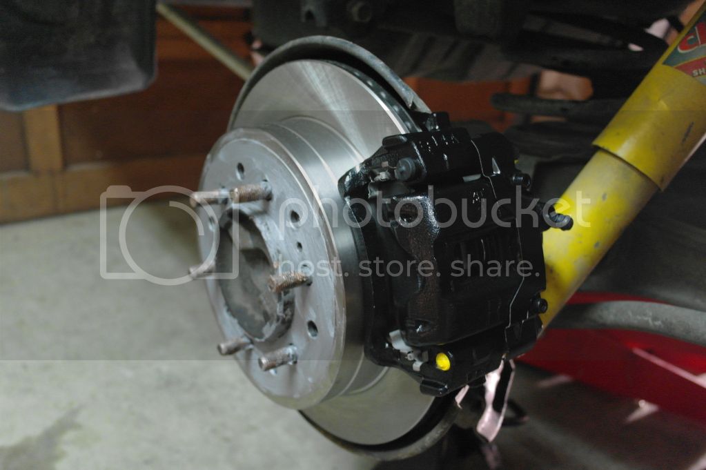

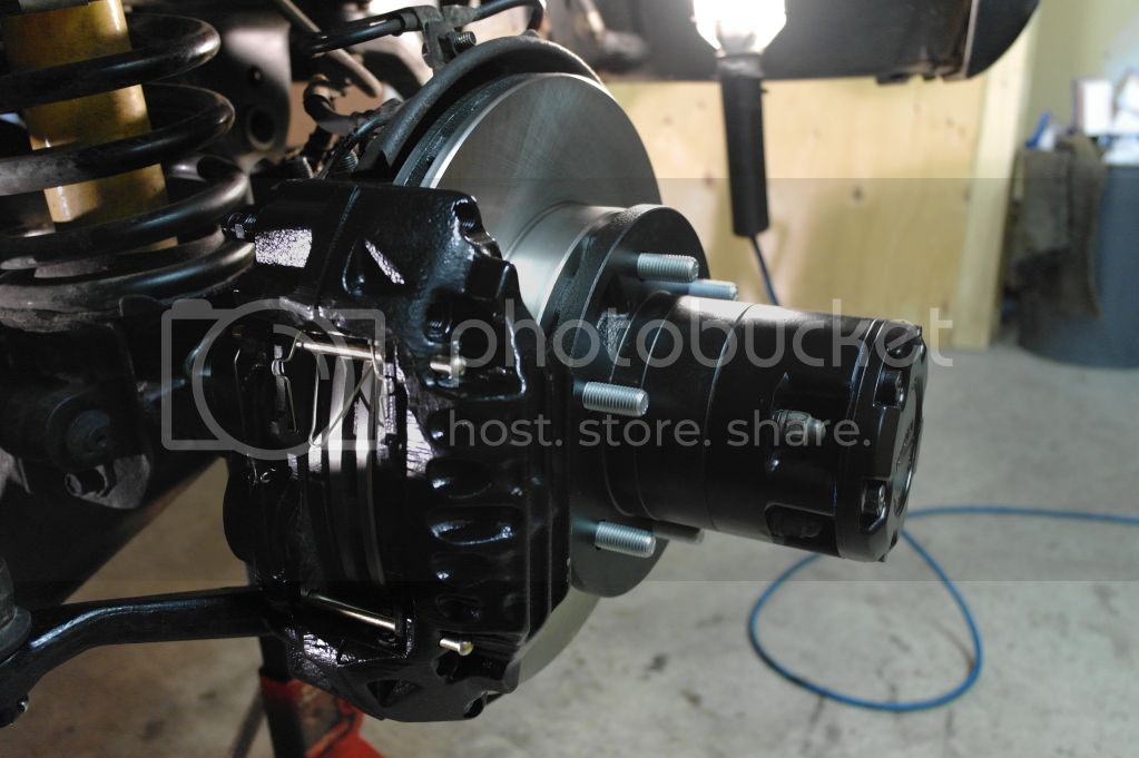

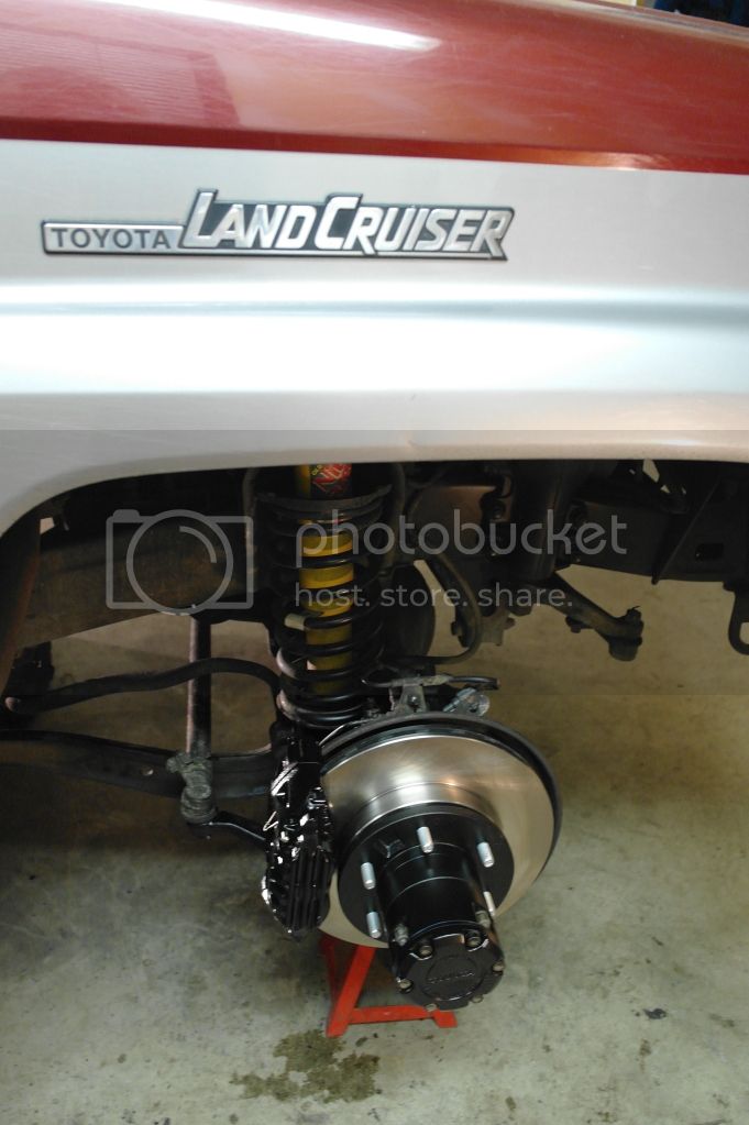

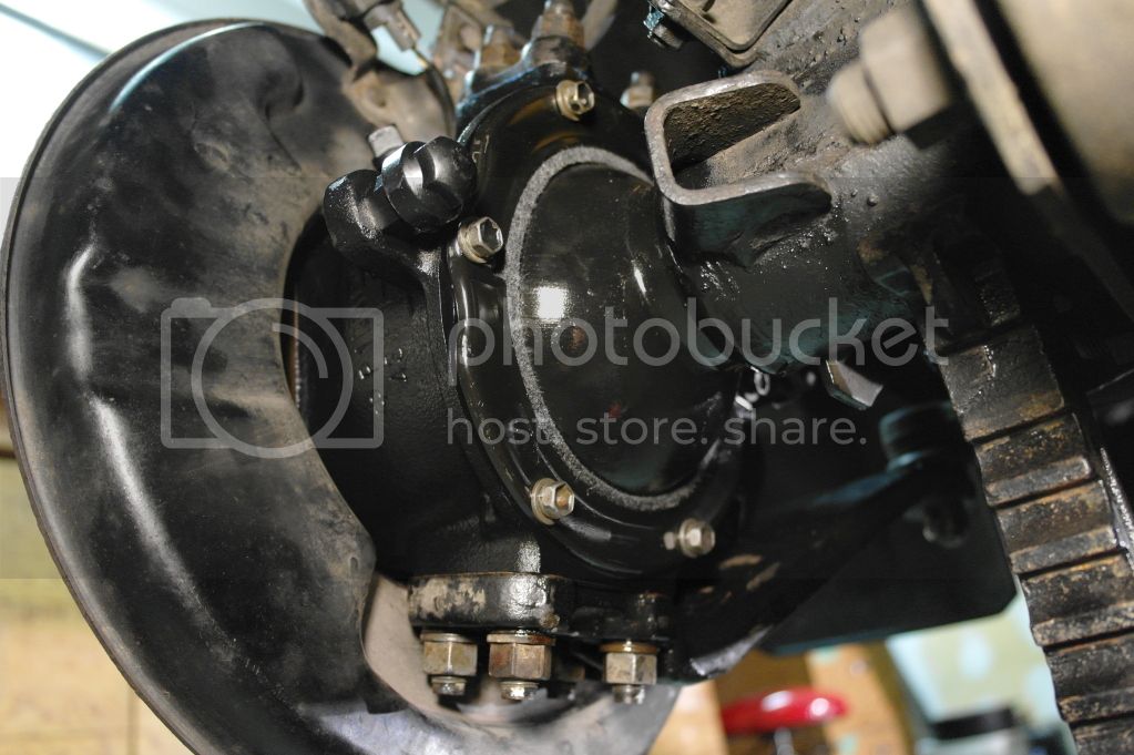

Unfortunetely I did not take any pictures while doing the work, but I do have some pictures after the job was done.
You'll noticed in the pictures the front caliper pins are a little long. They are for a slightly bigger caliper (all I could get at the time); I'll put the proper pins in when I get a chance.

- A very nice looking job there!
- the W-shaped spring that goes over the brake pin should be on the leading edge of the brake pad, not the trailing edge. You can also run them on both ends, but if using one, it should for sure be on the leading edge.
- silicone sealer acts as a lubricant, and things like hub gaskets, king pins etc. should be assembled clean and dry and not have things like silicone sealer or grease used at all. I will even go so far as to say that the metal surfaces should not be painted where the parts meet at these points - which is in sticking with my "clean and dry" theme.
- Don't put Anti-Seize on the rotor or hub face where the wheel contacts this area. Bolts, wheel studs etc. only hold things in place due to friction between surfaces and these mating surfaces should not be lubricated with anything as it reduces that friction substantially and you are far more likely to have issues. A small amount of anti-seize can be applied to the very edge of the lip where the rotor meets the axle shaft hub to reduce rusting and sticking, but painting it all over the parts where the wheel mounting surface meets the rotor and where the rotor meets the axle shaft is really not a good idea (looking at the third photo showing the rear disc rotor) - "clean and dry" for these thing too.
Good to know; thanks! I think this was part of the job that got done midnight on a Friday... I'll swap 'em around.
I should clarify what I did here, as I was not very clear above. I applied a tiny bit of silicone sealer around the bolt studs between the knuckle arm and the knuckle body as I assembled it. The silicone did not contact the part of the knuckle arm that slides through the inner race of the kingpin bearing. So the silicone is no where near the bearing/grease it's self. The idea was to keep water from seeping through from the knuckle arm stud holes to the inner race of the bearing.
I was certainly way too liberal with my application there. Thanks for the heads up. I was trying to prevent the wheel from rusting to the disk. I actually figured someone would probably comment on it, and thought of wiping it off before the picture, haha.
