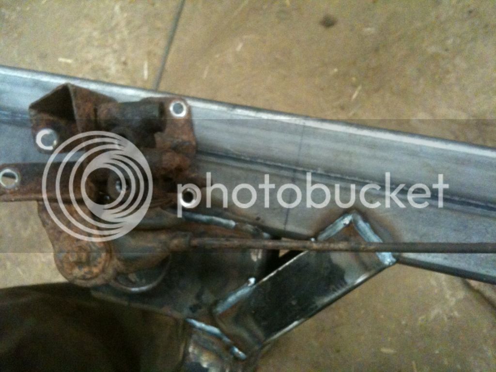

so i have a Load Sensitive Proportioning Valve,
Wilwood have an adjustable proportioning valve which sounds good but has 5 ports? can/do you just block port off to replace the Toyota LSPV?
i think theres 3 ports on my LSPV, two from the front and one to the back axle?
heres what i have at the moment....
another thing to add into the equation is that i have +2" coil springs which would affect the LSPV if i used one.
