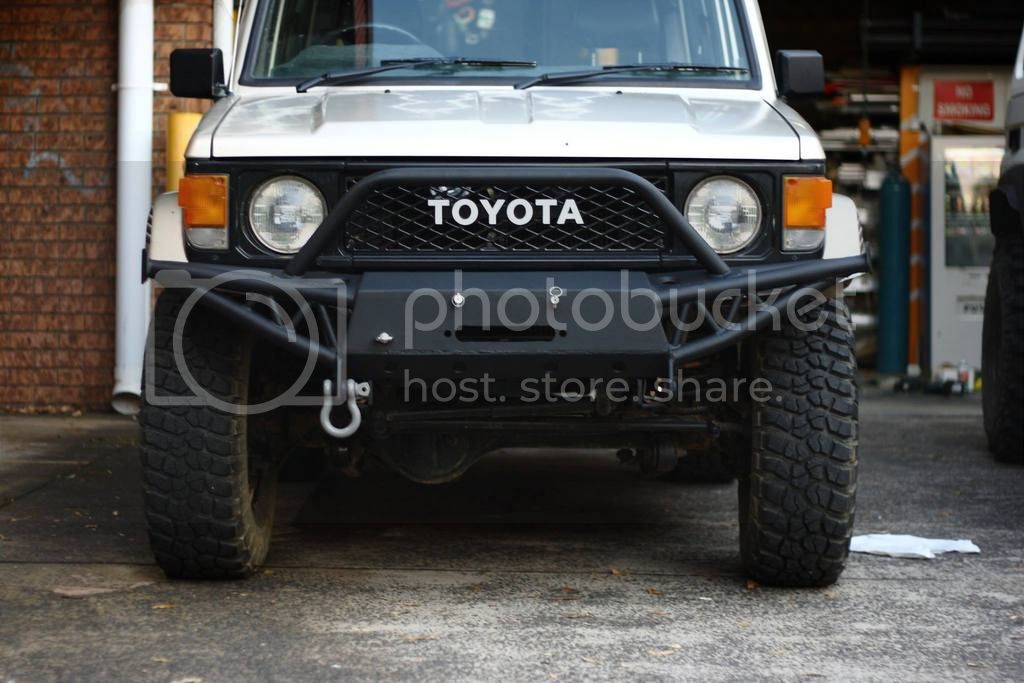

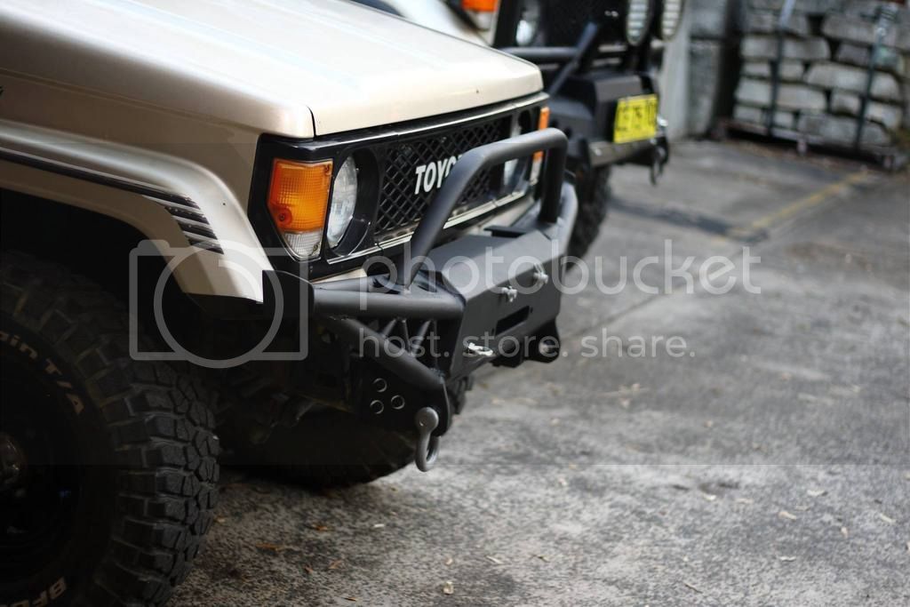

After purchasing a winch I was tossing up whether to use the TJM alloy bar and just stick a winch cradle in it or buy a completely new bar. I went for the latter and after getting in contact with "Alex Gee" a new bar was designed and made, all custom. Im extremely happy with his work, improved the approach angle greatly (after a small amount of trimming of the chassis), and after last weekend I can say it really is up to the task after taking quite a beating.

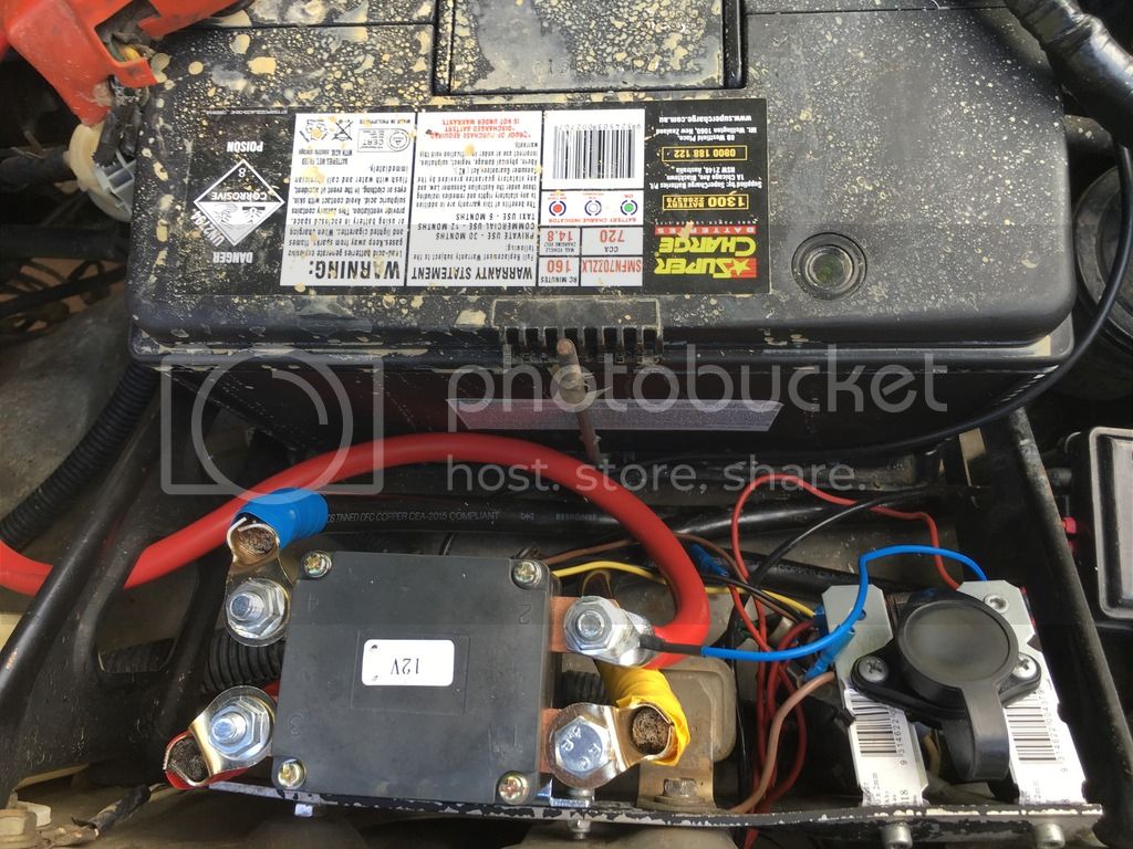

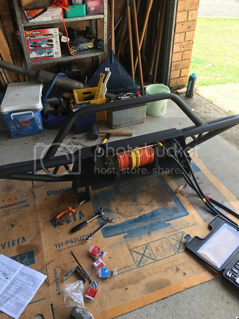

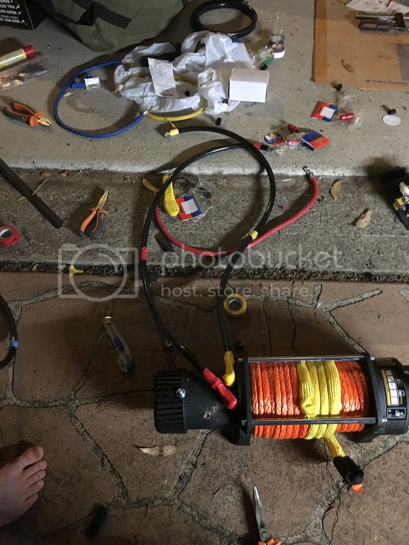

Now that ive got the winch bar I decided that installing the winch was probably a good idea.
Relocated the solenoid to up inside the engine bay, to protect it a bit, this meant making up some longer wires to reach to where I could mount them.
Fortunately I have a cousin working at Jaycar electronics who could look after me, getting all the bits I needed.
Had the winch bar make up around the winch, so it fitted very snuggly in there.
To get the solenoid to fit I had to take it out of its casing, which wasn't doing anything in the way of protecting it from the weather anyway. This is how its mounted at the moment, pretty quick fix, and the connections were insulated after this photo.
May get moved around and when I do an engine swap eventually.
Took it down the street, it all works, which is always a bonus!
