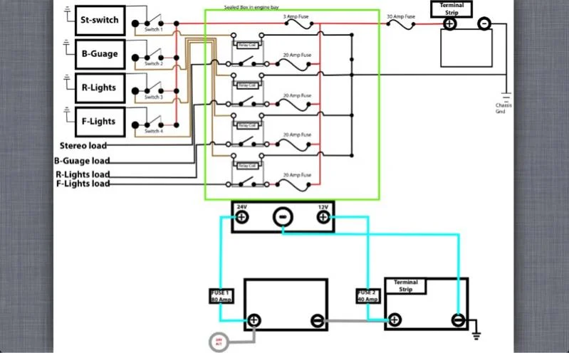

Drew a diagram and would appreciate some feed back.

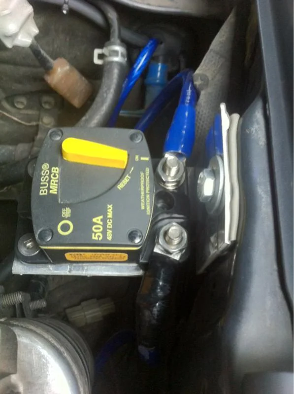

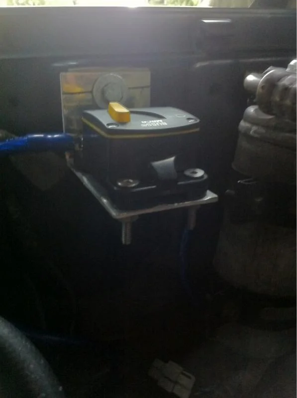

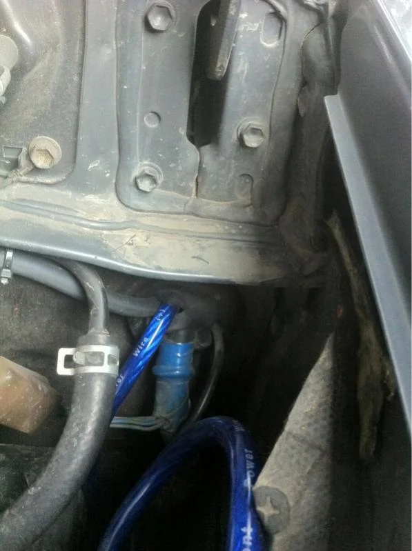

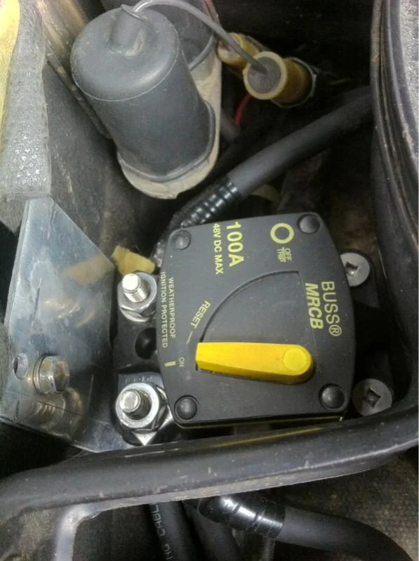

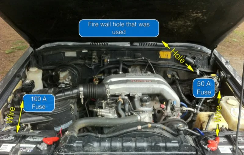

Pics on what and where the fuses were mounted in the engine bay. A 4 gauge cable was used and ran through the firewall on the passenger side all the way to the back. The equalizer was mounted on front of the stock jack and tools area. I was able to utilize some existing holes and grounded the equalizer off on also a existing hole on the body behind the panel. Would take a pic but documenting this was an after thought and my truck is now full of tools in the back.
Fuses were found at polar battery. Marine grade and a better buy then a one time only fuse. These pop and Wallah re reset them. If they ever pop they will have paid them selves off. The equalizer manual calls for an 80 and 40 fuse but figured those 100 and 50 would be ok.
Also thought I might add why the fuses are mounted where they are.
The 100 is where it is because I was able to move a solenoid back into a empty space where a stock hole with threads was empty. Also the fuse has an aluminum bracket mounted into another stock hole with thread with a stainless bolt. The stock bolt for the solenoid was not long enough for the aluminum bracket and washer.
Pretty much the same for the 50. It's mounted above where the hole is for the stock antenna also into a stock hole with threads.
Not ingenious i know. Whole process was very simple. Just thought that maybe some would find a benefit or elaborate into something cooler.
Pics of where the hole is for the firewall and another pic of the 50 mounted above the antenna hole.
Very nice setup! About your diagramme, most of the circuits there are already pre-existing right? Or were you rewiring it all? Where did you get that unit and if you don't mind me asking, how much?

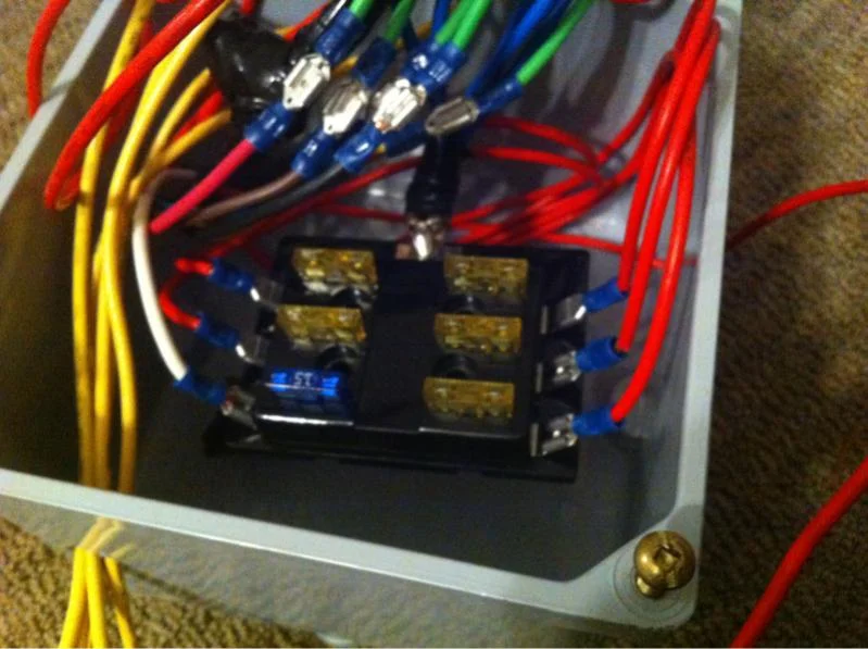

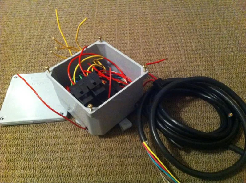

If your referring to the "dbox" everything was bought in between the power source and the source (wire, relays...). So I wast rewiring anything.
I have finished the dbox itself, now working on a good place to mount it in the engine bay, and building a bigger center console for the switches, vhf and cup holders.

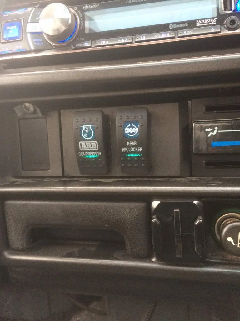

Update the arb switches went into my dash as the console wasn't finished.

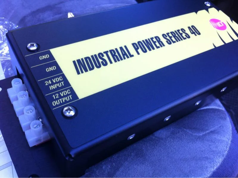

Currently in haven't put the converter to real use beside the stereo.
There's been some confusing (to me) parts. First I'm not really sure what to do from here. The battery equalizer seems over kill now with the converter in place.
Todo: clear up accessories and run them from appropriate locations (either converter or accessory box in engine bay).

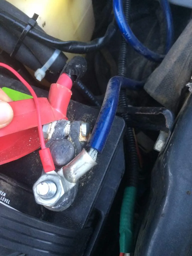

Then the arb compressor gets hooked up. Within a month the plus side terminal gets a reaction
Corrosion. I noticed this when i used the compressor to pump up a few tires on a struggling pt cruiser. Used the the truck in the am. Let it run at high rpm for a while to recharge the battery. All good. Off the truck goes and me back inside.
7 hrs later I'm out to the truck and it's dead. No click no nothing.
Batteries register at 6.4v and 6.5v. Both within .1 of each other??
Looked and the compressor switch was in the off position. Not full retard.

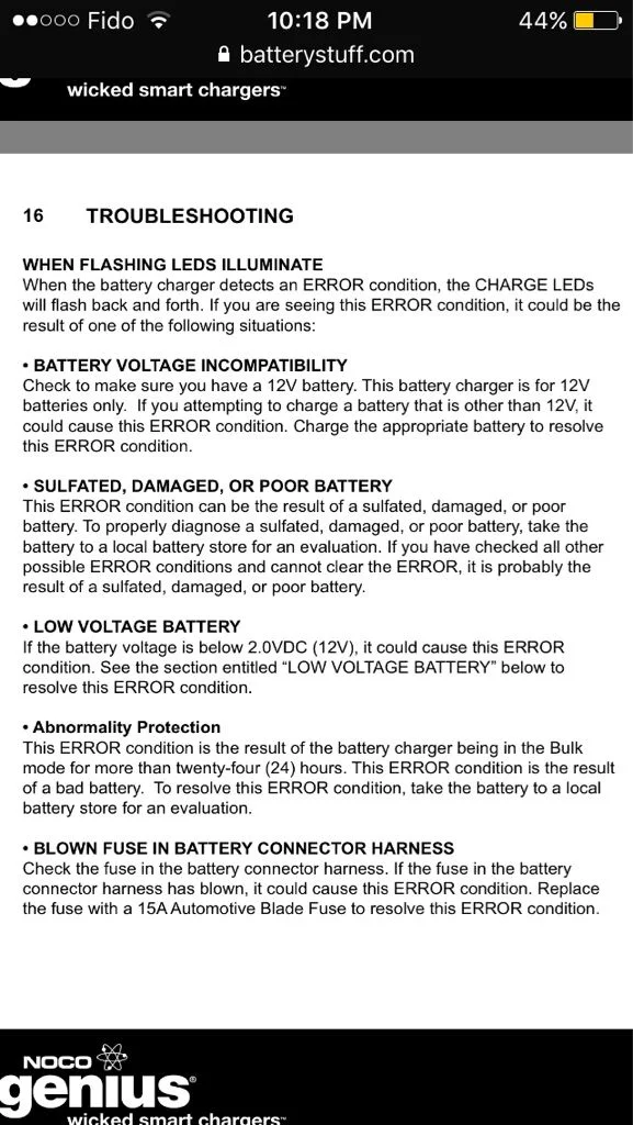

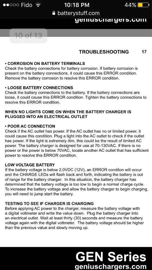

So I hook up my battery charger. NOCO Genius marine grade 12-24v 20a charger. Both are indicated as red.
This morning after 8hrs of charging
The high battery is still indicated as red and the low battery (with corrosion in the + side) indicates a warning.
Now one thing that doesn't make sense here is that both batteries are still registering at the same v as before charging them.
Does this charger have enough Amps (10a) each to charge the system? I have used it before in the same manner with great results. So I'm lead to believe from previous experience the answer is yes.
