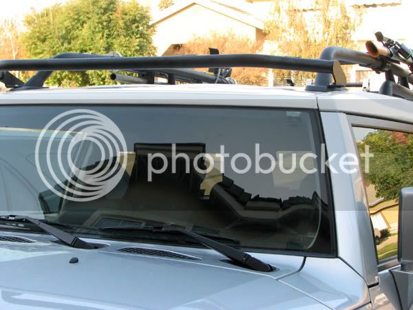

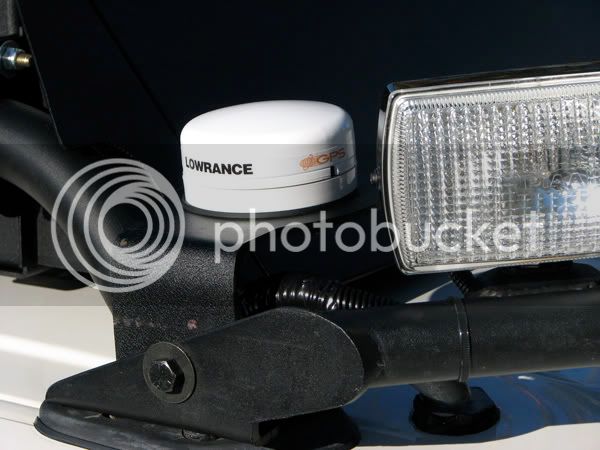

N-Fab also makes one for about $250. Uses same holes as the front roof rack mounts and they provide longer bolts to go thru the light bar bracket and then back thru the roof rack mount into the roof. Not too many pics on their website though. Holds 5 lights, with three positions forward and 2 "wing" lights aimed off to the sides.
Here's a pic from another member. Ignore the bracket that his Lowrance receiver is mounted to.
I like how it moves the lights closer to the edge of the roof line.
